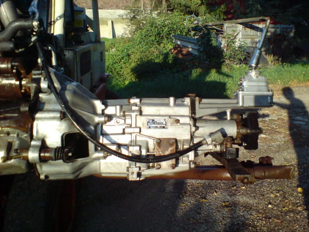

Like the one I found years ago :
But mine had gears : 1 = 2,85 / 2 = 1,8 / 3 = 1,36 / 4 = 1,14 / 5 = 1,0 / R = 2,82

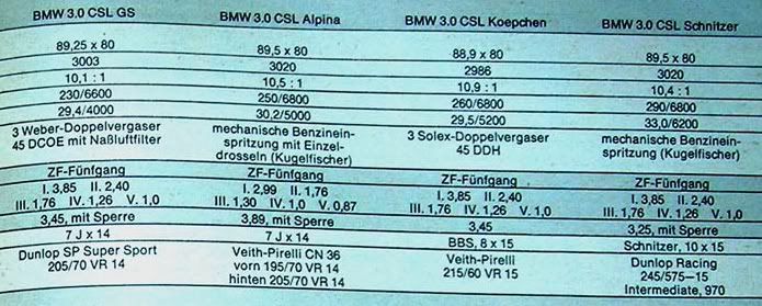

But : If you want to have a E9 race car, thats the perfect gearbox for it. 1st gear = 2,3 !
And all tuning E9 had the 5-speed ZF, Alpina, GS, Koepchen and Schnitzer :
This gearbox is good enough for 300hp and more............
TheZF is only OK for race engines up to 3 liters.
Larger engines have too much torque for the ZF and they require the Getrag 265.
During 1973 all the race teams switched to Getrag as they started racing 3.3 and 3.5 liters.
In the other hand the ZF is the only 5 speed gearbox homologated for the 2800cs Gr2 (1970-72).

Not that it makes all that much of a difference but the "road Alpina" gearbox refered to here had 3,87 in first (according to my ZF papers). The one from e-bay is the BMW version homologation track box as used by most competitors through 1972, before going to Getrag for the reasons mentionned by 2275XXX. Most ZF ratio combinations were available for various makes: for example, the 2,85-1,00 box refered here as Alpina race box was also mounted in the Opel Kadett GT/E, the european equivalent of the Chevrolet Chevette.

so I'm curious where would a 1st gear of 2.3 fall into the categorization of gear sets you described?
Thanks-Sal

The ZF has a plate as seen above. The ratios for the G265/5 are: 3.72, 2.40, 1.77, 1.26, 1.00.
As you can see, the box ratios as a whole are very close to the GS/Koepchen/Schnitzer ZF boxes, save for first gear.
