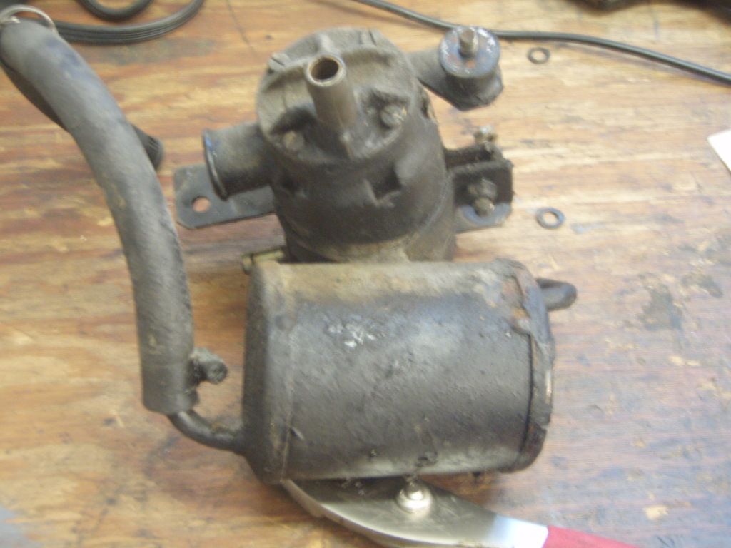

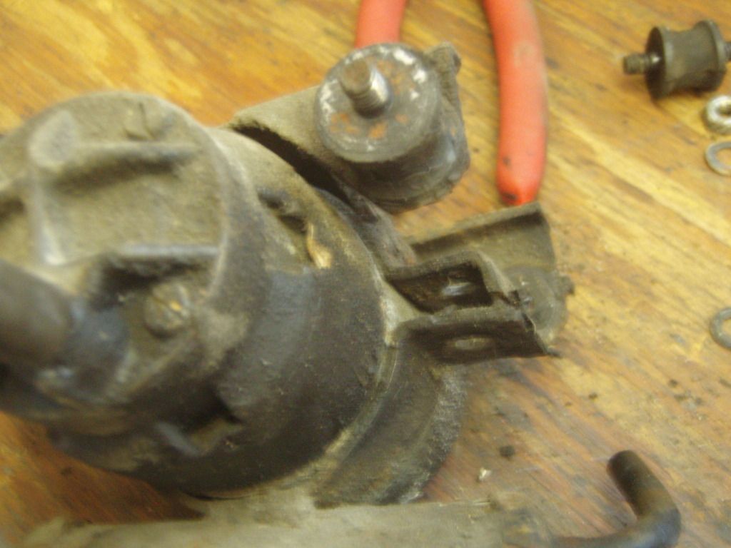

The pump and "expansion unit" are mounted with a three point rubber mount set up.
double ended rubber vibration mounts? Really?
So when you take off a nut and think you can now push the matching bolt thru to release the mount, it ain't happening.
I finally got enough of the nuts off to be able to release the pump/expansion tank off the bottom of the car.

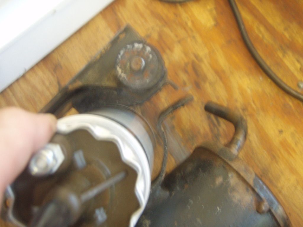

Here's the pump on the bench. You can see the rubber mount in the upper right
Here's a shot of the clamp
So even though you now have the assembly out of the car, you still can't take it apart. You have to remove the fuel fitting and, even then, there is a pin you have to get by to remove the pump from the assembly bracket. You can see the pin between the fuel fitting and the plug, right next to the bracket. You can see one of the double ended rubber mounts at the upper left.

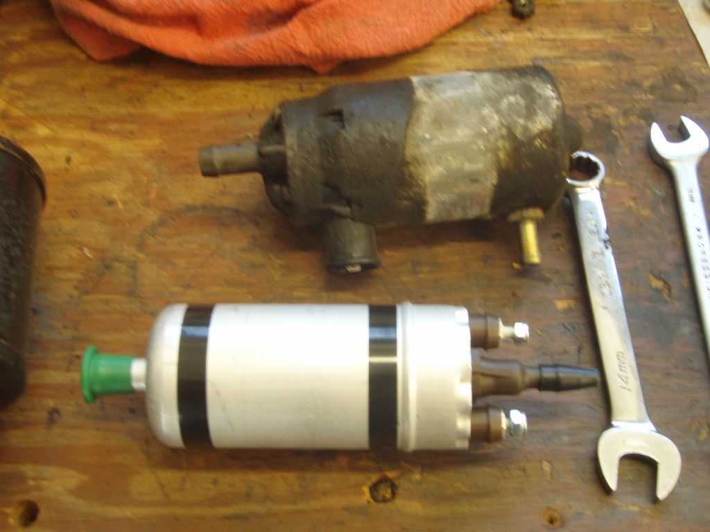

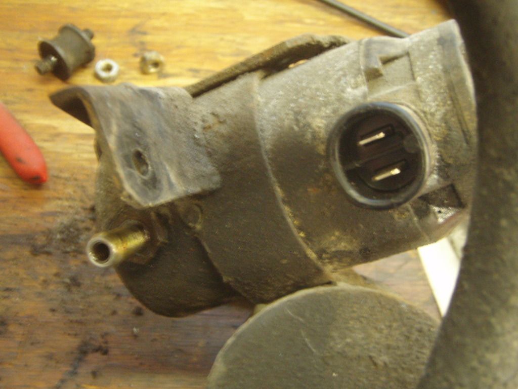

Got a new (superceded) pump from the dealer. But the nozzles are slightly different and so is the electrical connection. Both can be overcome. But the diameter is significantly smaller so I'd have to shim it with something like a piece of rubber.
Differences in diameter

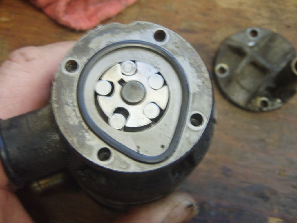

In case you wondered, here's what it looks like with the top off. I think the fuel flows from the tank, thru the motor for cooling, then out to the engine (big suction, small discharge)

My next challenge is figuring out the polarity of the plug coming from the car. Both wires appear to be white but the wiring diagram seems to indicate one brown (ground?) and some other color. The new plug has a different wiring set up but I've made some pig tails that will with tdifferent ends that will work. So how can I figure out which is hot and which is ground? I've put a volt meter on both, turnend on the cat, heard the relay click, but no voltage on either plug.
