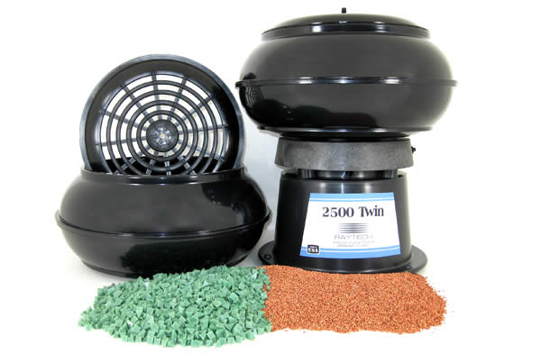

How would you clean any metal parts? Some that are exposed to the elements can be beyond help. Others, are only cosmetically challenged. With just a few fasteners, a wire brush or wheel and some solvent should be adequate. It may be easier when cleaning a lot of fasteners to use a parts tumbler or an electrolytic hot tank.
