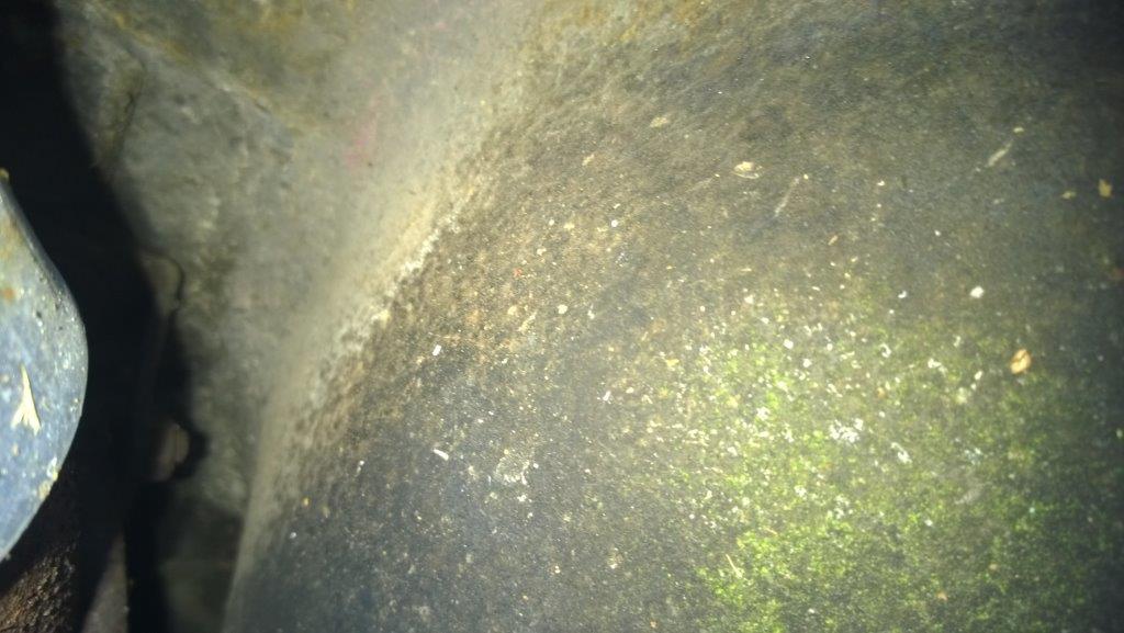

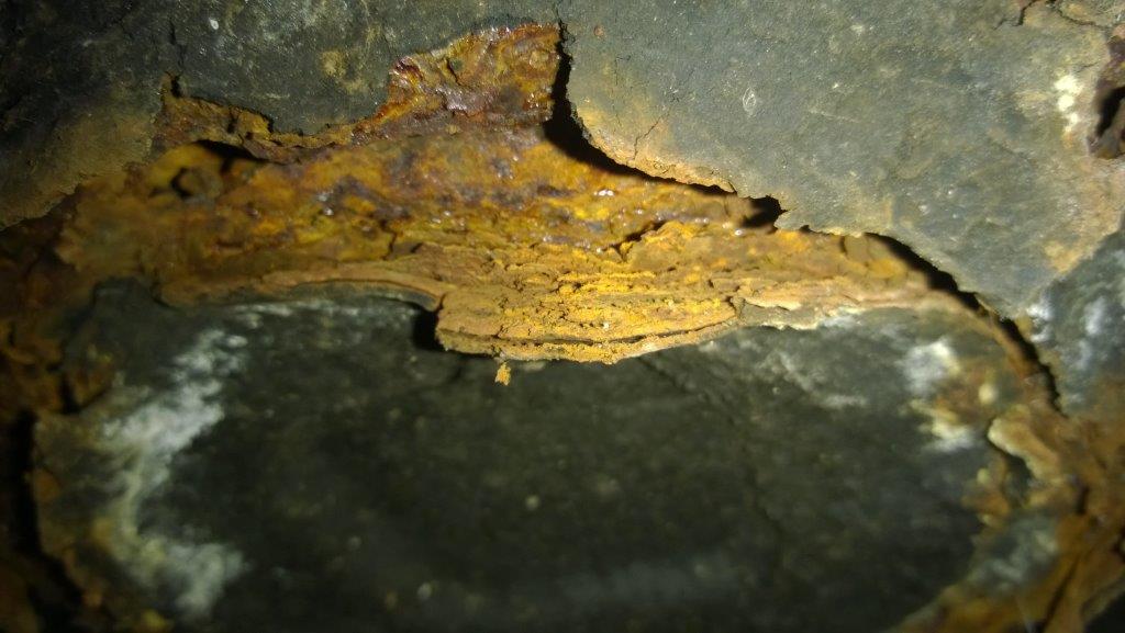

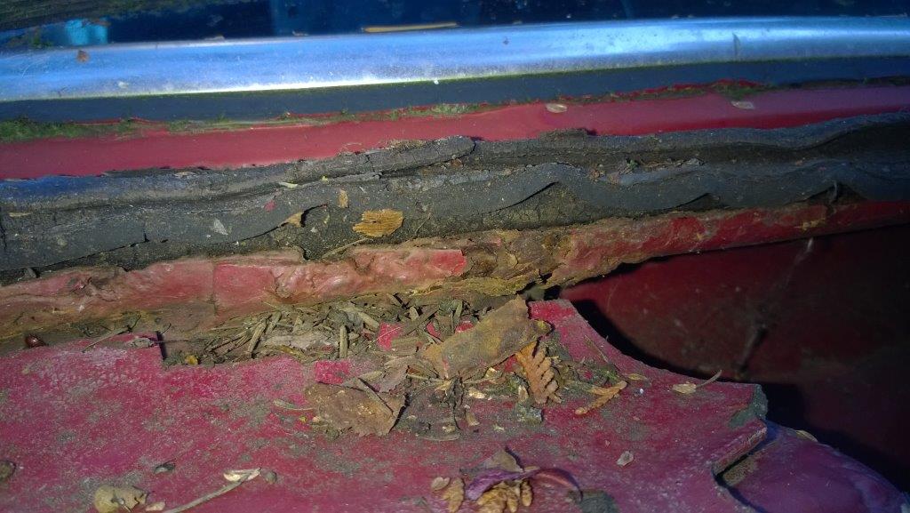

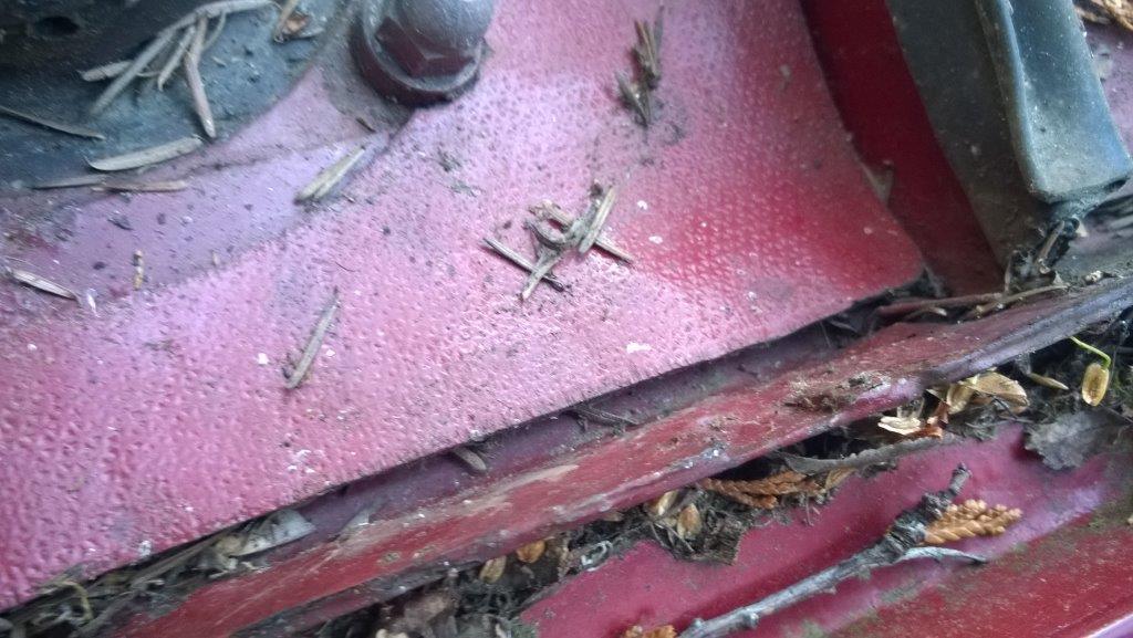

1. Wheel Wells:
Seem solid, plastic covering but no spongy feeling when pressed, no gaping holes.

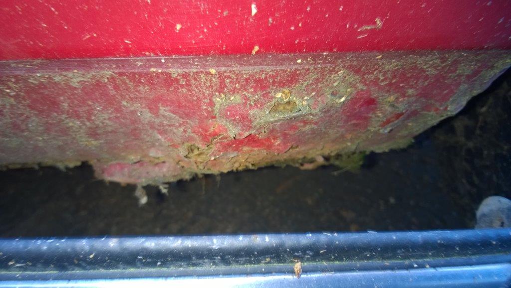

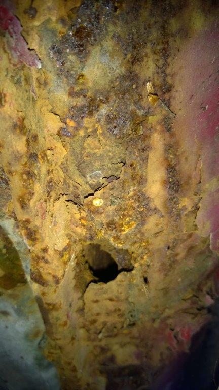

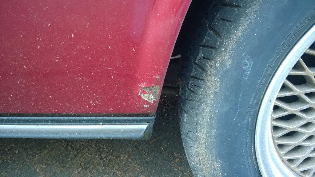

2. Rockers:
Center section seems solid, minor rot at the rear section, no holes. Holes and major flaking in the first 12". Only checked the driver's side.

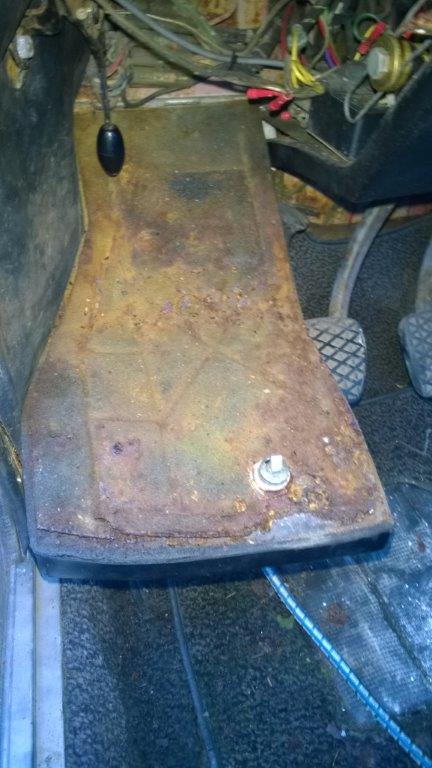

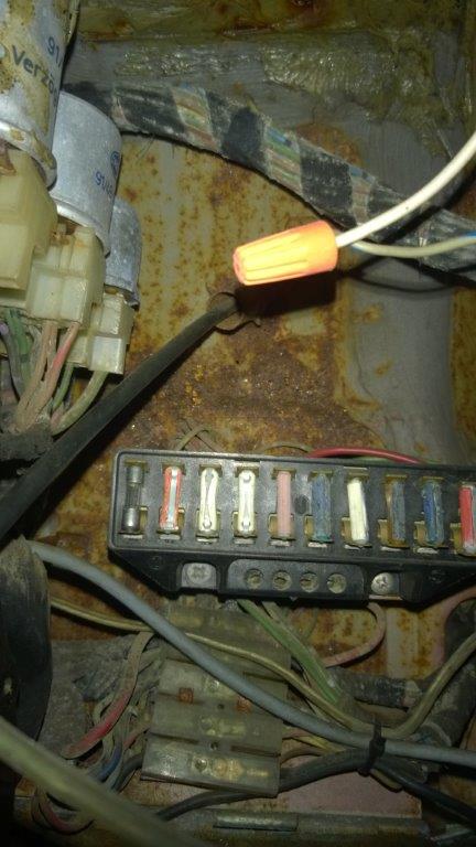

3. Floors:
Squishy floor pan plug on driver’s side. Major flaking, looks like I could punch through with ease. Passenger side looks good from the top side. Rear foot wells seem good.

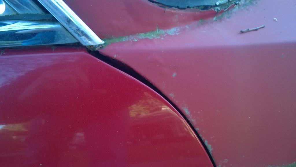

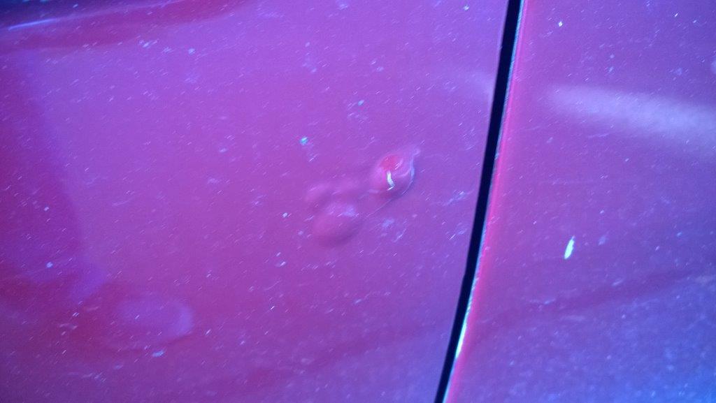

4: Fenders:
Front fenders look really good. No rust in visible from the hood. Front shock towers look good. Some bubbling behind the front tires in the scary zone. May be some body filler there, not quite sure.

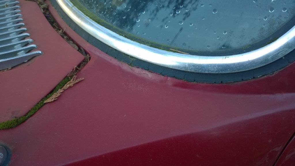

5: Window Frames:
Rear window frame looks sound. Front upper window frame looks sound. Passenger side lower window frame has some bubbling and flaking.

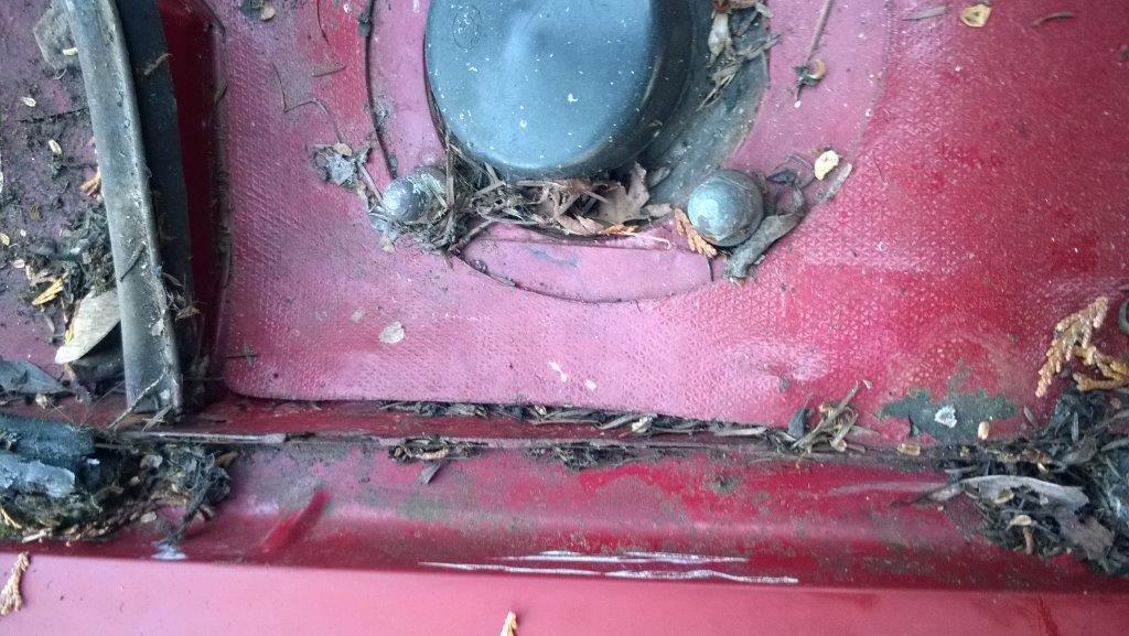

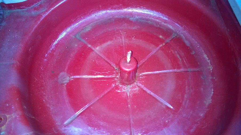

6: Spare Tire Well:
Best spot on the car!
7: Shock Towers:
Condition unknown. However, the back half of the car is in really good shape. I pressed around from inside the trunk and felt no soft sports, but didn't want to mess with the elephant skin. I attempted to snap a pic from the shock side, but I didn't see much. I'm pretty confident that they are in good shape.
8: Nose & Valance:
Looks good!

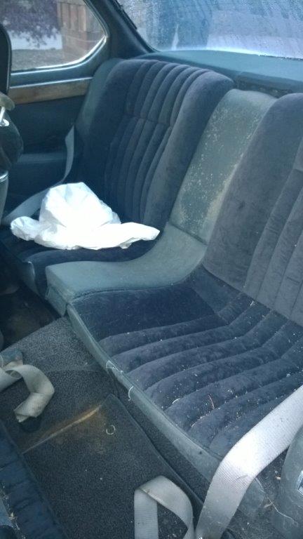

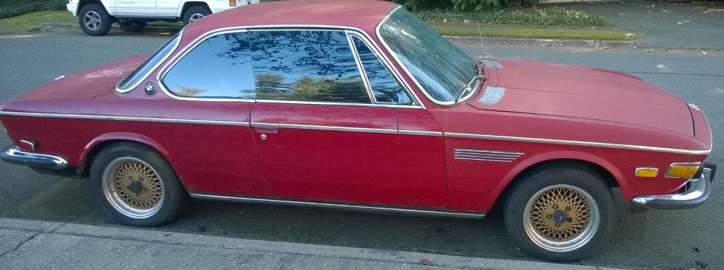

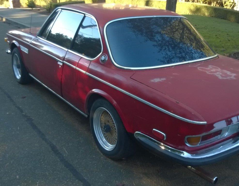

Other comments. The interior is poor. The seats are a black velour. Everything is intact, but parts are wet and there is definitely mildew present. Wood must be replaced. The dash is cracked. The radio is 80’s aftermarket.
The car is a four speed. The engine has been modified in some “stage II” way by a tuner in California. The owner drove it last year, but the gas is about six years old. I’m pretty confident that I can get it running.

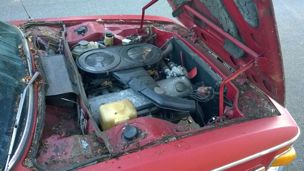

Lastly, there is a lot of debris in the engine compartment that may generate concern. There isn’t really any rust in the engine bay.
Not bad at 10 feet:

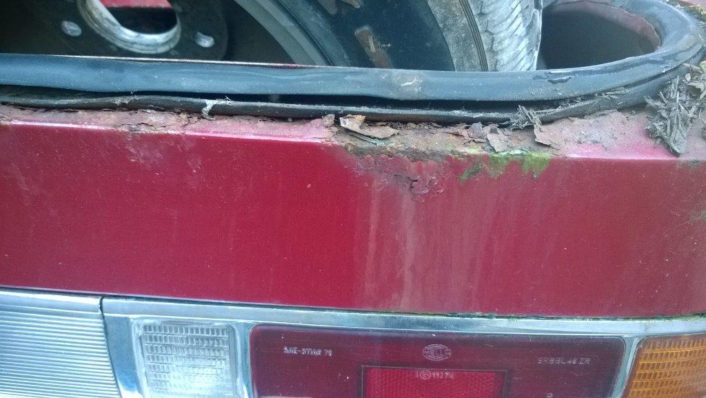

No telling without the debris swept out- there might be more problems than we can see.
As a WAG...... 15 k in body and paint, 2-3 years of work.
I would give it a value of 5-6 thousand US.
I think you are in for a huge project.

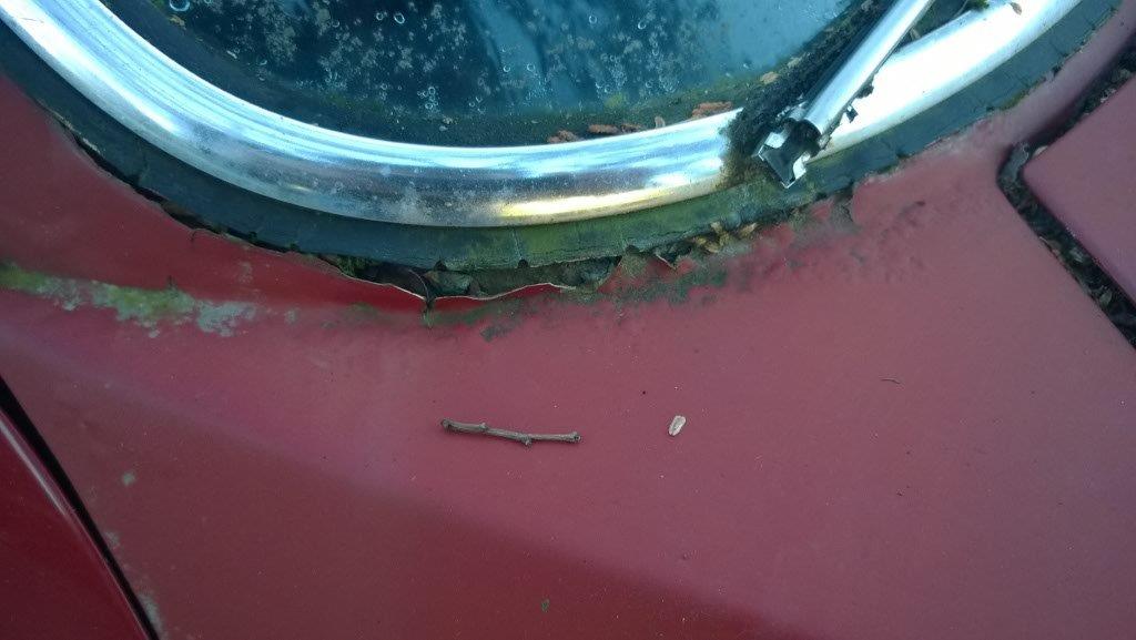

"Front fenders look really good"
Your front fenders as viewed in the engine bay, quarter panels, rockers and areas under the front and rear windshields are toast. Your trunk well looks fine but that is of little consequence I am afraid. This car has sat outside for eons and it shows. Add the unknowns of the mechanicals and you have a money pit. Ask a member here who is nearby to look at it for you and leave the rose colored glasses at home.
And Don's estimate for body work is low, sorry.
Don't know US values, but I know you would be in for a lot of work.
E9's hide there rust, so if what you can see is bad, what you cant see will be worse.... much worse.
That car will need loads of work and quite a bit of money spent.
Best Of luck if you buy it
No rose colored glasses here, trust me. I'm simply looking to understand what I should pay for a car in this shape.
Also, I could use some help understanding why the fenders are toast as seen from the bay. The upper fenders are one area that has no visible rust or bubbling, even under the sound deadening on the shock tower. Clearly, the rockers are Swiss cheese.
Kinda hard to tell but it appears the fender seams and areas next to them are rotting. Clear away the debris for a better look. Also, rust under front windshield near A pillar has worked its way down to front quarter panels where it has bubbled which leads to rockers and even more rust. The surface rust near fuse panel is also troubling, it should look like the original primer. Even the fuse door has evidence of water intrusion, never good.
Why is the area under the rear window toast?
