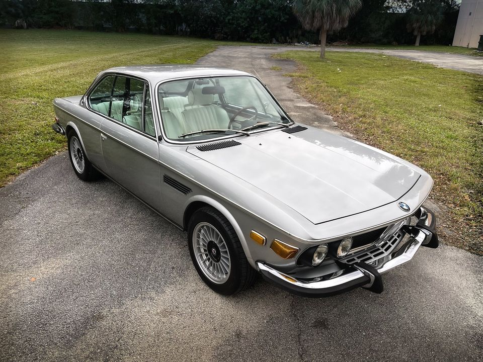

description says Fjord, but the pics look like Polaris. 5 speed but the automatic badge is still on the trunk.

My '73 coupe had the bulging front over-riders that were on USA 1973 Coupes for the 2.5 MPH DOT bumpers. I replaced them with the Euro style. The rear bumper is also the USA 1973 2.5 MPH with 3" spacers keeping the bumper off the sheet metal. The bumper has the cutouts for the license lights filled with plastic covers. The lights in the alum. rear panel was for USA cars. This car has both types of lights because the covers that Stan sells were missing at one time. I had the plastic covers which I replaced with the bumper lights and a chrome-plated brass panel from a 2800CS.
The color of this car sure looks to be silver and not Fjord. But the white interior usually goes with Fjord and not Polaris.

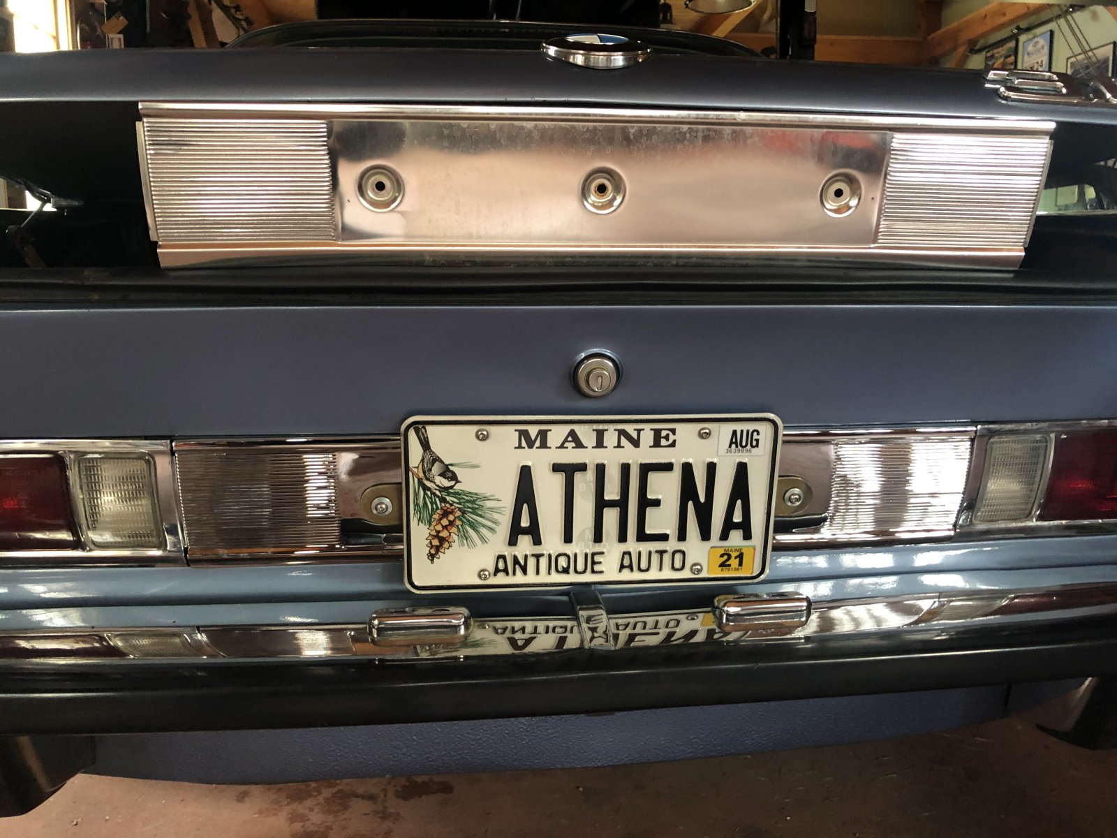

European Coupes only have bumper lights. The 2800CS had the chromed brass center panel between the tail lights while most 3.0CS had the aluminum panel. Replaced mine with a chrome panel which looks better than the aluminum (top).

I would never have considered white uph with Polaris...looks cool and crisp, tho...(two things i'm not...), so my Polaris isn't going white inside..even with the nice contrast welt/piping. Handsome looking car.
