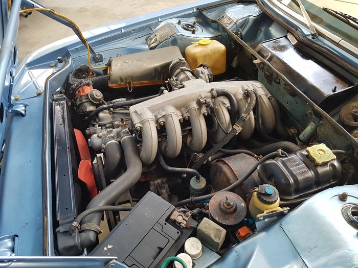

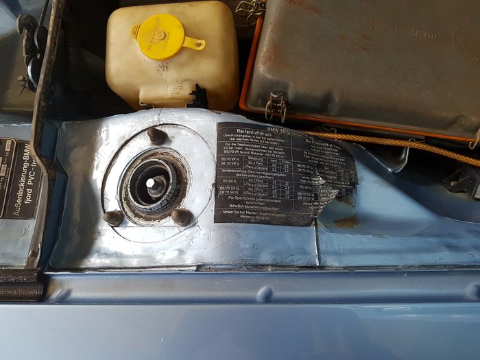

Interesting how some owners express their creativity with different colored windshield washer fluid reservoir caps. Upper strut mounts may be an homage to unbridled sun worship and freedom, as they are topless, i.e, without "dust" covers. :p

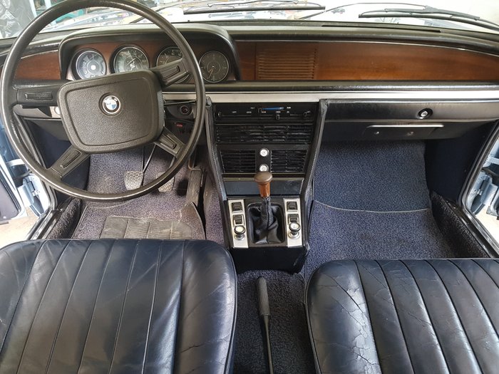

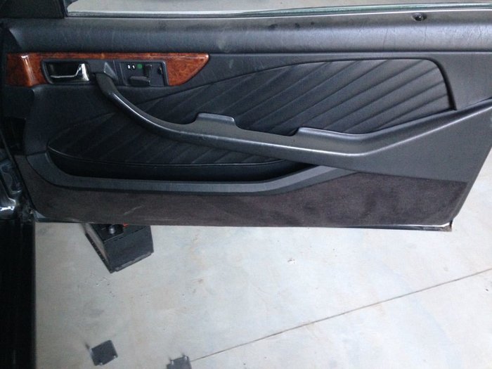

The photo series also includes interior shots. Although I have not scrutinized all of them, I am guessing the image of the passenger side door is from another car, or is it? (see bottom). ;)
Can't recall seeing an inline fuel filter mounted as pictured. Thought they were stowed under the battery tray, but maybe not.

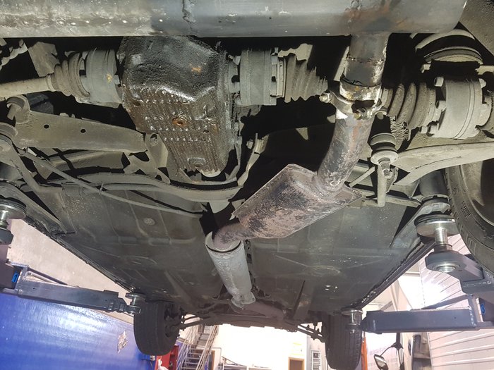

5. And last but not least everything was put back in perfect condition for the unbelievable investment of €1500 (this mini budget probably explains why they had to weld a piece of steel in the exhaust (cf. last pic))
