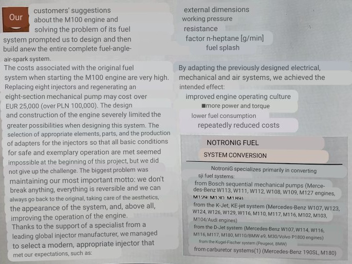

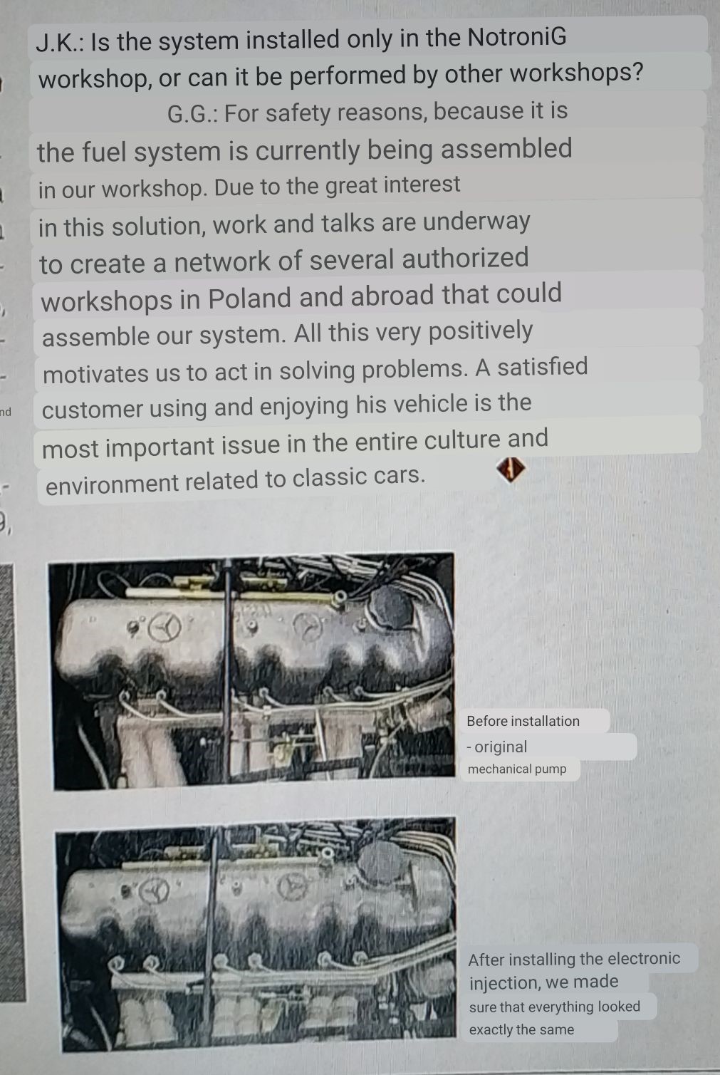

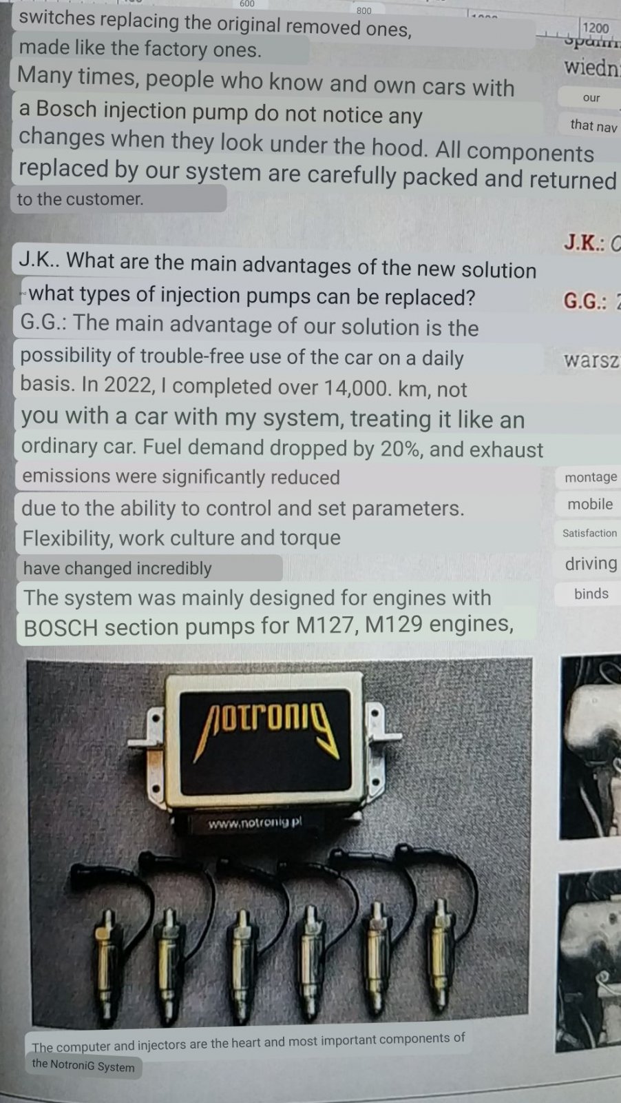

Looking for body metal parts for my project I learned about NotroniQ company.
They are equipping MBs, BMW etc with modern injection system keeping as much original look as possible.
They have several cars modified in Europe.

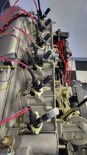

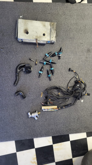

I have seen E9 engine being in preparation to the new system.
Here's what is being removed from E9 with D-Jetronic BOSCH
I thought it might be interesting for some of You. :)
Krzysztof
1,663
793
Poland
The Owner showed me articles from Classic Car's Magazine which I tried to translate online. Sorry for poor quality
