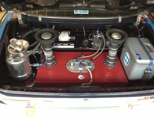

Holy crap. The second video is MUCH worse than the first. The CSL did not have a fuel cell?! If it did, could a fuel cell fail that badly? That is nuts.
I obviously have no idea. One thought however is that a standard fuel cell is modified to have through-the-boot filler necks. That’s a good 18” extension. If the boot lid moved as the tail end is crushed, it’s a fair amount of leverage on the neck.
It’s also worth highlighting that the e9 has absolutely ZERO protection in the rear. The shock towers are essentially the end of the car. Everything beyond that point is just thin panels welded together. That changed with 1974 US cars, but not this car or any other in Europe for that matter.

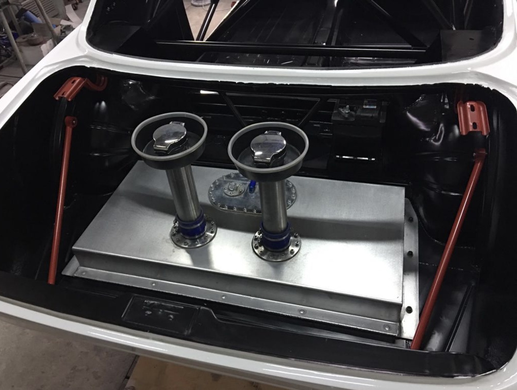

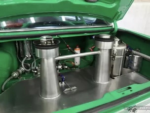

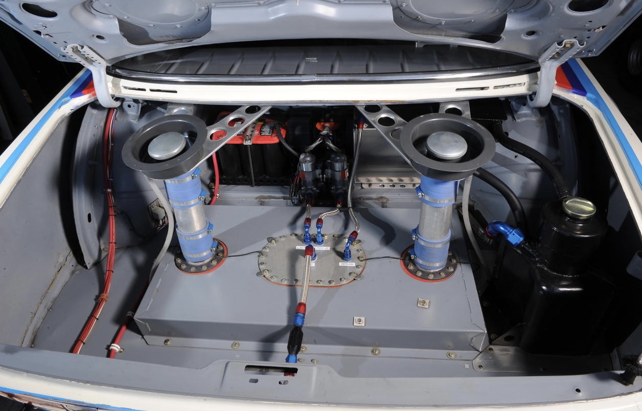

The image above confirms that there is a fuel cell of some sort in the car, based on the filler necks. I actually looked for pics of this car’s rear setup but didn’t find any. Here are some example designs:

Pics don’t show if there is a safety cage around the bottom/sides of the cell. If not, it’s just the sheet metal of the box (20ga steel or 16ga for Aluminum), and an internal bladder. A good hit might tear the sheet metal and puncture the bladder, or crush the box and eject fuel from the vent/valve.
IMHO, a safer race car build should include a “cage” around the fuel cell or locate the cell within some part the main safety cage. My fuel cell is in my trunk surrounded by a tubular steel cage that is strong enough to lift the car, but not quite as stout as the cage around my seat. It might have been able to maintain fuel cell integrity in video.
