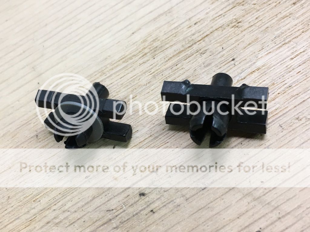

I was taught to put a small o-ring between the fastener clip and the car. It seals and also pushes the clip it out a mm or so to allow the trim to snap on. Without an o-ring, my new trim would snap on and then pop off cause the clip on the fastener didn't stick out enough.

Tim I'm pretty sure there are clips that come with those o rings for the belt trim. I know for sure the C pillar trim clips which are thinner have them. I have some leftovers, should only need four of those, six at most. I will check and see what I have and give you what I have left over. It doesn't hurt to use ones with the o ring, let's put it that way. How soon do you need them? I'll check what I have later today.

Just for some additional information, the left clip is an aftermarket piece available at Mesa Performance or Pelican, which comes with the thin gasket pictured. The right clip is a BMW piece directly sourced from the dealer, which does not come with a gasket. Any of the smallest o-rings I could find available at local hardware stores were a bit thicker than the gasket pictured.

Carl Nelson sells the spacers designed by Paul Cain.
