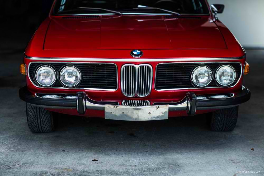

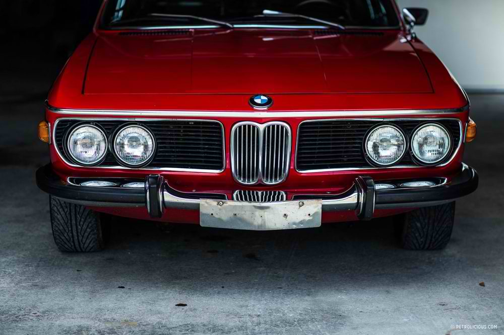

Omg, just realised my CSL has the 4 bar grill. The upside is it's brand new shinny and looks mint which fits with the condition of my car. Downside is that based on the info on this thread seems like it has been replaced sometime and my CSL is missing an origional bit - first non origional bit I have discovered so far :( .
Oh well something to hunt for on eBay and coupe.com. Hopefully a 5 bar might turn up for sale some time. Personally I quite like the full silver bar version like in the photo of this red car below. Does anyone know if these silver 5 bar kidneys versions came on UK RHD CSLs or only the black 5 bar version?
Markos
13,369
7,502
Seattle, WA
No
The center slots come out in case you want to have them anodized. They are fragile though.

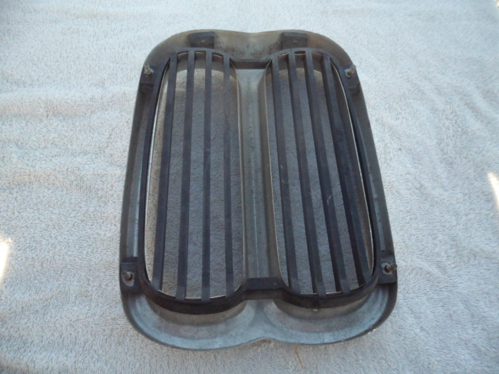

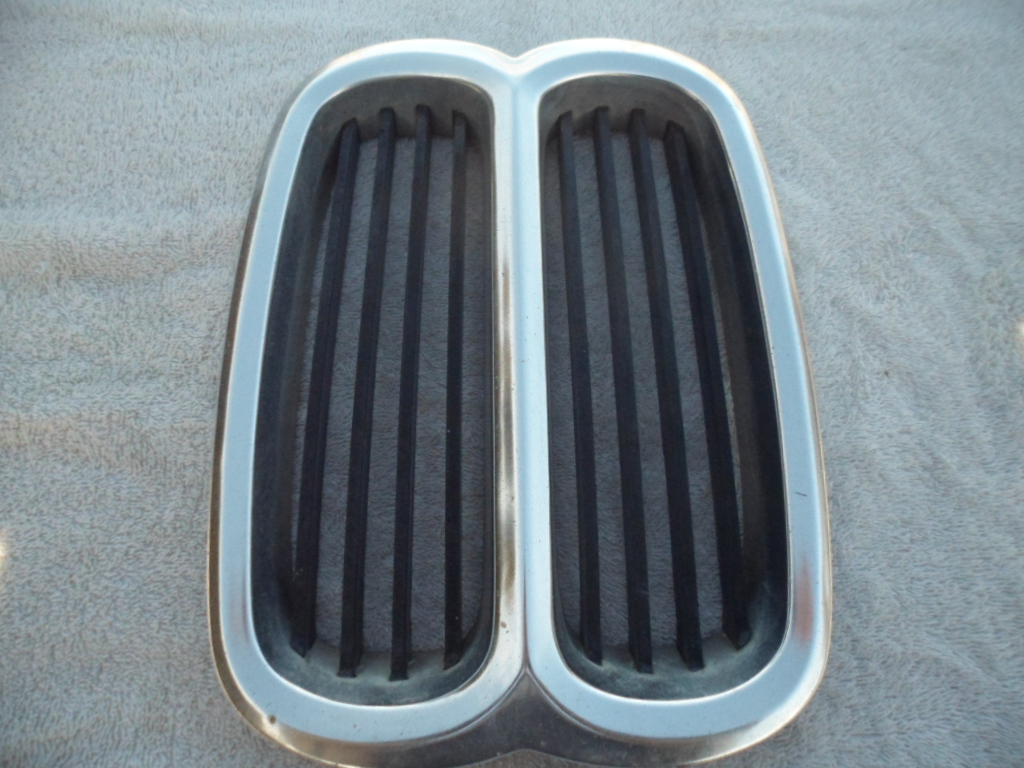

the back side of the 4 bar is much different than the 5 bar - the bars are all all part of the same piece of plastic.
Gary Knox
E9 Member Emeritus
1,821
743
West Chester, Pennsylvania
That picture of the back side makes me think this change was a 'cost reduction'. Probably significantly less expensive to produce the plastic 4 bar than the original 5 bar. Bars may have needed to be wider and thicker, as the plastics of the early 70's wasn't that great (and, the plastics in most German cars for the rest of the century weren't fabulous either!).
