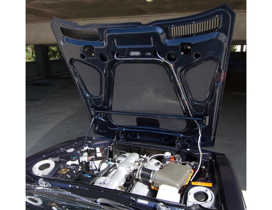

Hi
Having a brain fade here today, trying to put on a hood support that I picked up here and I just can't remember which way it goes on. Can anyone take a picture of the proper position of the hood support to the hood and from which way the tension should be on the 2 arms. It can go in 4 different ways, left or right or upside down???
Help get me past my old age and figure this out
Thanks, Rick

IT SWINGS FORWARD AT THE JOINT
102-jpg.21080

Hi Mauler,
Welcome to the E9 Board, the pictures are just what I was looking for. Double check yours right in the right angle weld at the cross pipe to the arms They tend to crack there, if you can catch it earlier enough, you can reweld them.

Like this:
s9IBc8oGLBYruD2JGeKa6euTxaI5ODWKKGF-bVX2oVA_lh_rh1RsKi-89Pb0obP_7V450AKFXRdVLD3DB_qpn95Ear6zKB8lY5jrXQf5uZFeLGD_XUmQQW9K11GNEdr1_jTpzpmi0AiinjwBYLUlW6KaSJ2EZR8sNSThl1IOrd4R9cxecB7sM-dy87Jxj3WwRsucuWG09WGcuO_bwagAOzNm-uEO08SgbAtHvyJS1jaP_xbRYQ0WY4B1t8w-0Ndg-W4F30VG4mhsfE845_HsZS01W_RX7bf4uciK-k_Z9_hkuFqofiFqDEZaOZydHFeRHx2zYvYej53iiHt4oTInVR1DC1FbYcvKxT2Buij2mYjY4Zmvo-ZJ5V8ktVCWCMoaClK4lhR4ihz4WIWnoA2vBXywSKoB-3znlC-8zydUTfOjdCVTVMhniXi9Ky7LwMyBUuriS-h4RPZAuwOFu9q0VbBx9iScX03ojm8iFY59JPpRUEvKh2_uDkWUSTkUmpR9jcRFFJMLI27-hp2snpL3JK1WbBgJlGtRBEO75rpSe6f7bMSgGfqcyDl5kgMXmdA0Fe8eTXH2CFWDEUDD_mfFkn0PHxPZeIwGgq7XFG88FSTU8N63=s771-no
To this:
gfeyeDChTTMd4mZa_NfKDdQVPqWoTpnCoEuS1WnOQy05R1ydXuI2-dN_rpKFHXUyZ190kc5E7YzFQmXrzm5SV5j49YGSqndzF6xnrnQCF3NORQ_m4MFfPgbr9HhcvPu3pNj6ofhe2xeyv-A8bt7_o4Gs-inRXJdb-f9AY8JHxQNwCTVTgH9xZBBVpkT0Fl4Fytoiuai7rUQZxioKMeRjzeeETlj-R4ioQ7G7rj4S9mYYzh7ARhfdST1rBc2e12GwevyKjXPPj3WX1eusk7qTFdqG0Vi8tdmraunUbEbI-NhOCtk-FND3EZoaCCSSxxtM20VuvtlkWRwwF4TphLe-u6j1VM_m99LGv6k2Pn-1WSRkiKSMWr-81KBpdtl8LiY7R-0KMLLPN4XMjjDjYmFPCkyIr-bXXjCZPq4qomwoAnHDoM5qQJEdR_u8G4kPD6CwbWywyhnLU3J4g7e3J1WpFywbSBH1iINH_zUUVr7yg5jTS1gikqM4K7TJtP-4bAtwm-S6mRH_OiX-NGsTskrQNKEhf9KrTvSe8O_ZCWxxUSKjGoMEAMZZW4CxinjzAUs9fqhrNYTo_4spw0xqWH5n_38XrNIXuSb0HkKcFXGRVCxRSjPz=s771-no
