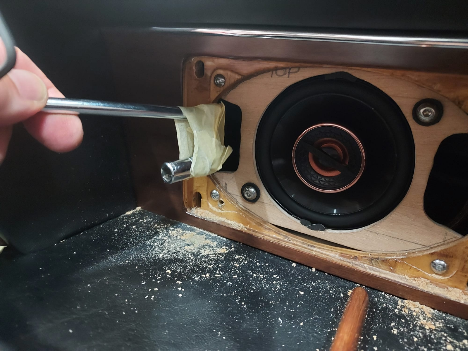

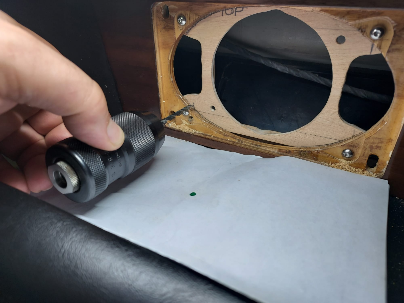

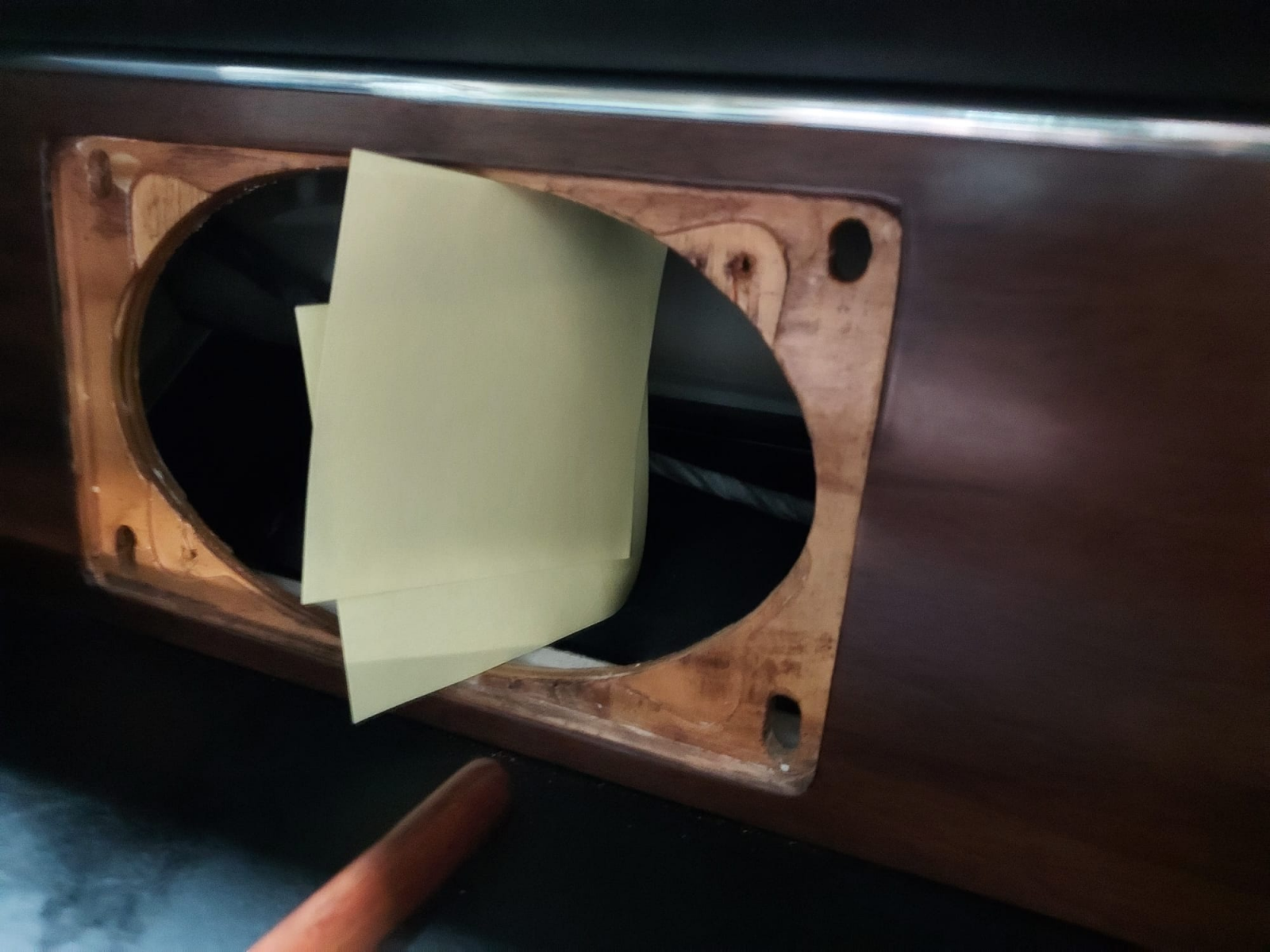

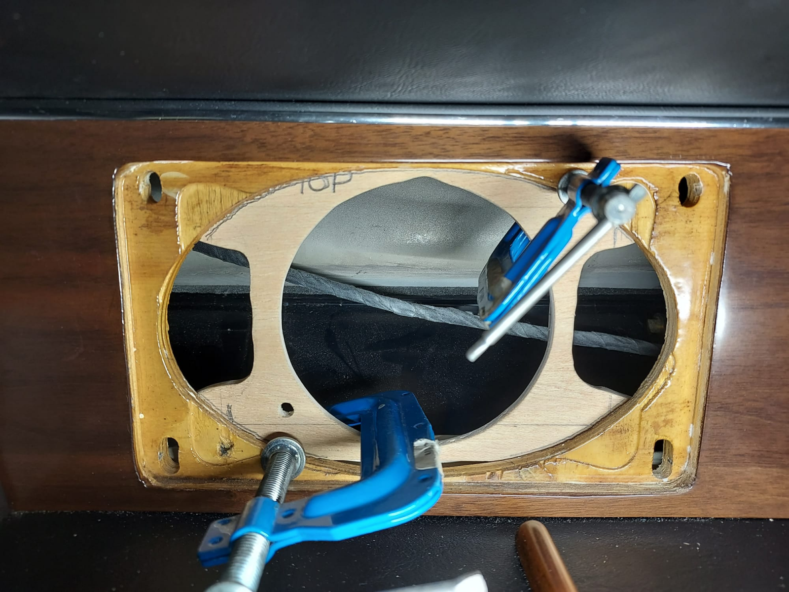

the dash hole is not enough hole
modern speakers find difficult to sit in that place, it is a 4x6, but modern speakers tend to be 4,01 x 6,01 enough to be not fitting the hole
moreover the depth is not compatible with the grille
so
deQuincey
Quousque tandem...?
8,422
2,432

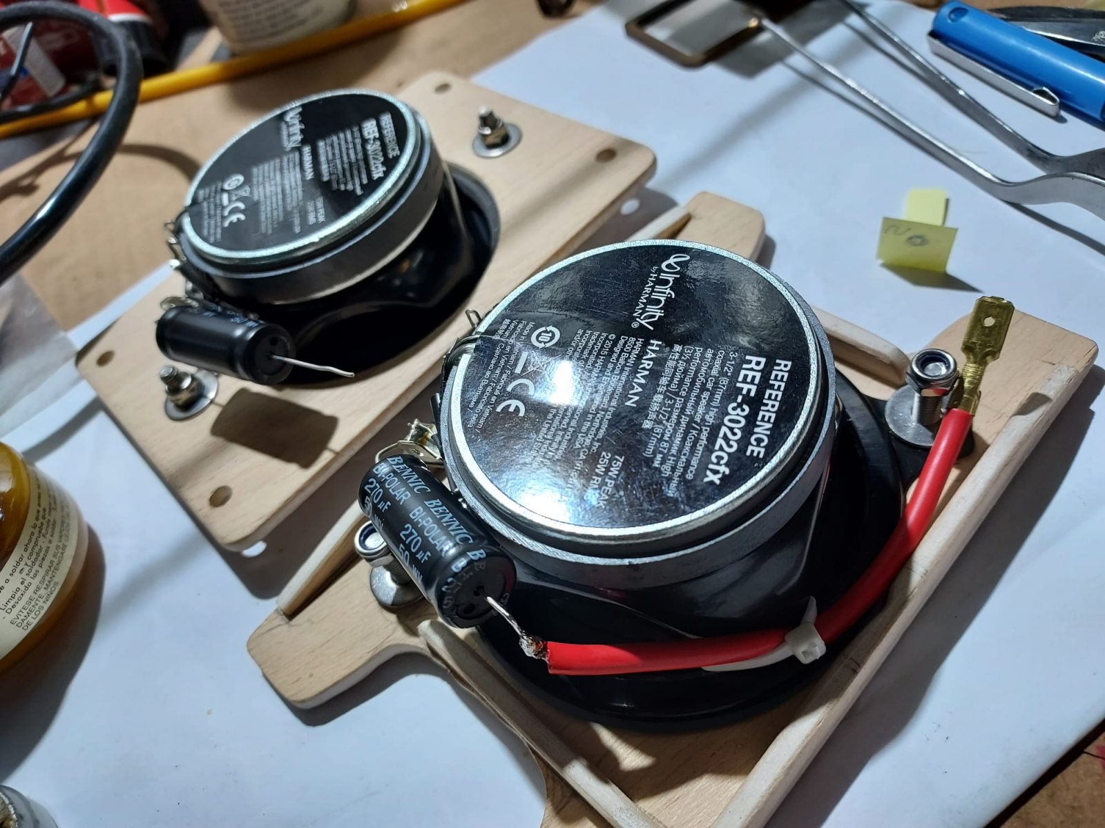

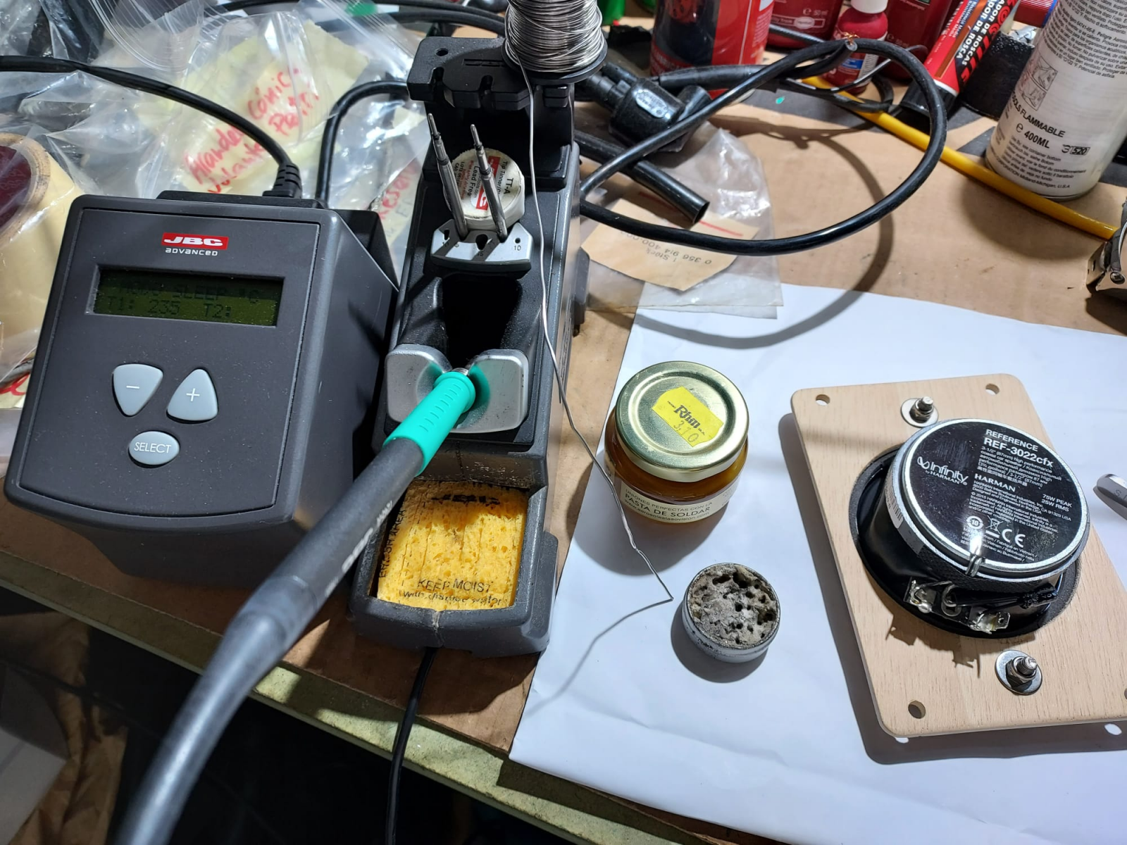

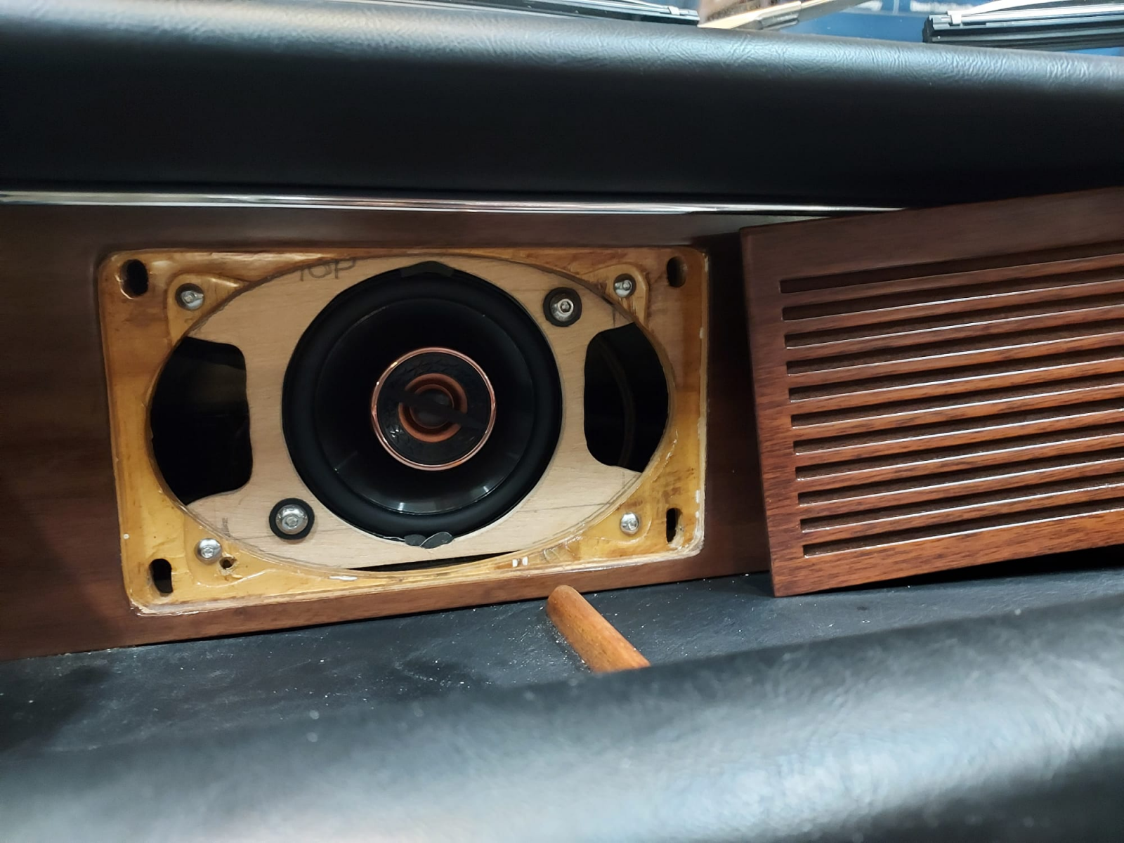

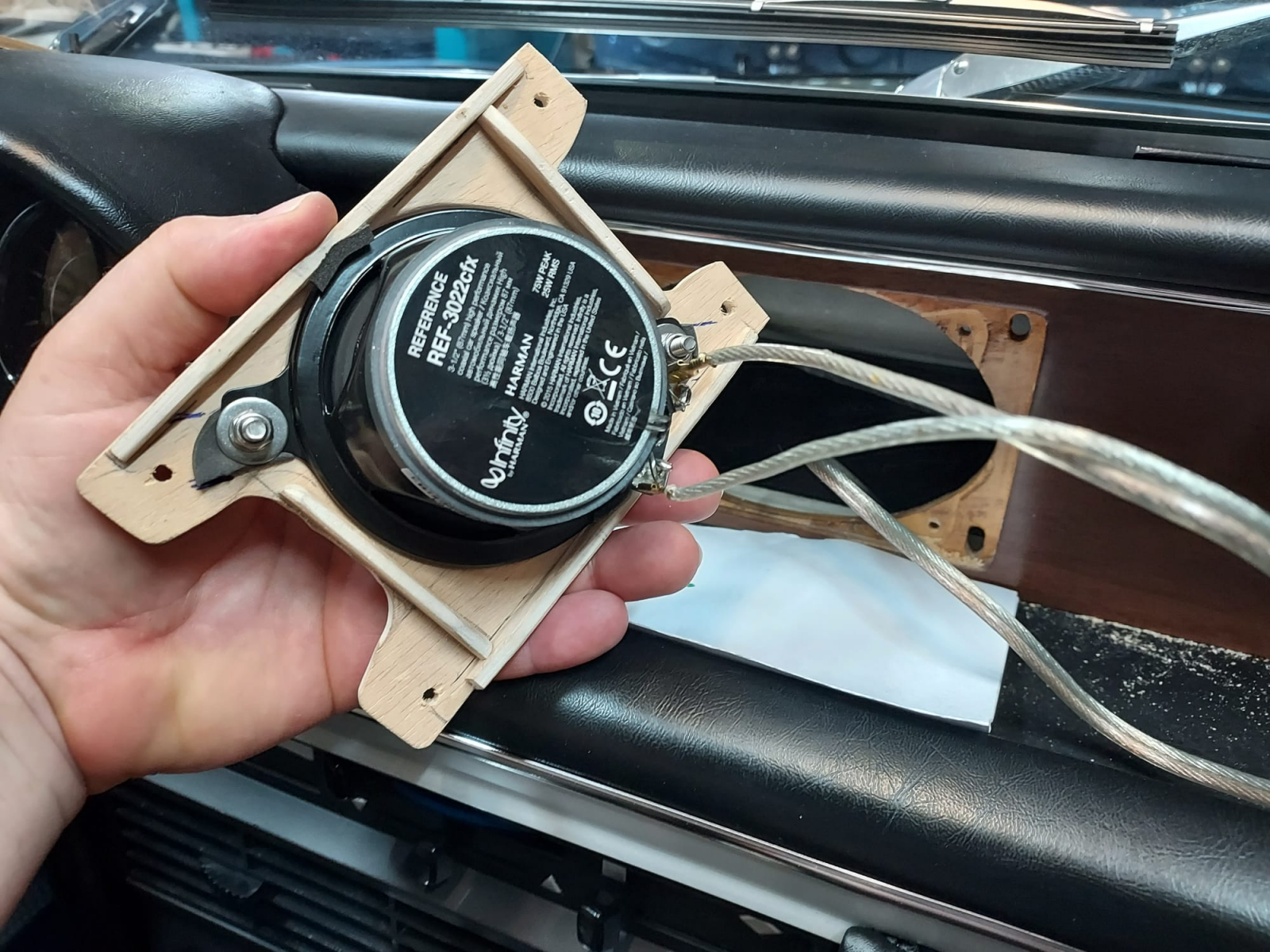

the inner support, all cuttings have been strategically defined in order to allow assembly and sound flow, but keeping robustness and structural integrity
deQuincey
Quousque tandem...?
8,422
2,432
The Harmon box you photographed says "Nominal impedance: 3.0 ohms", so wouldn't connecting two speakers in series give 6 ohms? And if that's what you are doing, where did you mount the second speaker?
apologies, yes, 6 Ohm
second speaker seats on top of rear transmission tunnel
insde an appropriate blaupunkt box, it is cute non obtrusive and works well

is that possible in the e9 ?
I think it would be tricky; if I understand tthe suggestion well, it would mean bringing the speaker grille further into the passenger compartment, and to (for example - sacrilege warning here:) use an old grille where you remove the slats, so to keep only the 4 edges.
Problem is that directly in front of the grille is one of the wooden pegs on the vinyl tray. The grille couldn't move more then a few mm's.
Erik.
Erik.
You right
