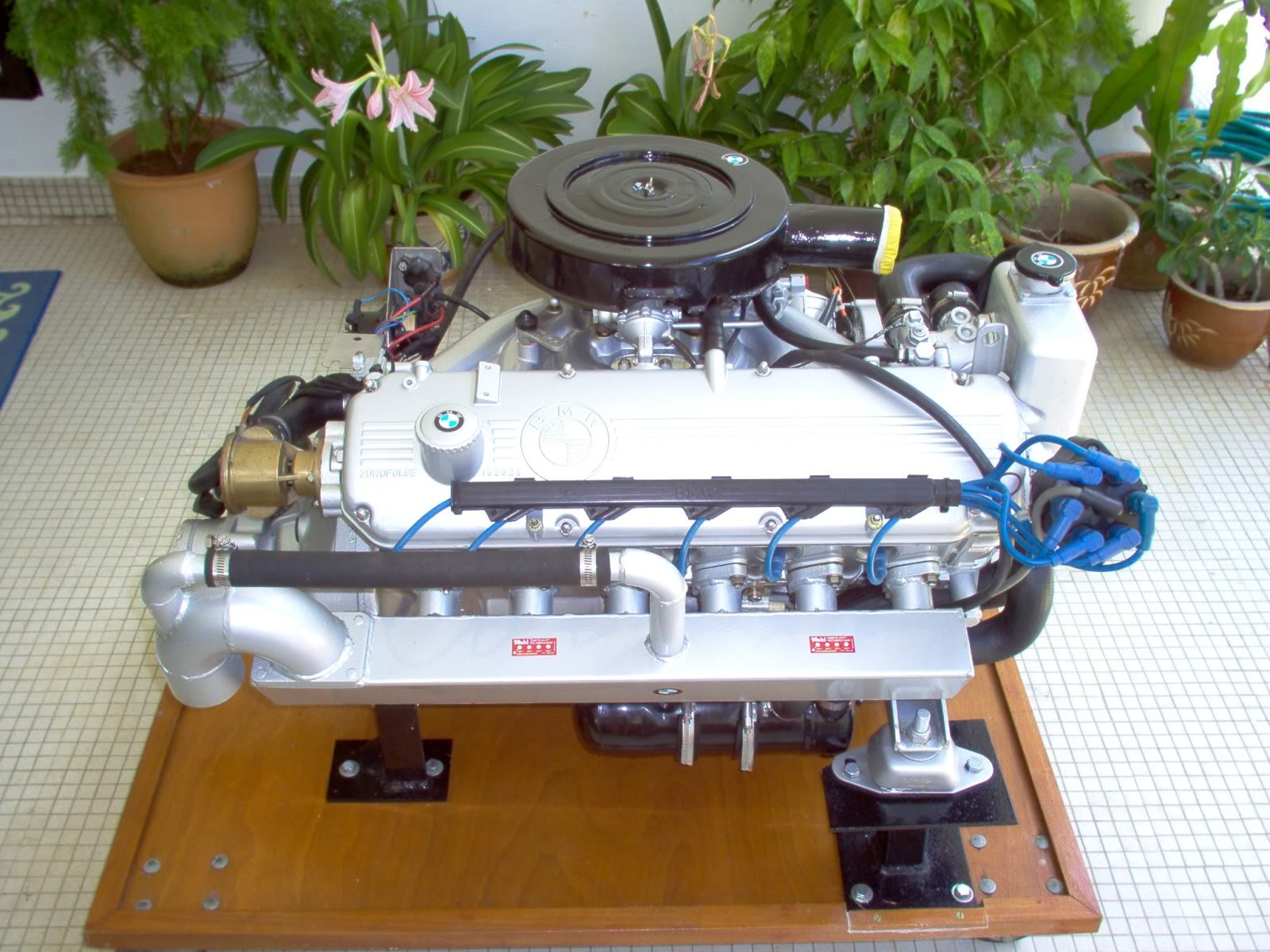

IMG_5373.JPG They also use that on BMW marine engine b190. You could probably get a quadrajet to work. check over on mye28

View attachment 24092 They also use that on BMW marine engine b190. You could probably get a quadrajet to work. check over on mye28
Or here is a link for grins
http://www.bmwmarine.org/parts.html
