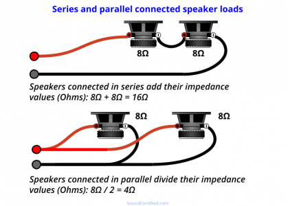

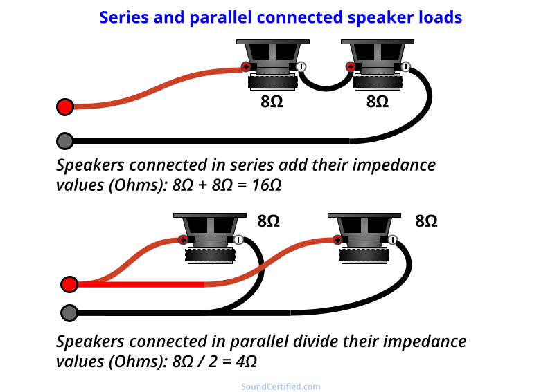

Be aware of ohms of the speakers you’re wiring up. I believe vintage Blaupunkt mono output is 8 ohms. Speakers with higher ohms will not work well. In my 2002 I wired two 4 ohm speakers in series to a mono Baupunkt Frankfurt. Works fine. When wiring in series the ohms are added together, wiring in parallel divide their ohm value.

If the amp is stereo, you run the radio output to both amp inputs (L and R). This connection is in parallel, but the impedance arguments do not apply as the amp input is high impedance. The parallel wiring should be symmetrical, namely the parallel wires should use the same polarity at the amplifier input. The amp output has two sets of outputs (L and R), and each is wired to its own speaker.
If the amp is mono, then the radio output connects to the amp input, and two sets of wires go to the speakers. Here you can consider the parallel vs. serial connections based on matching the amp output impedance to the speaker impedance.
