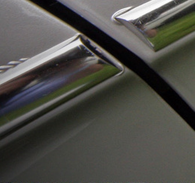

Guess how I know this car is wrapped?
Belt Line Wrinkles... Also - the Alpina striping is hand painted. Not a lot of folks to do that these days...

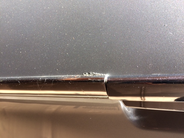

That is not a wrap.
My car (also painted) has a few of the same wrinkles around the trim.View attachment 26171
Ahh. Certainly not trying to nitpick (my car will
never look that nice). I was hoping it was a wrap. :( I've never seen wrinkles like that before. Perhaps the trim went on too soon on your cars.

it's the classic trim installed too soon without spacers syndrome. My friend's verona has similar.

Here's why it looks like a wrap to me....look on top of the side trim on the left. I see a "paint" line there, like the car was painted with the trim still on.
Looks like a nice car and validates for me how nice a wrap can look.

i completely agree with Steve. this is from 1. pulling the belt trim too tight and 2. not using the shims between the belt trim + body ... LaJolla sells the shims.

I agree. I am going back to my original conclusion. It is a wrap, and you can clearly see the vinyl overlapping the trim on the door.
