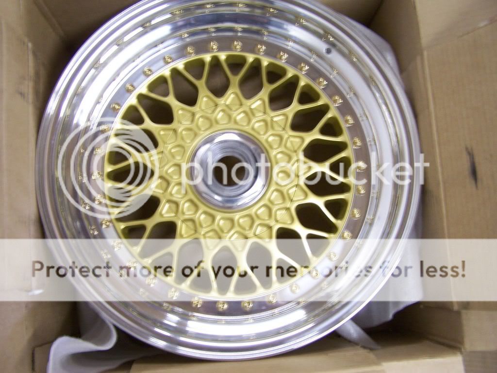

Finished the wheel tire/project. 16 X7 and 16 X 8 BBS RS 005 Dunlop Direzza Sport Z1 Star Spec. 205/55 front and 225/50 rear. To say these tires are sticky would be an understatement. This project started as an ebay buy, wheels for $950-all 16 X 7. Then to Greens Auto in Vancouver B.C for restoration. The "lips" to modify the rears to 16 X 8 came from Hofmann Racing in Germany also the low profile hex nuts and gold plated screws. 800 euros for the lips (2 1/2'') screws and hex nuts. Restore price was $1000 for straightening, finish, and assembly. Tire cost was $780 shipped from the US via Tire Rack. To say this project got O.C in the budget department...Well...once only deal, and I love the result. Alpina wheels just look wrong for my color. One thing that came up was the the new racing lips have a 8mm valve stem hole. After visiting three different tire shops, none had a clue or suggestion. I started to think "where have I seen this small a hole on a wheel before?"
Motorcycles! Found 1 ea. of the desired stem at two different M.C. shops, the sevens were EZ and standard North America spec. Then found a "no touch" machine at Canadian Tire to do the mounting.

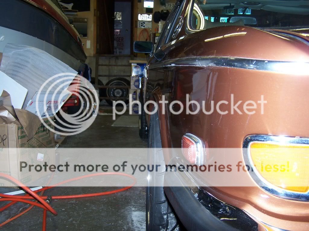

Abe,
Let me take a side shot of the current set up. As most would agree, 205 & 225 is about as wide as one would go. I am right at the edges of the quarters. Any wider would look...well...
like some LA low rides if you get my drift. This project was a little tough and pricey. Could be duplicated? Yes, yet I feel it is special and worth the effort, for my car. These were some well used shells to start. I had my heart set on the gold, my other wheels were BBS single, forged, but in the gold, 14 inch. Tire size 205/60 and looked quite cartoonish. My refinished pieces, these are like fine jewelry, the three piece. But to find in gold, period specific, restored, I had no luck and searched for some six months just to have my starting point with the beaters, now restored. Had three offers to sell these before they left the wheel shop! No way...

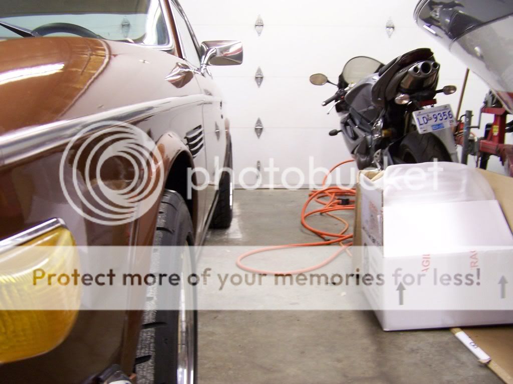

Side shots
Hard to get perspective. I would be advise against varying the established formula as so many on the forum have attested to... 205/55 front and 225/50 rear on the 16 X 7 / 8 stagger ET 11 and ET 24 for the sizes. The difference being the "lips" or outer rim 1 1/2'' for the ET 11 or 7 inch, 2 1/2'' for the ET 24 or 8 inch, and for ET 36 -3 1/2'' on the outer for a 9'' wheel. Not sure what an ET 20 would be...I looked in the shop and the only wheels I have that are ET 20 are 15 inch - a 7 '' wheel...? If this is the case than a 245 would not work in the best world. Saw a lot of the black/silver combo for decent deals...not to my design. Could someone with more knowledge chime in...?
