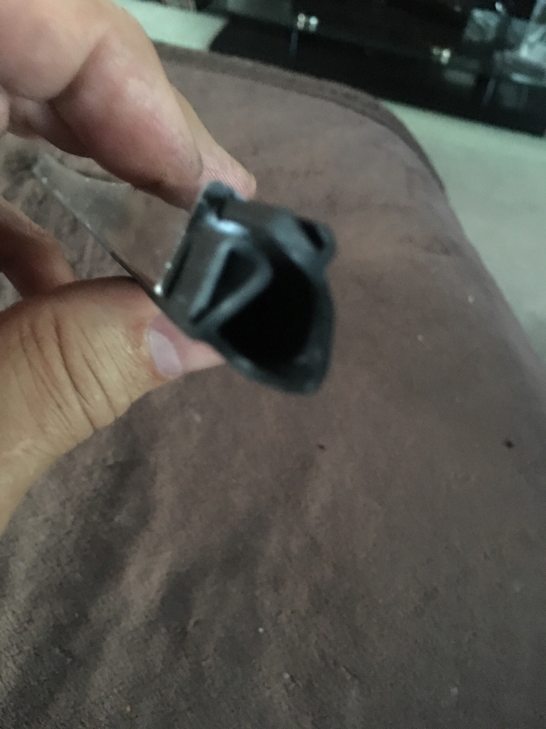

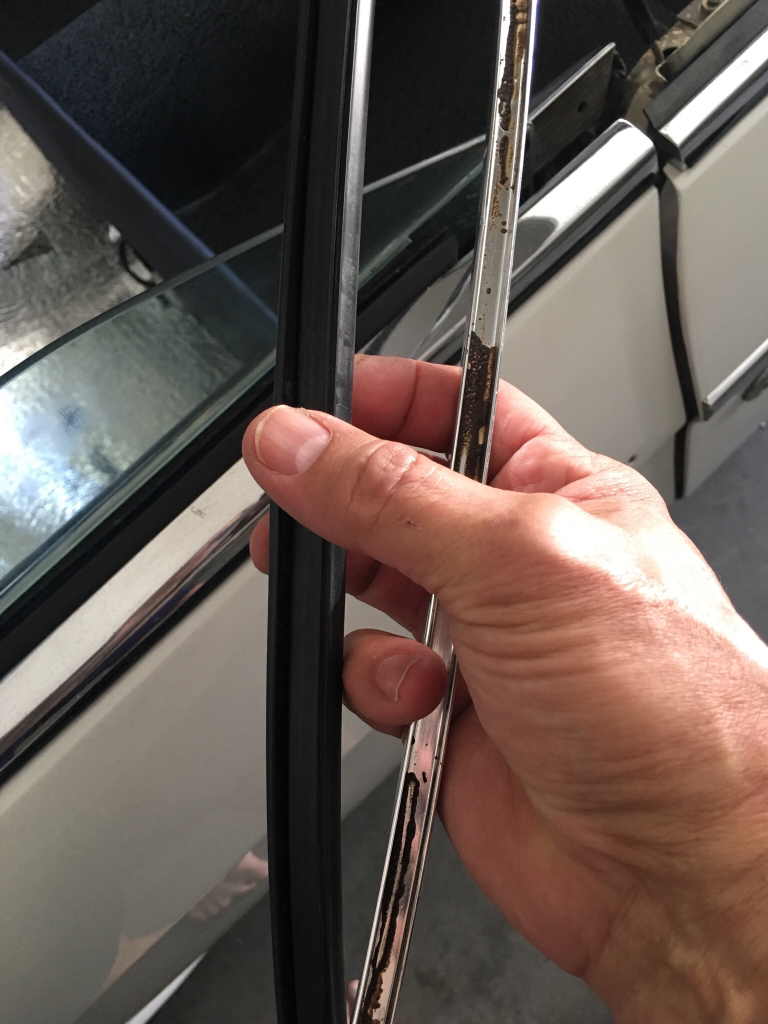

I'm in need of the thin rubber that fits into the chrome piece, which fits into the qt window.
What do you guys use? I was going to purchase new chrome but only one side is available.

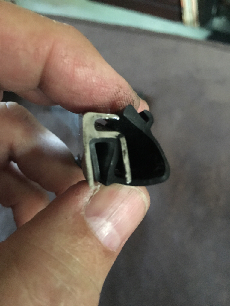

Ok , you learn something everyday... I just put the two pieces together and realize the rubber fits . My bad
My old rubber was missing .
One more thing I don't have to think about today.

Barry, you first need to put the rubber on the edge of the rear window ... then put the chrome trim on ... then put the 'ear' into the slot on the chrome trim. you won't get that piece onto the window fully together.

Scott, I thought rubber goes into trim and then it is pushed onto the glass? Been a long time since I've done it though. (Use lots of lube)

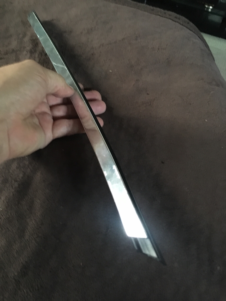

I bought two new chrome pieces for the left side rear qtr window (I think that is the only side available). The ONLY difference is the angle cut from left to right. The second one was modified to fit nicely on the right side. New chrome, new rubber, seals up great.
Bought the chrome and rubber from W & N.

Fit the gasket on to the trim piece then use some quick detailer as a lubricant and push it on by hand. Roll the window up first so you lessen the chance of knocking the window out of alignment or worse, breaking the plastic guide.
