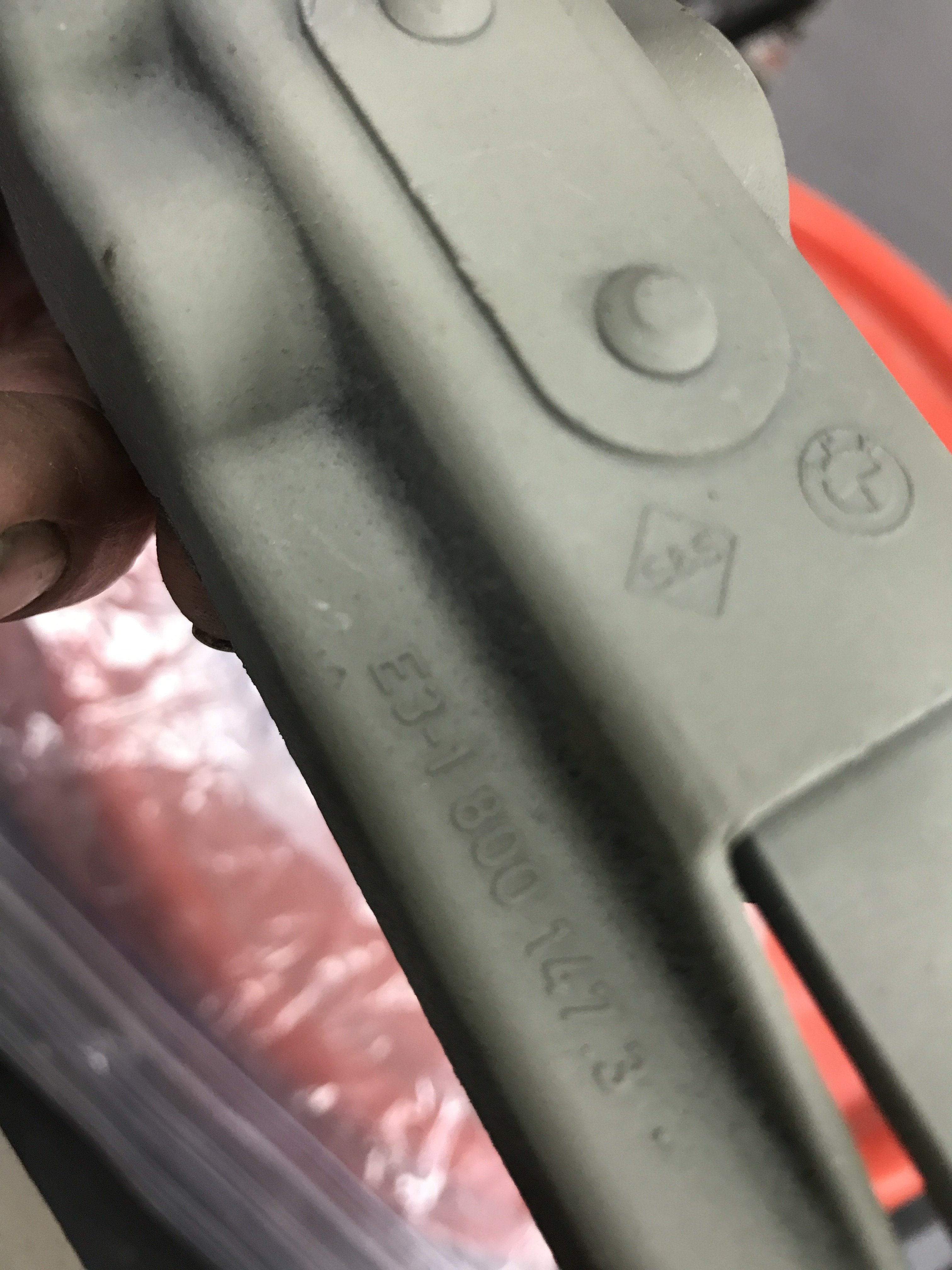

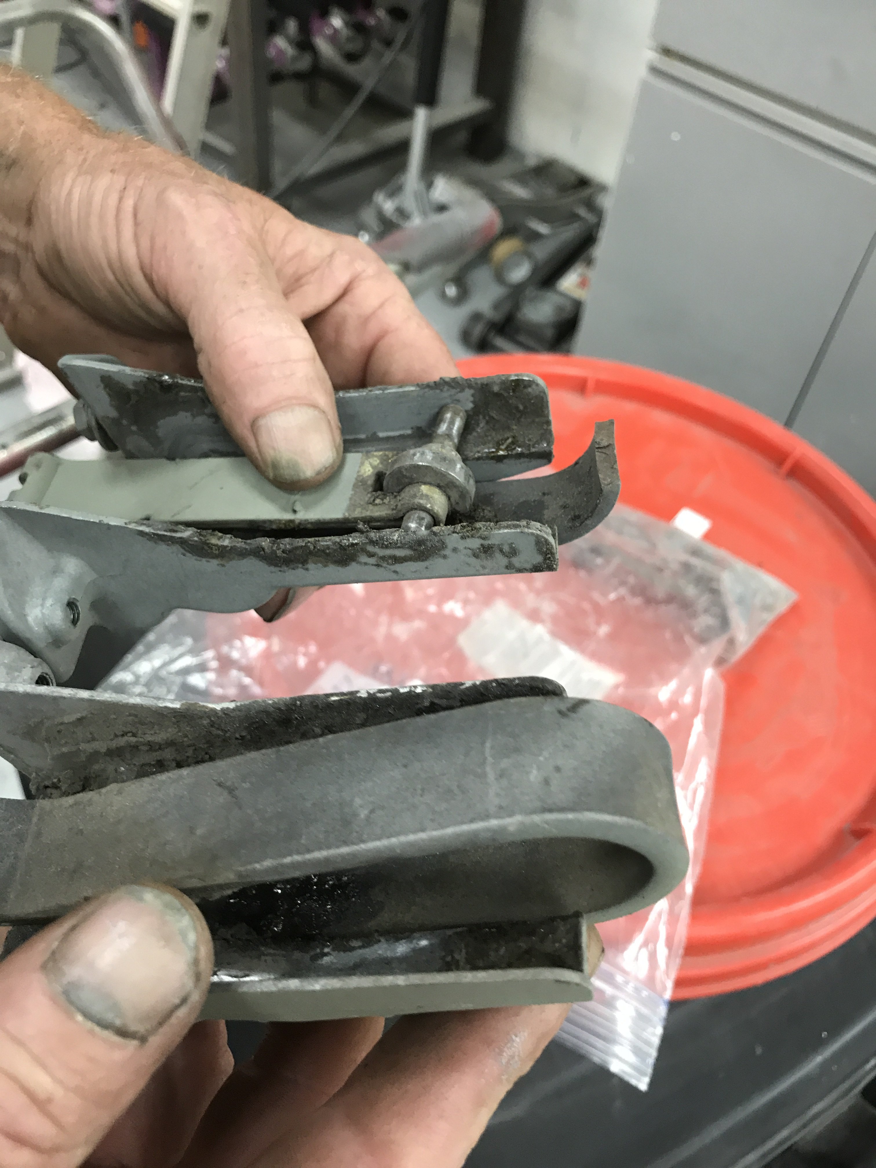

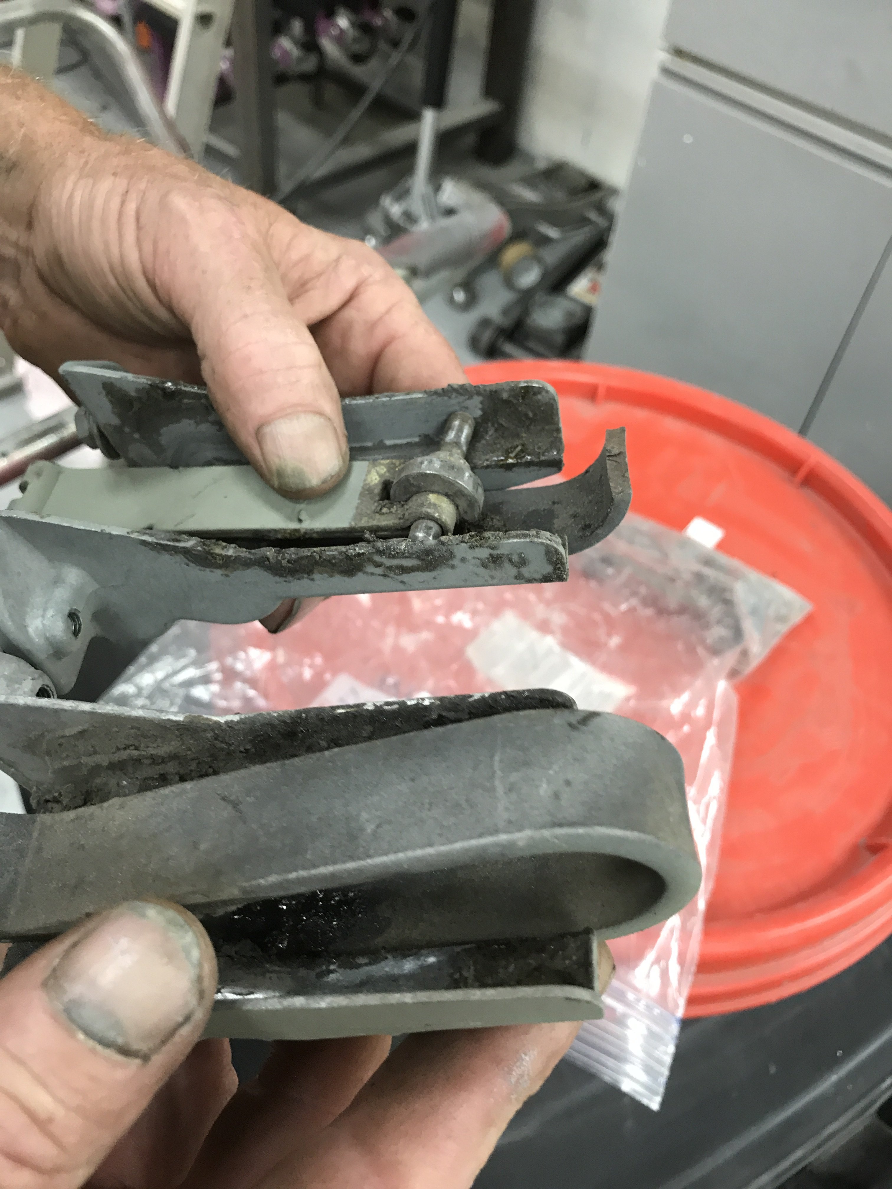

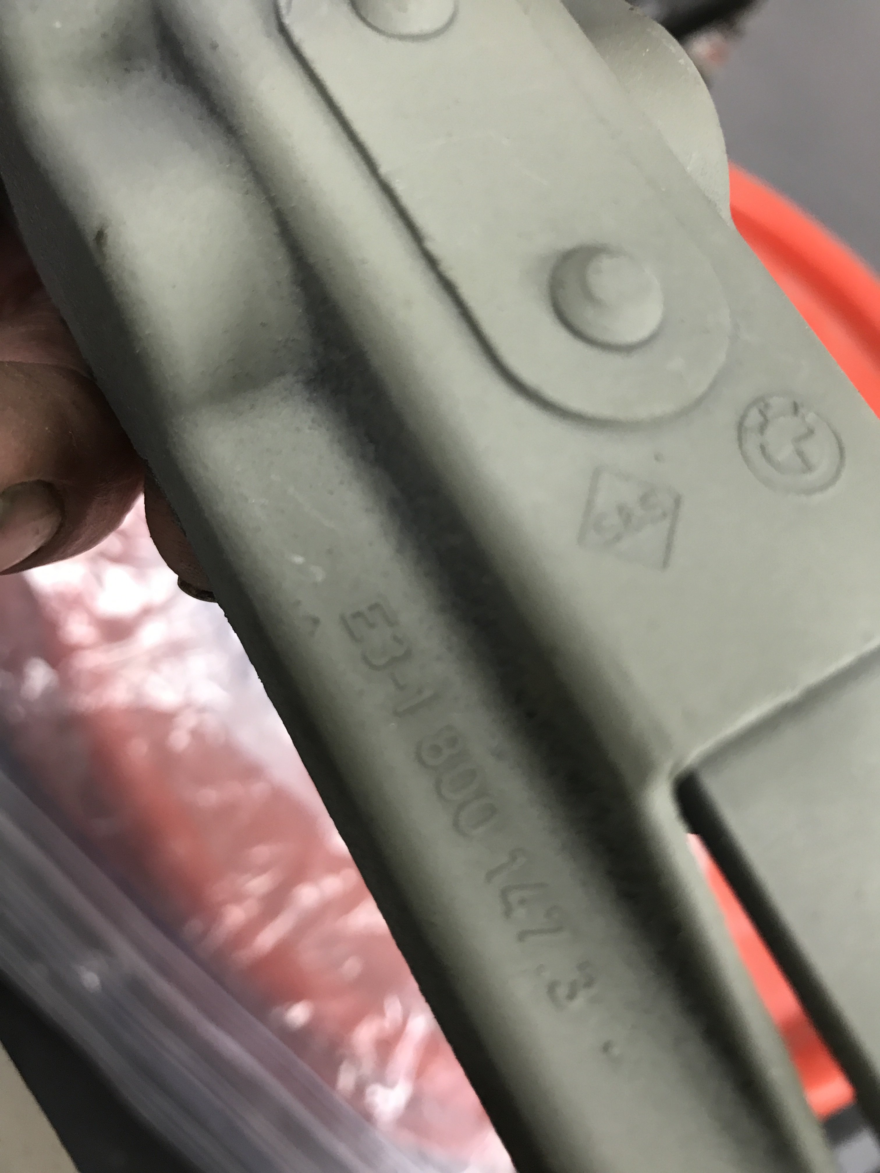

these are known as door brakes or door checks, and this is the original style. The best substitute is from an E21 320i, but you will need to make a bushing for the "check pin"
