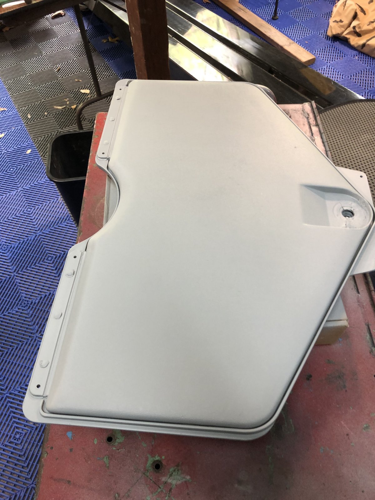

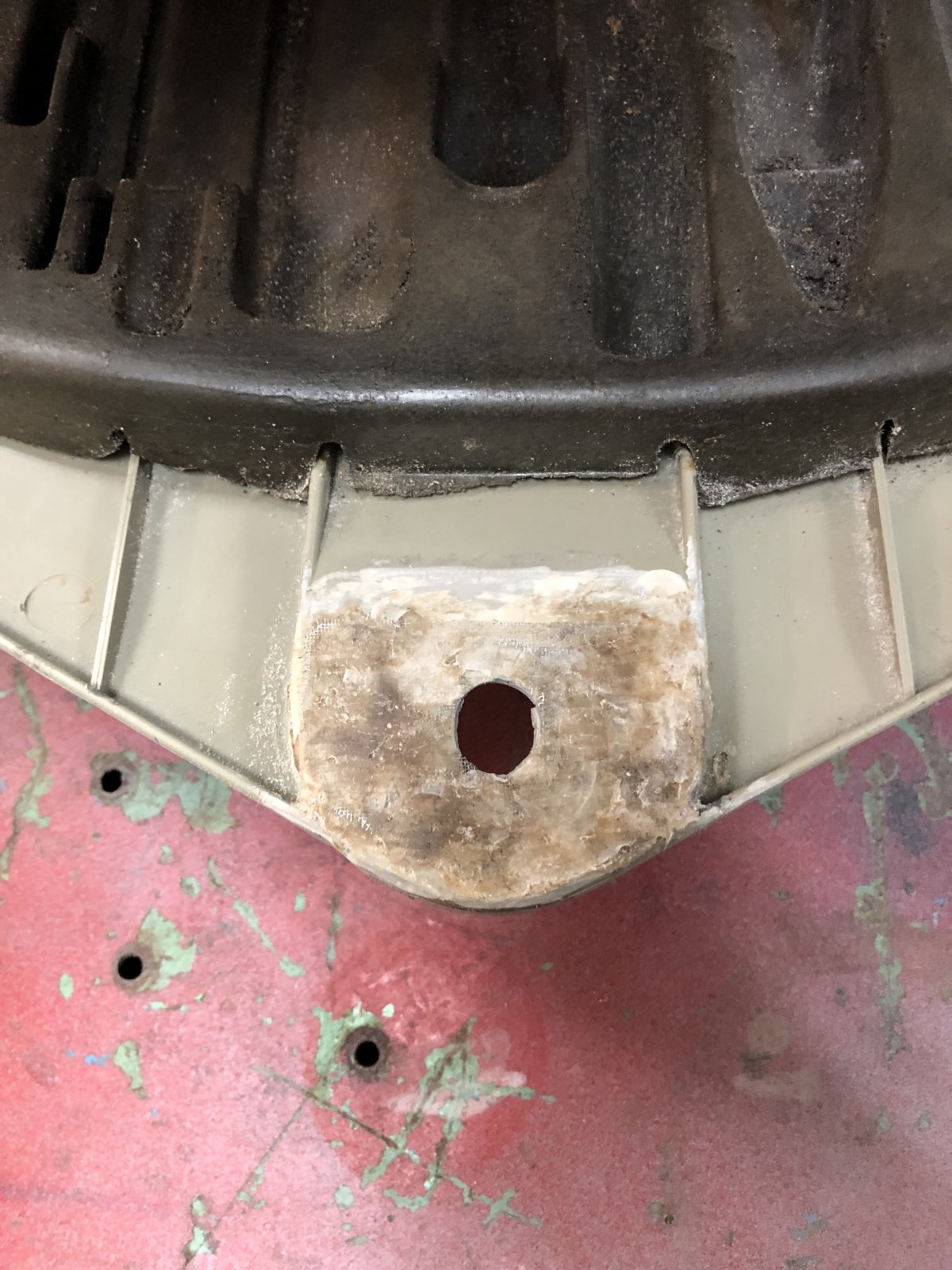

Koopman's son made the "wings" and back hinge area from aluminum, four parts. I just used JB weld, the paint with SEM storm grey, cannot tell. I still have my tools in a tool roll since I think the original design is flawed and cannot tolerate the weight when it ages and has been exposed to heat for so many years.

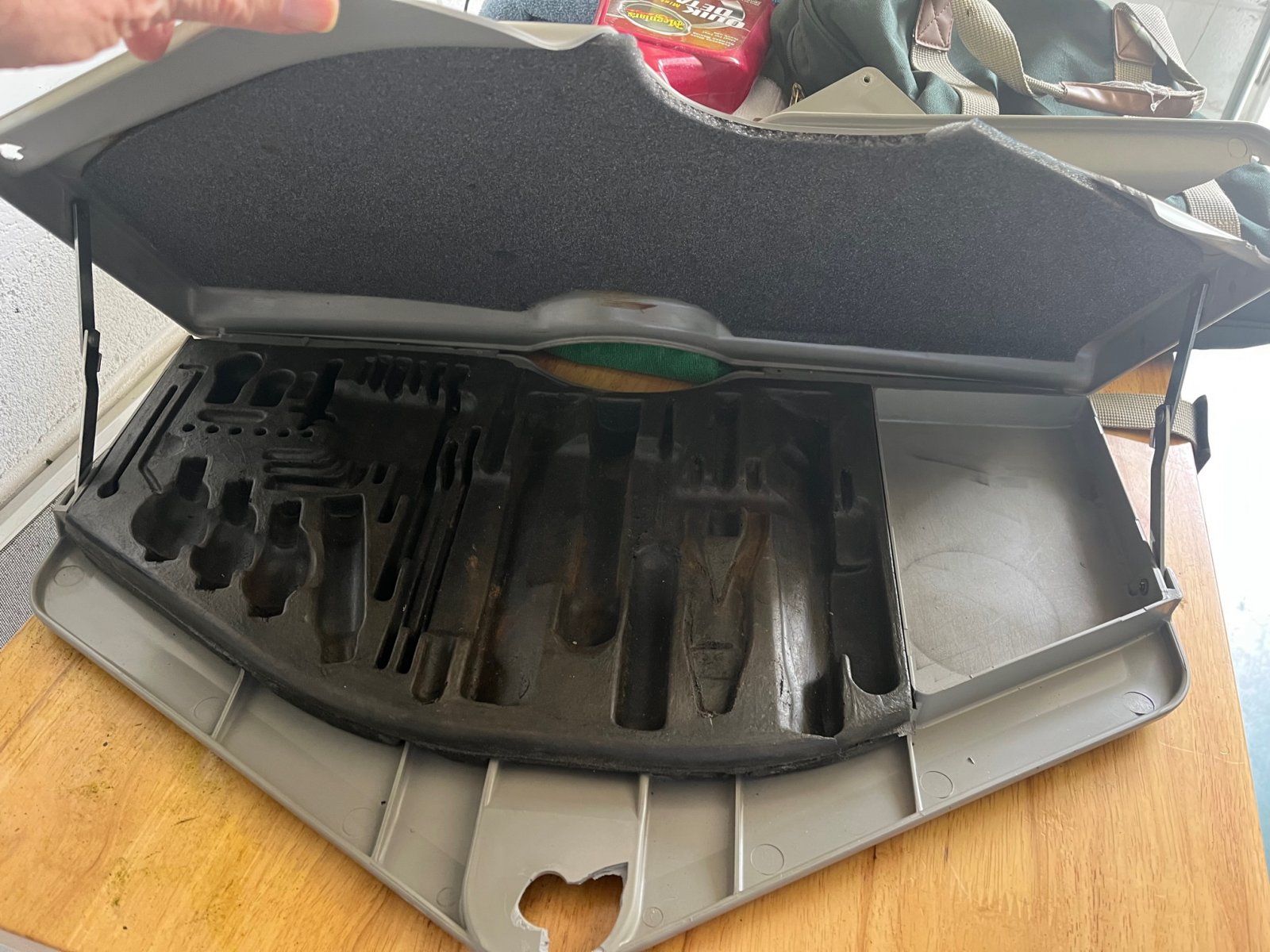

The visible lid, holding the tools is damaged, but not as much as the part that mounts to the trunk lid.

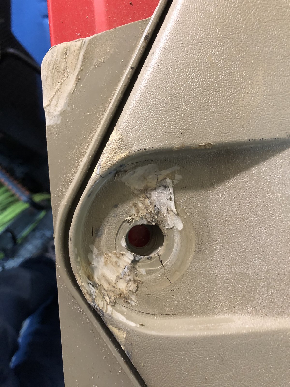

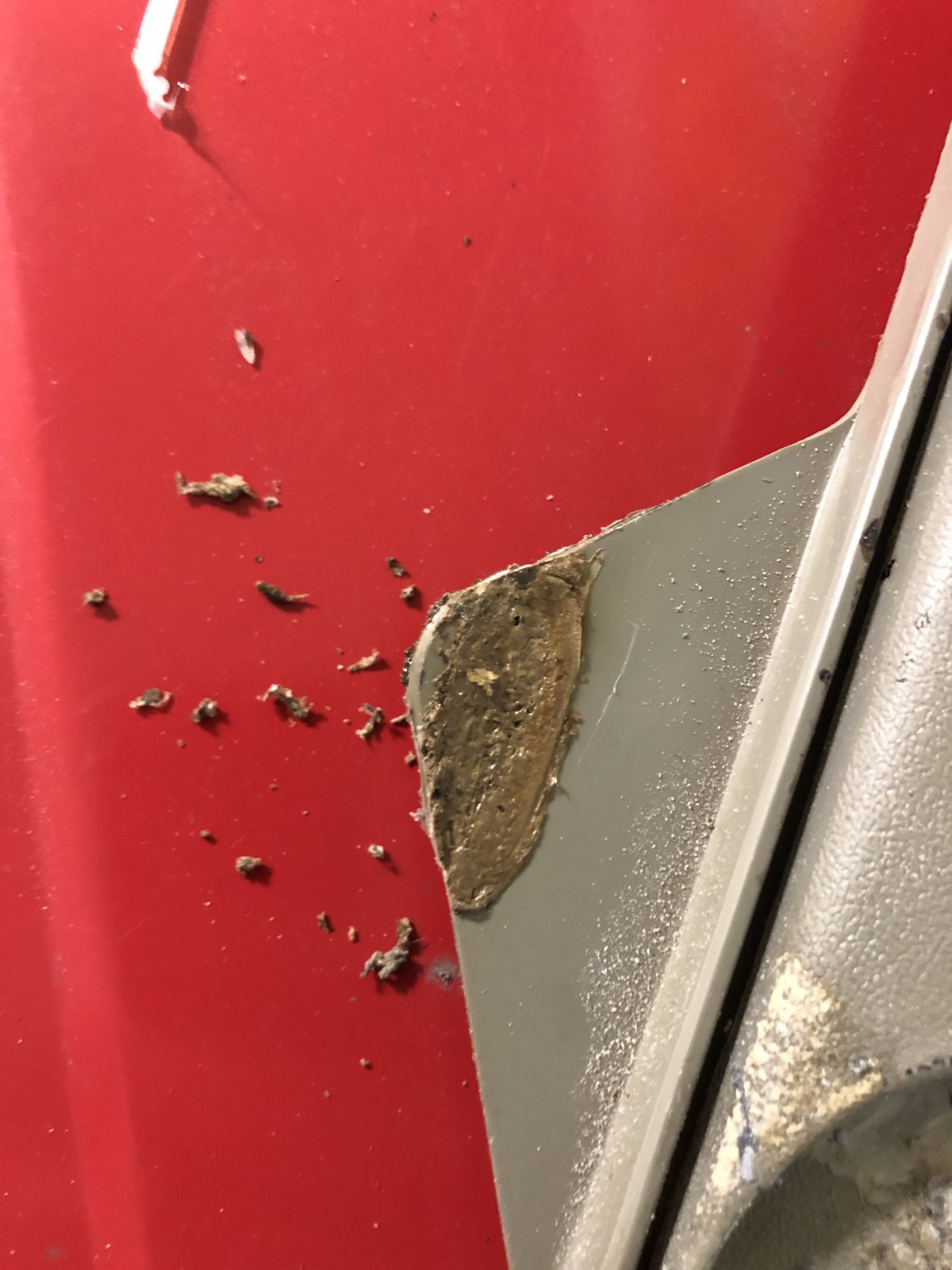

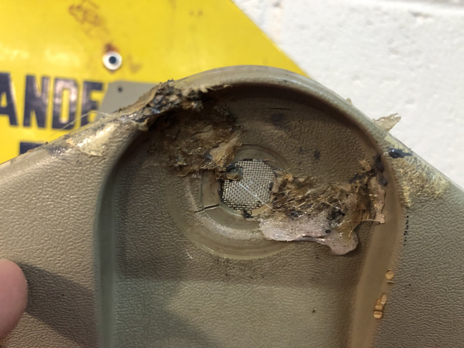

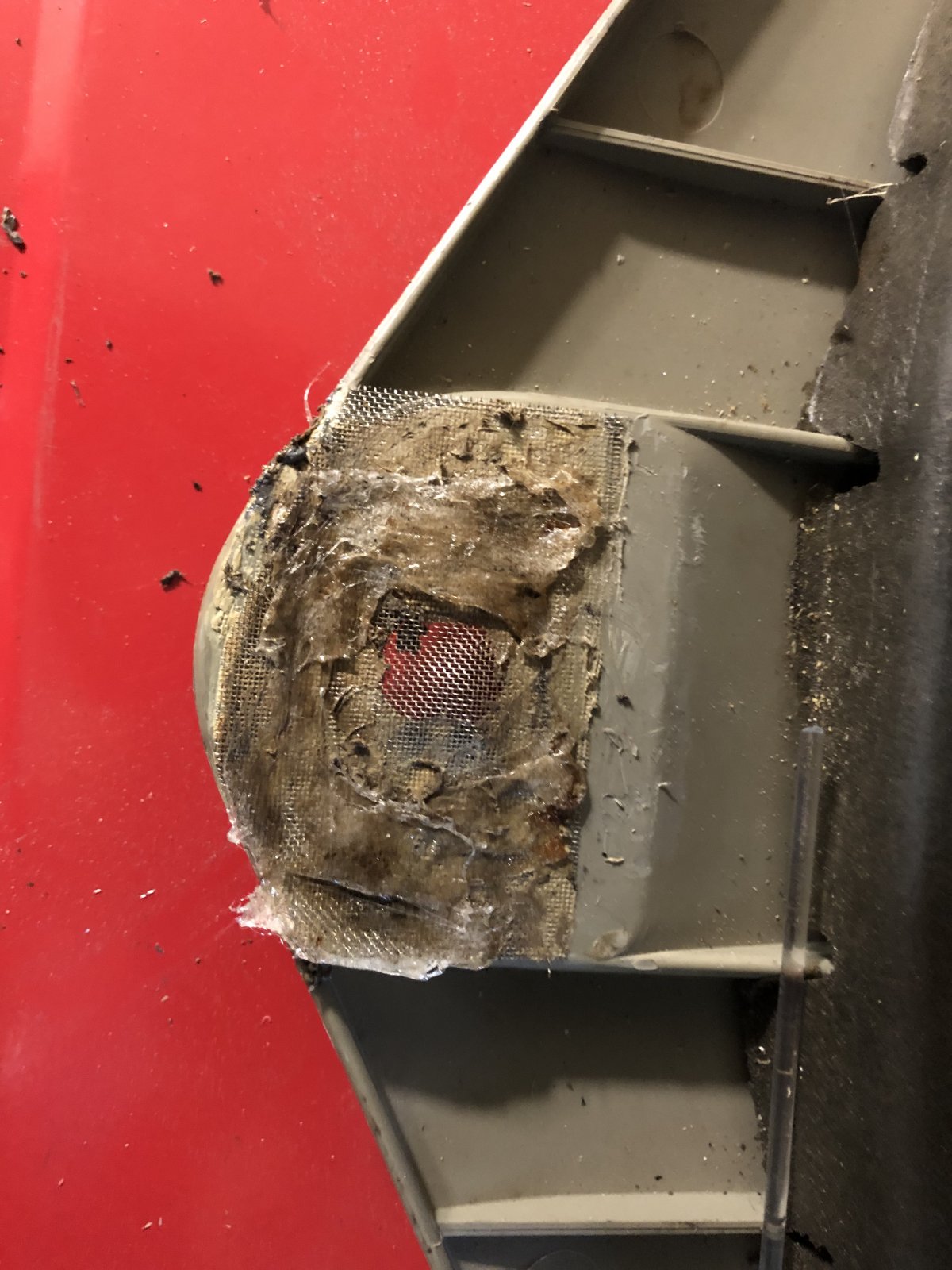

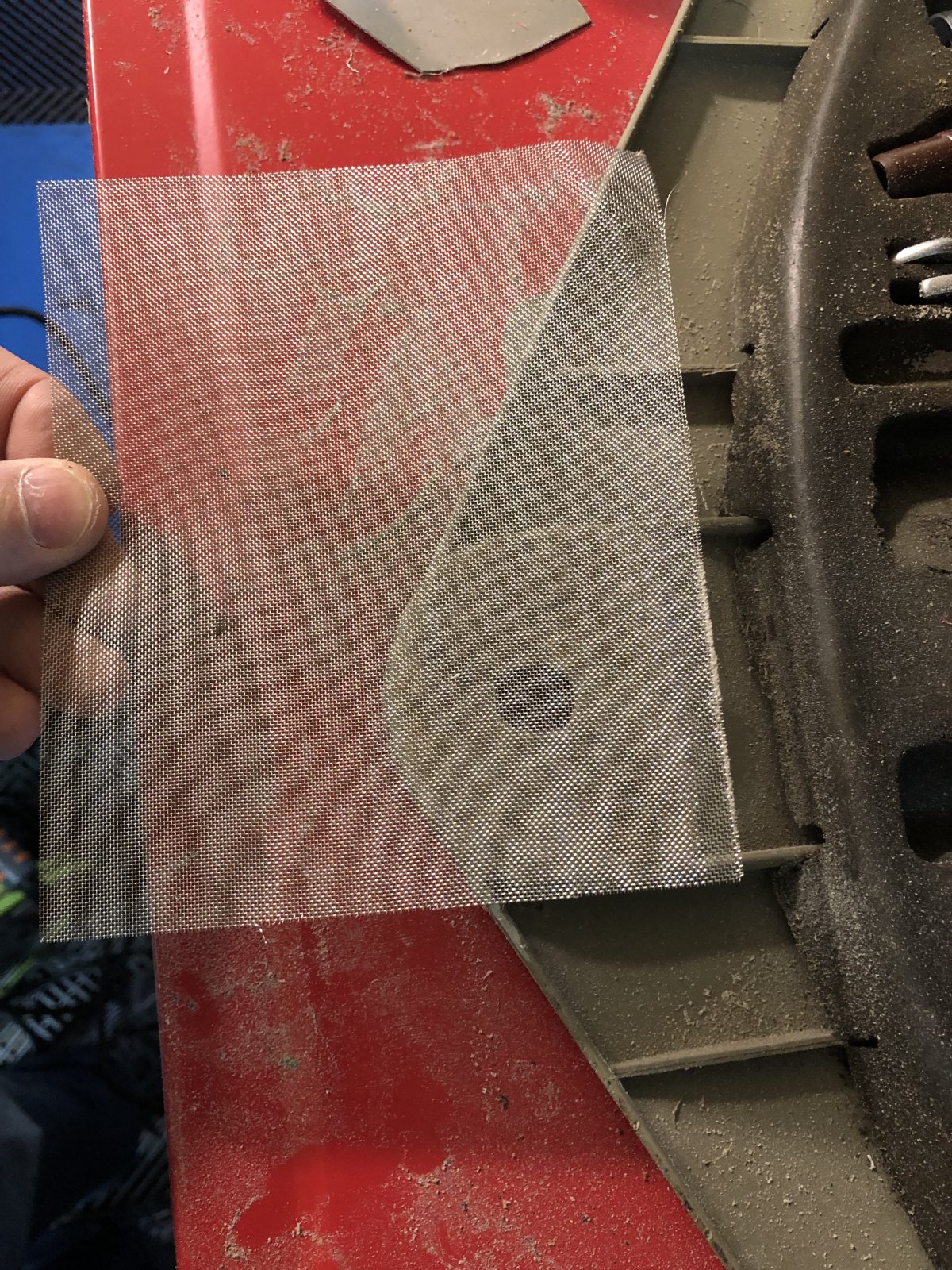

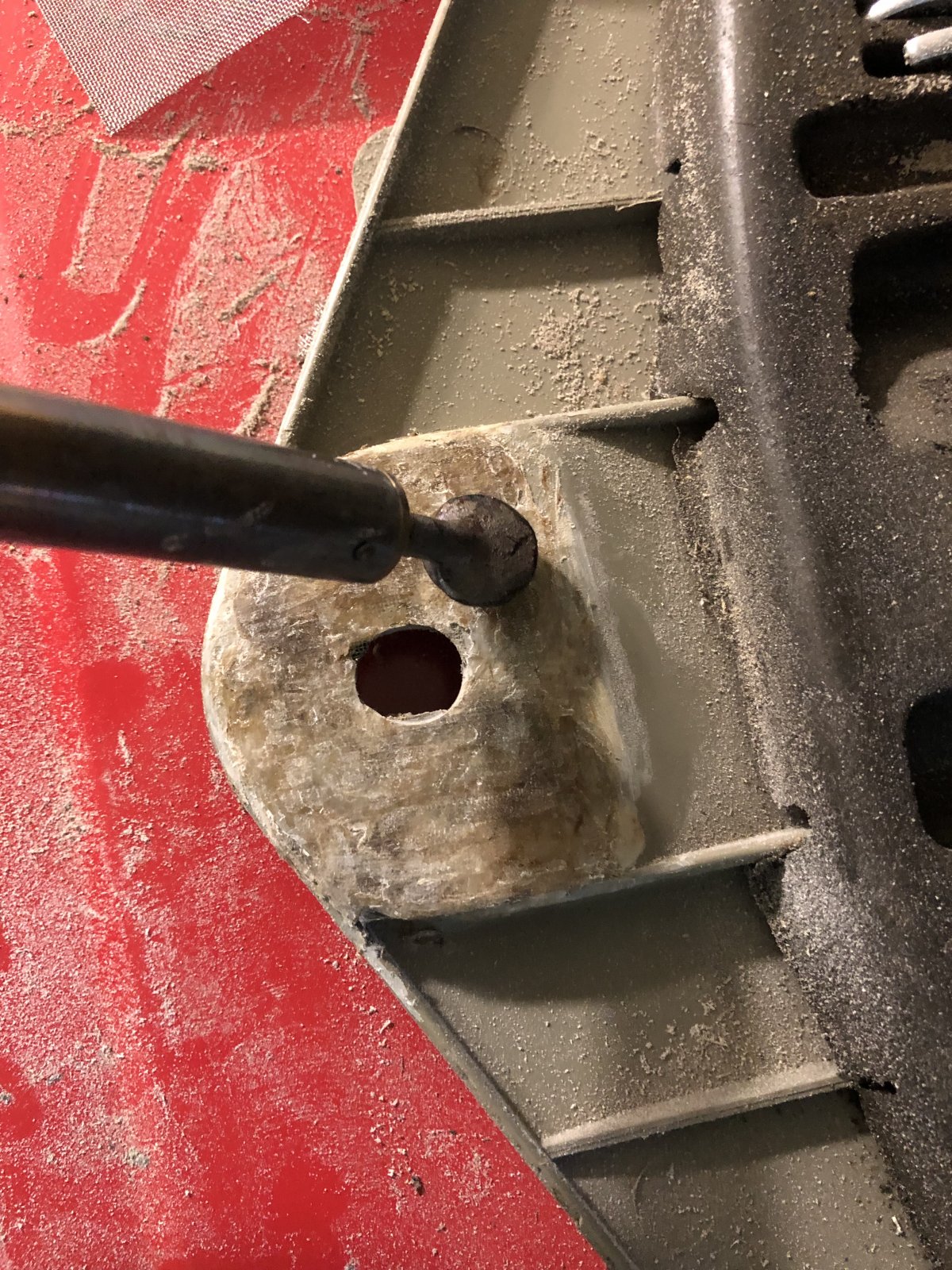

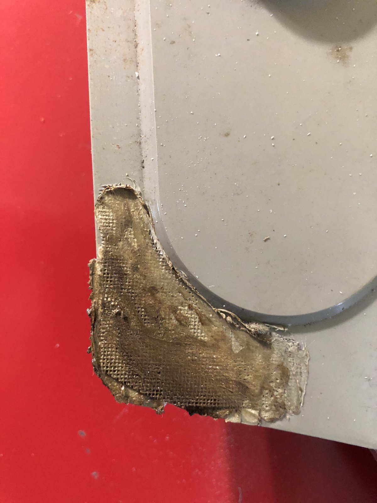

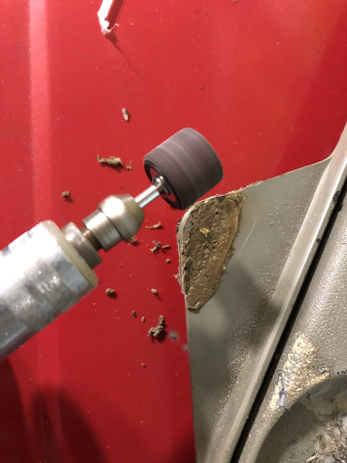

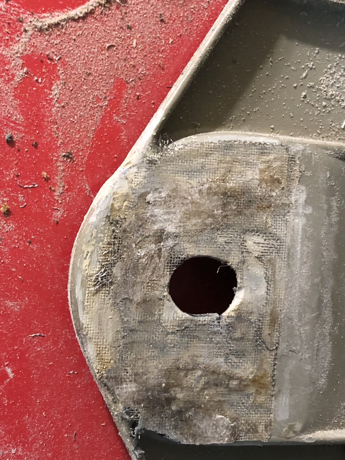

Ouch!
Nothing to lose with a project to try to repair it. I just made some repairs to mine using a plastic welding system and some fine metal mesh (think window screen sized) that I embedded in the plastic after it was heated.
Worked well (although on smaller areas), I will share some pictures shortly.
