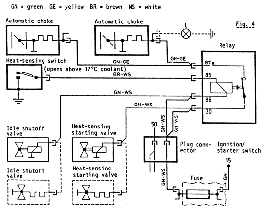

- Circuit diagram for electric heating of automatic choke on 3.3 L
- Circuit diagram for electric heating of automatic choke on 525/2500/2.5 CS/528/2800/2.8 L/2800 CS/3.O S/3.0 L/3.O CS

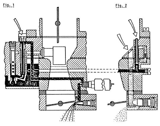

The air or mixture recirculating system
The conventional method of mixture formation at idle speed, with air entering through a varying gap at the throttle butterfly and a rich fuel-air mixture via the Idle system, can no longer comply with today's stringent anti-pollution laws. The controllable recirculating mixture or air system used on modern carburettors bypasses the throttle butterfly and thus greatly Improves mixture characteristics at idle speed and on the overrun. Since the throttle butterfly gap is now only Involved to a slight extent In the formation of the idle mixture, the carburettor manufacturer can set It to minimum flow on a carburettor test bench. No further adjustment is needed in the workshop. As a means of altering the engine idle speed if necessary, for instance when synchronizing carburettors, the air or mixture recirculating system Itself is used.
The preset throttle butterfly supplied by the carburettor manufacturer also ensures that the control passages for pneumatic ignition control and the transition mixture passages are brought into action uniformly and precisely as specified. This too has the effect of improving exhaust emission levels.

INAT 32/40 and 35/40 two-stage carburettors with mixture recirculating system
Apart from the mixture recirculating system and a few other minor changes, this carburettor is identical to the INAT without mixture recirculation. Apart from the additional mixture recirculating system, the carburettor still retains its conventional idling system (Fig. 1).
Fuel for mixture recirculation is taken from the float chamber, metered through a fuel jet and supplied to a bore into which the air correction pipe projects from the top. The pipe opens into the mixing chanter. In this bore the fuel and air are blended to form an emulsion. A jet governs the emulsion flow rate. The emulsion passes into a passage leading down and is there mixed with fresh air drawn in via the mixing chamber. The recirculating mixture regulating screw has a taper which alters the cross-section of the passage without affecting the basic idle setting (the airflow through the throttle butterflies, preset on the carburettor test bench). (Fig. 2.)
The fuel-air ratio remains largely constant at both small or large flow volumes, and complies with the exhaust emission regulations.
Adjustment of engine idling speed and carburettor synchronization while remaining within the exhaust emission limits for each carburettor (with exhaust probes 13 0 020 in both exhaust manifolds) must only be undertaken at the mixture recirculation regulating screw (for engine speed) and the mixture regulating screw (for exhaust emissions). Use the air cleaner simulator 13 0 000.
Warning:
The settings of the throttle stop screws must not be altered, or else the throttle butterfly gap and thus the airflow preset on the carburettor flow test bench for the basic idle speed will be lost.
The carburettor manufacturer supplies plastic caps to protect the throttle butterfly stop screws.

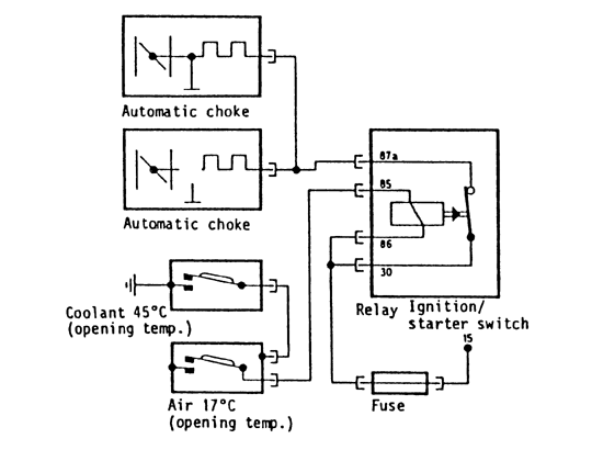

Circuit diagram for electric automatic choke heating - 3.3 L
Figure 3

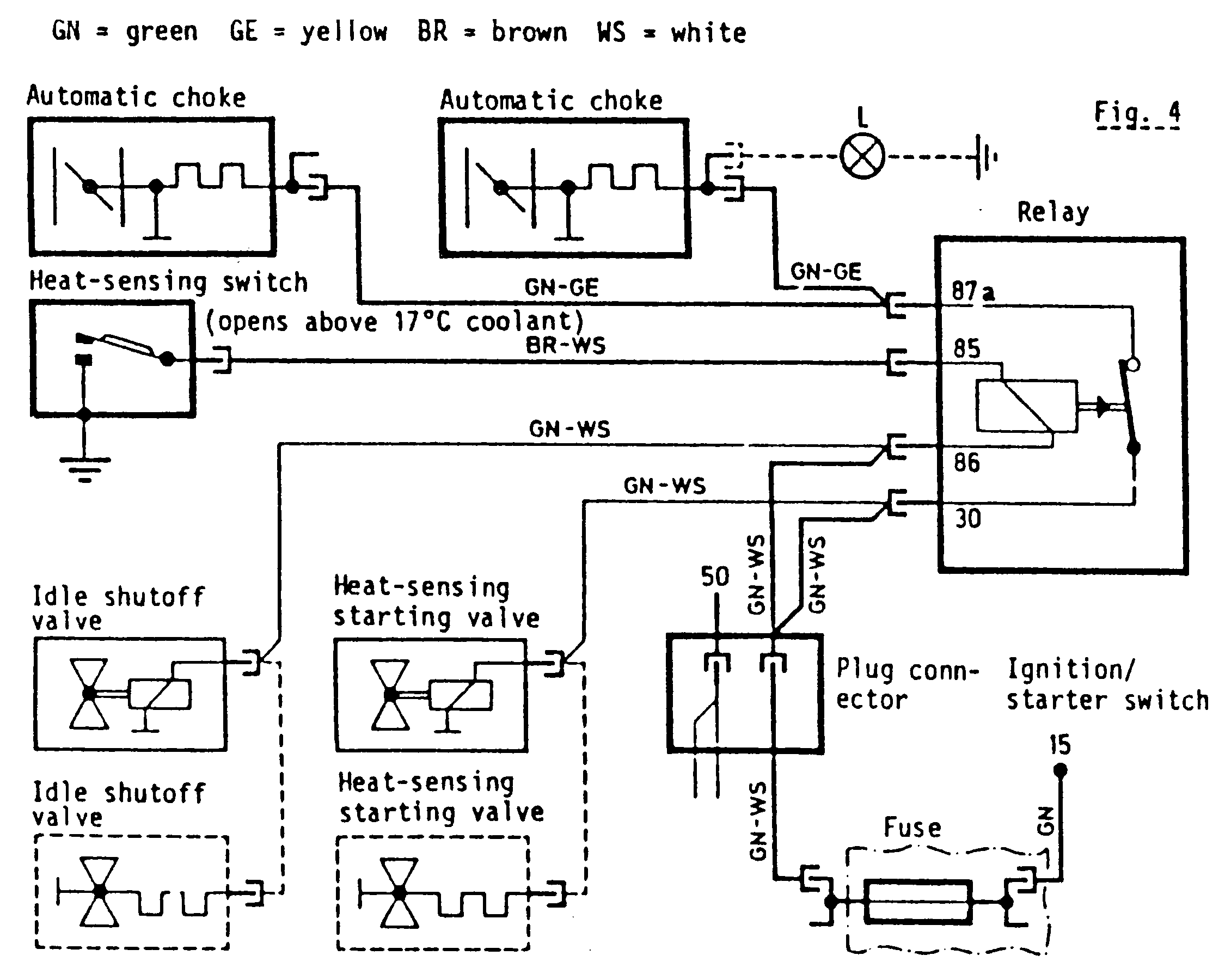

Circuit diagram for electric automatic choke heating - 525/2500/2.5 CS/528/2800/2.8 L/28OO CS/3.O S/3.0 L/3.0 CS
Figure 4

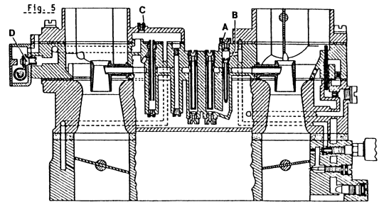

Additional improvements to the 32/40 and 35/40 INAT mixture recirculating carburettors
- Removal of Idle air jet "A", Idle fuel jet "B" and the air correction jet for heat-sensing starting device "C" can be carried out without taking off the carburettor cover (Fig. 5).
- When valve cone "D" In the heat-sensing starting valve is open, the device is no longer vented to atmosphere, but receives filtered air through the carburettor cover. This pattern of heat-sensing starting device Is installed on all mixture recirculating carburettors without TN starter system (Fig. 5).
Figure 5

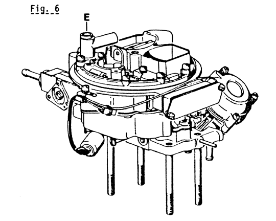

- The float chamber is now vented via air Inlet/outlet pipe "E" on the carburettor cover (Fig. 6).
Figure 6

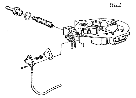

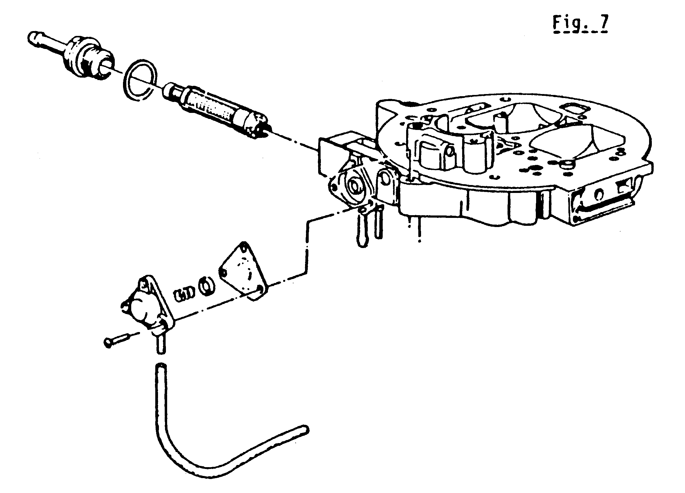

- There is an additional mesh strainer in the fuel supply line (Fig. 7).
- On the outside of the 35/40 INAT carburettor, a fuel return valve (Fig. 7) is installed on the fuel feed stub pipe on the bedplate.
Figure 7

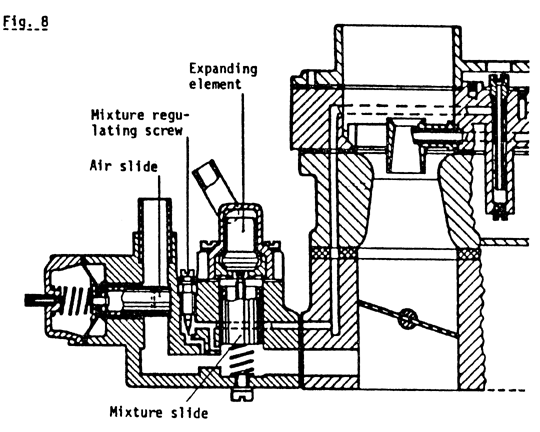

TN (heat-sensing bypass) starting system (Fig. 8)
The heat-sensing bypass starting system is flange-mounted to the front carburettor and is provided with a cross-pipe between the two intake manifolds so that it acts on all 6 cylinders.
The principal components are:
- the mixture slide valve, controlled by an expanding element
- the air slide, controlled by vacuum (manifold depression)
- the mixture regulating screw.
The expanding element is heated up as the engine's coolant grows warm, and alters the setting of the mixture slide: It closes the valve against the action of a spring as the coolant temperature rises.
The air slide opens, again against spring loading, when vacuum acts on the diaphragm, and frees the air passage.
Fuel for the mixture is drawn from the float chamber via a jet. Air flows in through an air jet and forms an emulsion by mixing with the fuel. In the air passage the emulsion is used to prepare the fuel-air mixture, and Is then drawn in via stage 2.
Figure 8

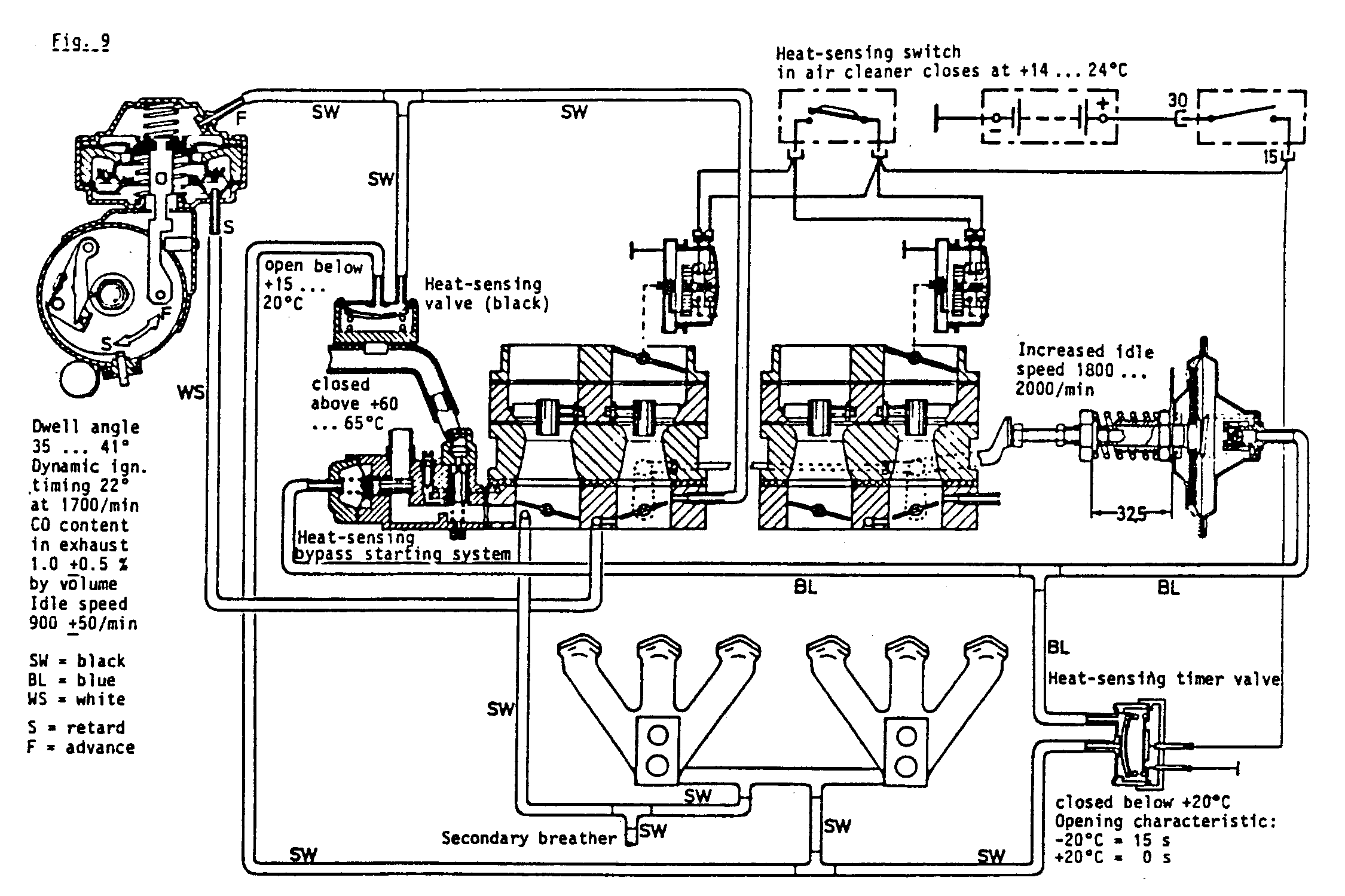

Heat-sensing timer valve (Fig. 9)
This is an open/closed valve actuated by a bimetallic element. It is electrically heated and opens after a period of time governed by ambient air temperature. Below +20° the valve remains closed and blocks the control vacuum from the intake manifold cross-pipe to the throttle butterfly adjuster and the TM starting system.
The electrical heating begins to operate when the ignition is turned on. The heating period before the valve opens is 15 seconds at -20&degC, reducing to 0 seconds at +20&degC.
Heat-sensing switch (Fig. 9)
This controls the electrical auxiliary heating for the bimetallic springs in the choke covers according to intake air temperature. At an intake air temperature below 14 ... 24° the switch is open. Above 14 24° the switch closes and the auxiliary heating element Is energized.
Heat-sensing valve (Fig. 9)
This responds to coolant temperature and controls changeover of ignition control (vacuum) from 'retard' to 'advance'. The valve is open below 15 20&degC, so that the vacuum control tapping from the intake manifold cross-pipe can reach and act upon the 'advance' can at the distributor and alter Ignition timing accordingly.
If the same vacuum is present at both the 'advance' and 'retard' cans, preference is given to ignition advance.
Above 15 ... 20° the heat-sensing valve is closed and ignition advance and retard are controlled by vacuum in response to throttle butterfly movement.
Operating principle of carburettors
Cold starting and warming-up (Fig. 9)
The vacuum-controlled throttle butterfly adjuster maintains the throttle butterfly at a predetermined opening angle. This enables the vacuum (partial manifold depression) developing below the closed choke butterfly when starting a cold engine to take effect - in the mixing chamber Ä and cause fuel to be drawn out of the main jet system. At the same time a richer mixture is drawn in via the TN starting system.
Vacuum in the mixing chamber acts also on the closed choke butterfly, overcomes the spring loading exerted by the bimetallic spring and opens it sufficiently for the air needed to form the starting mixture to flow in. As soon as the engine has started the vacuum-actuated pulldown opens the choke butterfly to a preset gap, to help prevent an over-rich mixture from developing.
The control circuit vacuum can act via the intake cross-pipe and the open heat-sensing valve on the 'advance' can of the distributor and thus advance the ignition.
When the cutout time of the heat-sensing timer valve is reached (15 s at -20°C), the valve opens. The control vacuum from the intake cross-pipe then acts on the throttle butterfly adjuster; the diaphragm and adjusting plunger are pulled up and the throttle butterflies revert to the idle position. At the same time the vacuum takes effect at the TN starting system, pulls up the diaphragm with air slide, opens the air passage and weakens the rich starting mixture.
The air inlet in the open air slide of the TN starter, together with advancing of the ignition, ensure that engine speed does not drop too far and improve cold-engine running.
The correct mixture proportions for the engine warming-up phase are supplied - according to the vacuum below the throttle butterfly Ä by the idling system (consisting of the idle mixture and additional mixture systems) and the TN starter with its own mixture system. The mixture slide of the TN starter, which is actuated by the coolant-heated expansible element, regulates the mixture volume in accordance with engine temperature. When a coolant temperature of 60 ... 65°C Is reached, the mixture slide valve is closed and the mixture system out of action. Mixture formation for engine idling is then limited to the normal idle and additional mixture systems.

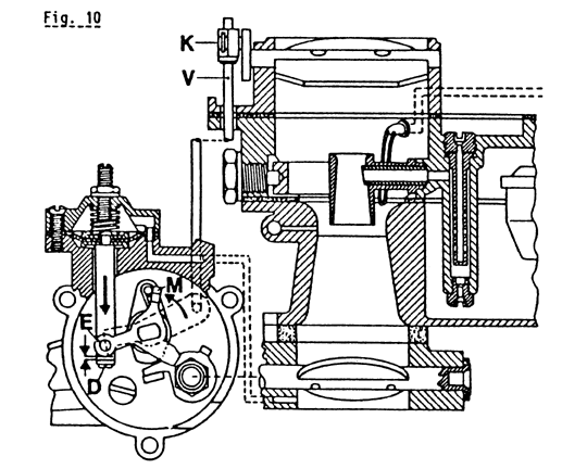

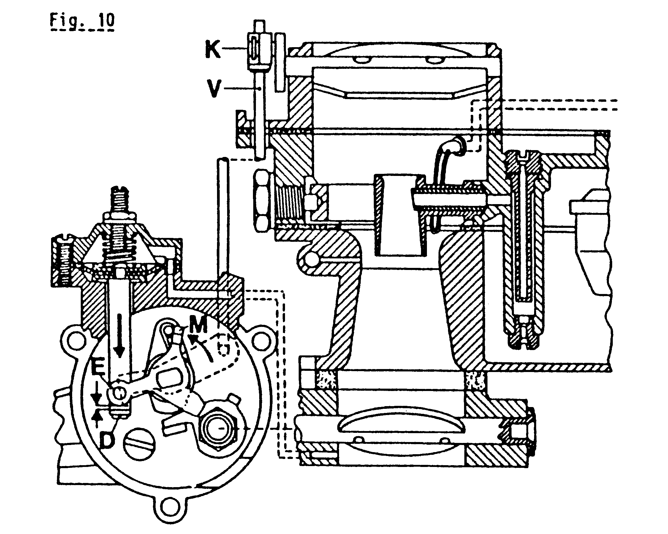

Adjusting the starting system connecting rod (Fig. 10)
- The starting system (choke) cover must be detached
- Turn actuating lever (N) to the left; with the choke butterfly closed there must be a gap of 0.2 ... 0.5 mm between the actuating lever (E) and the pulldown rod (0).
- Adjust if necessary at clamp bolt (K), by moving connecting rod (V).
- Push the clamp ring up against the clamp block until no play Is present.
Figure 10

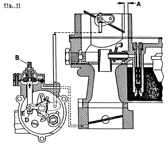

Adjusting choke butterfly opening angle (Fig. 11)
- Press diaphragm pull rod (0) fully upwards, move eye (E) of actuating lever against it and check that the choke butterfly gap A is 2.5 &plusmn0.2 mm at the lobe of the butterfly which points down.
- Adjust if necessary at stop screw (B).
Figure 11

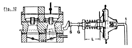

Adjusting increased Idling speed (Fig. 12)
The engine must be at normal operating temperature, the dwell angle, ignition timing, idle speed and CO content of the exhaust to specification and the spring preload at throttle butterfly adjuster I a 32.5 mm.
- Pull off the vacuum ignition retard hose and block at carburettor end.
- Pull off vacuum hose "1" at the throttle butterfly adjuster, and block. Do not accelerate after this has been done.
- Slacken locknut (G) and turn screw (5) for the throttle butterfly adjuster until the increased idle speed is 1800 ... 2000/min.
- Reconnect vacuum hose "1", then detach it again and check that the increased idle speed has not altered. Repeat the adjustment if necessary.
- Re-attach vacuum hose "1".
- Re-attach the vacuum ignition retard hose.
Figure 12

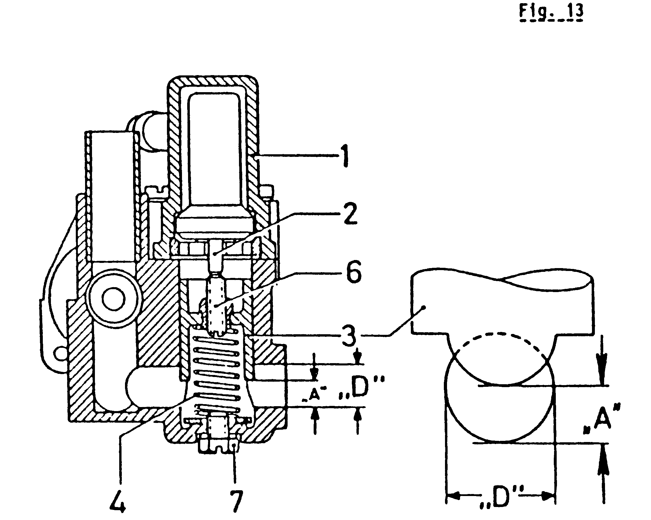

Adjusting the TN starting system (Fig. 13)
If a control plunger (3) or water connecting cover with expansible element (1) has to be renewed, the TN starter must be adjusted again as follows:
- leave the TN starter unit in a water-bath at 20° +3° C for 10 minutes so that the temperature stabilizes.
Note: there are two available diameters "0ø Ä note when adjusting.
- If diameter "D" is 6.4 mm, gap "A" must measure 3.1 mm.
- If diameter "D" is 9.0 mm, gap "A" must measure 4.4mm.
- Check with a twist drill of 3.1 or 4.4 mm diameter.
- Must at the plunger adjusting screw (6) after detaching the screw plug (7).
Resetting of the TN starting system during routine inspection or maintenance work Is neither necessary nor permissible. The mixture ratio (fuel-air) and the. flow rate related to plunger stroke are set up on the carburettor flow test bench.
If the mixture regulating screw of the TN system has been disturbed, coarse adjustment is as follows:
- turn the mixture regulating screw fully to the right, then unscrew to the left for two and a half full turns.
Figure 13

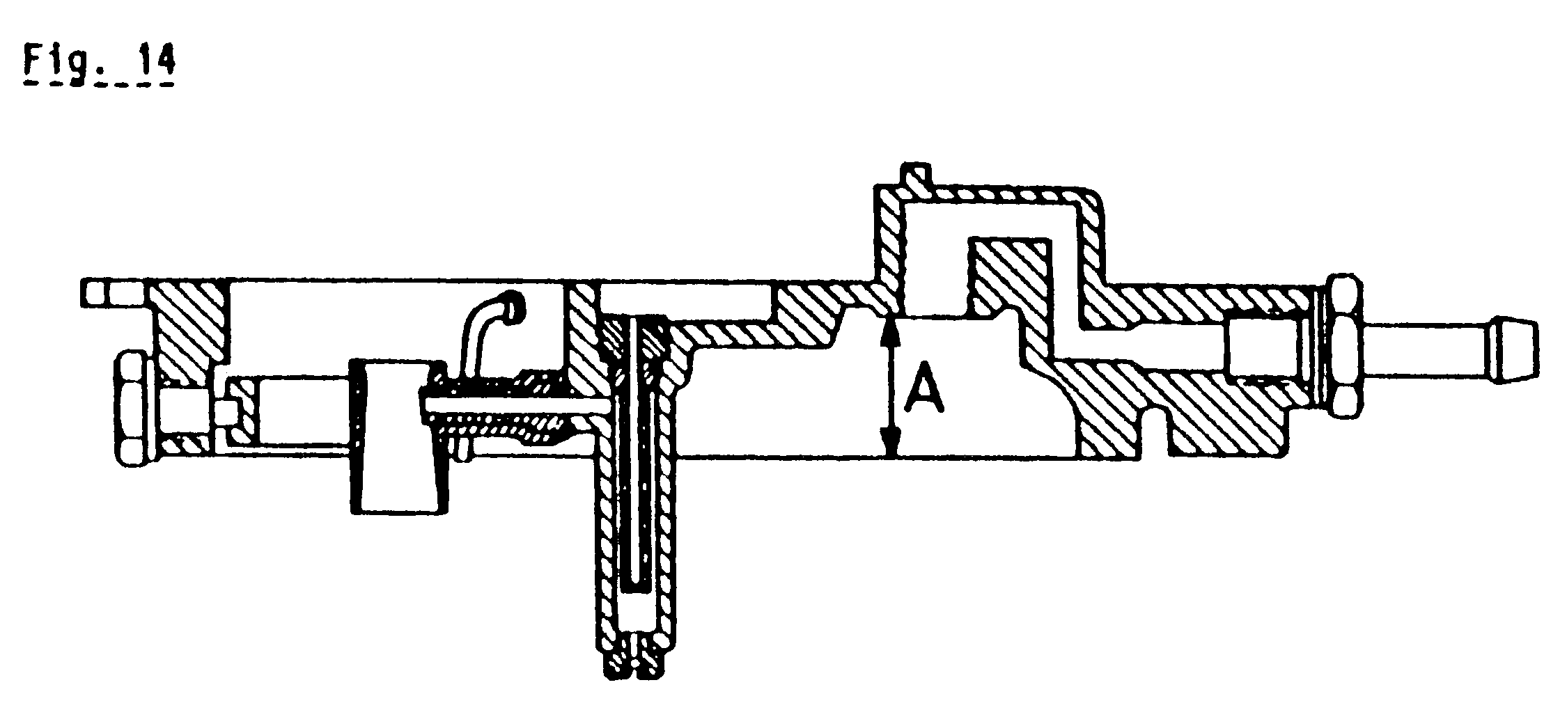

Checking fuel level in float chamber
The fuel level on all INAT 32/40 and 35/40 carburettors is governed by distance "A", measured from the joint face of the bedplate to the contact face of the float needle valve (without gasket) (Fig. 14).
This distance should be as follows:
INAT 32/40 20.5 ... 21.0 mm
INAT 35/40 19.0 ... 19.5 mm
If the measured distance is within this tolerance range, install a I mm thick sealing ring between float needle valve and bedplate.
If the actual distance is out of tolerance, correct by altering the sealing ring thickness. Before the measurement is taken, the float mounting must be in good working order.
Figure 14

INAT 32/40 and 35/40 with mixture recirculating system and TN starting system
Dwell angle 35 ... 41°
Ignition timing, dynamic, without
vacuum advance and retard
22° before TDC at 1700/mm
CO content 1.0 ±0.5 % by volume
Increased idling speed (with throttle
butterfly adjuster)
1800 ... 2000/mm
Normal idling speed 900 ±50/min
Note: to determine increased idling speed, detach vacuum ignition retard hose and block at carburettor end.
