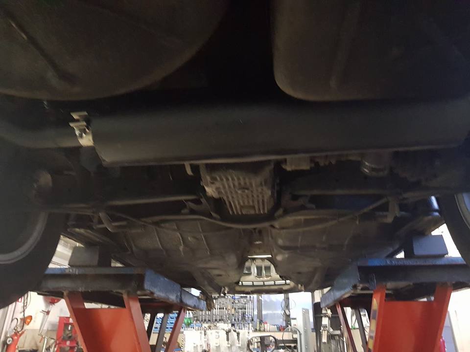

Then I was able to take her down the street for the first time. Differential was noisy, rear exhaust was leaking and there was some not healthy noise from suspension. Also no power window was working, lights weren’t working and wiper motor wasn’t working.
Took out window motors clean them, grease them and they start working, but probably they will need to be replaced eventually. Removed wiper glass motor cleaned away rust and grease it – works now.
Also I replaced headlight connectors and bulbs now they are working. Also I replaced sway bar bushings and there is no strange noise anymore.
I had rear steel exhaust made (not happy with it will replace it when I will be putting stainless steel exhaust system on).

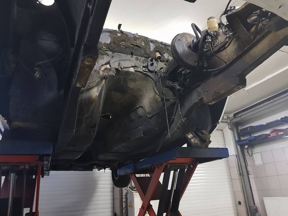

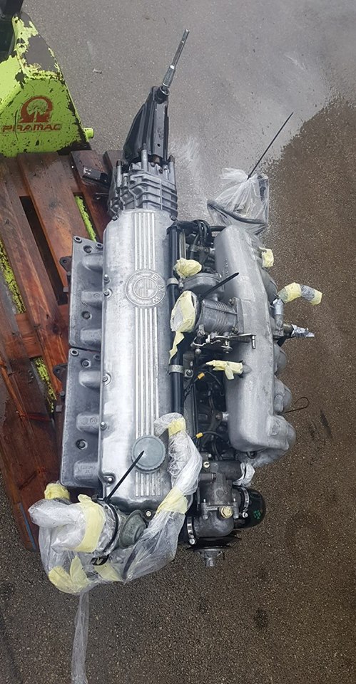

Messy paint job under the hood bothered me so much I decided to take the engine out and have engine bay re-done.
RTHLSS1
415
296
Slovenia
Before I towed her to paint workshop I removed carpets and seats to drive them to auto fabrics shop to have them repaired and replace upholstery. Also they will make me new floor carpets and trunk carpet.
Also I removed heater box and heater core since it was leaking.
Removed differential as well to have noisy bearing replaced.

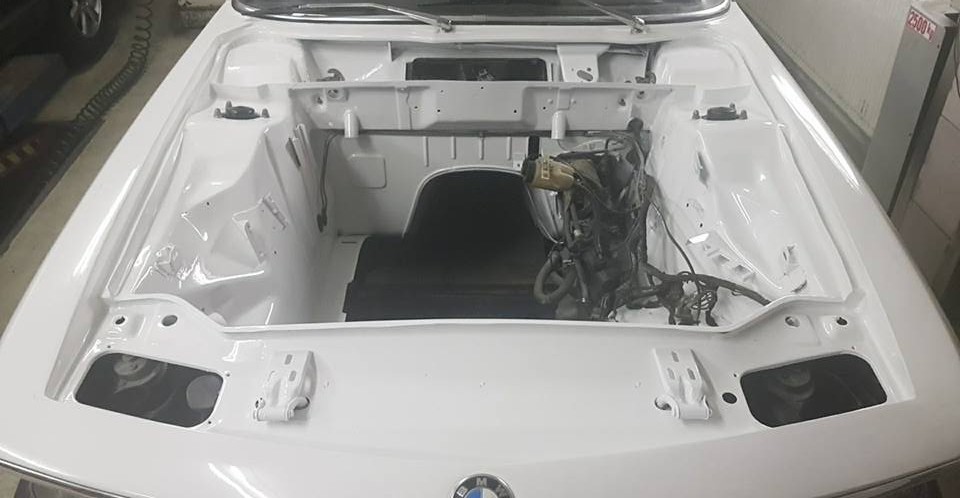

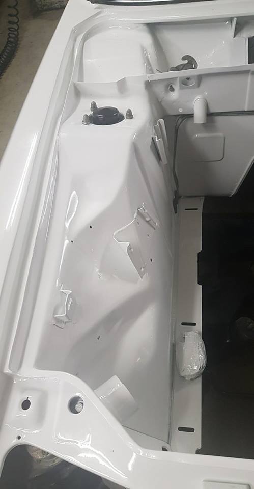

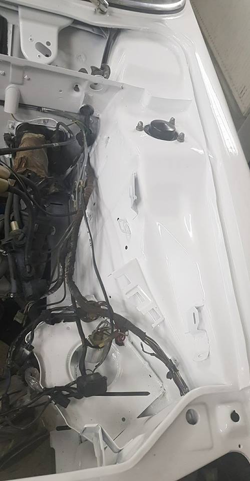

A few days ago I got her back from body workshop and I like engine bay now:
c159465ae56aa8a61ef6dae377f35784-jpg.37862
2bf3167dd197fa8466cfa1c66e26cabc-jpg.37863
7415c7132f59bae58ee1c7d5657fad01-jpg.37864
Waiting for some hoses to come to replace them before putting engine back in.
I am thinking of sandblasting valve cover and paint it in black and polish of BMW sign and stripes but I have doubts about doing it
Don’t know what to do with air intake that it would look tasteful. Cleaned it as much as I can "polishing" wouldn’t last long....
Any suggestions?

Looking good ... am going to have the engine taken out and get the whole engine bay sprayed , like you have done in a few weeks ..
Keep you the good work ...

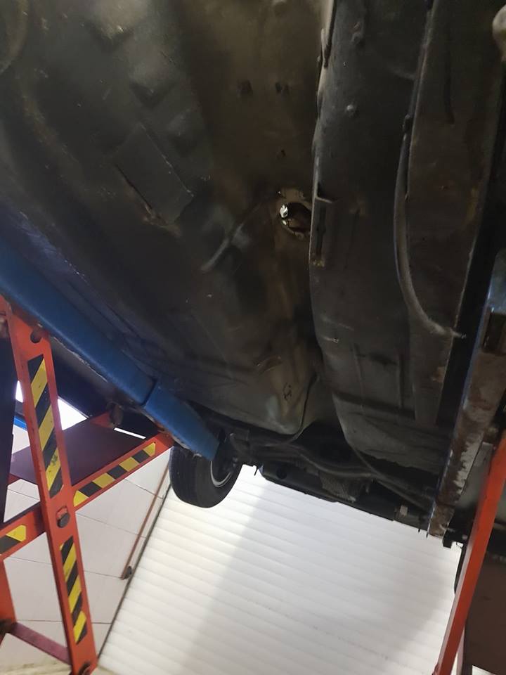

Also I find some rust spots on rocker panel where car is being lifted - will take it to body shop to sort it out before spreading.
