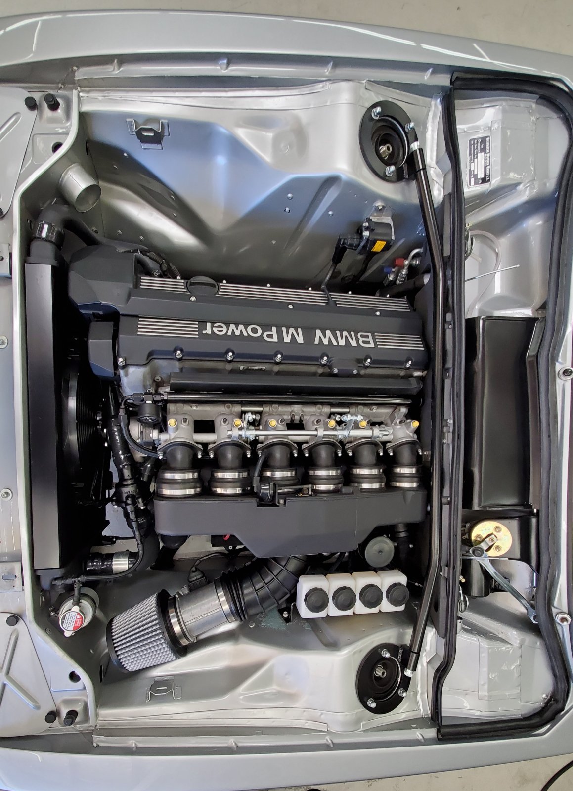

I love my s38 conversion and for normal street driving the power is incredible. I cannot imagine 311hp damaging or twisting this car at this point. I did do the rear diff strengthening braces as well as front and rear strut/shock tower bracing. The car is not brutally fast by any means, it's not peaky either, just a smooth linear power curve. Power feels like my 85 911 Turbo which also makes 300 hp and is in a chassis that is no stronger than the coupe.

Other than the purchase cost, the S38 install is very straight forward with no modifications necessary other than using the correct oil pan and pump. My S38 was rated at 311hp and when cats are removed and air flow increased and chipped to compensate, they have been dyno'd at 340-350hp. I do also appreciate the look of the engine in the bay as well. To me, the S38 looks cleaner and more at home than the CSi engine. Of course that's just my opinion and I am a little short sighted:)
That is one beautiful engine bay. Well done!
Very elegant and clean !
