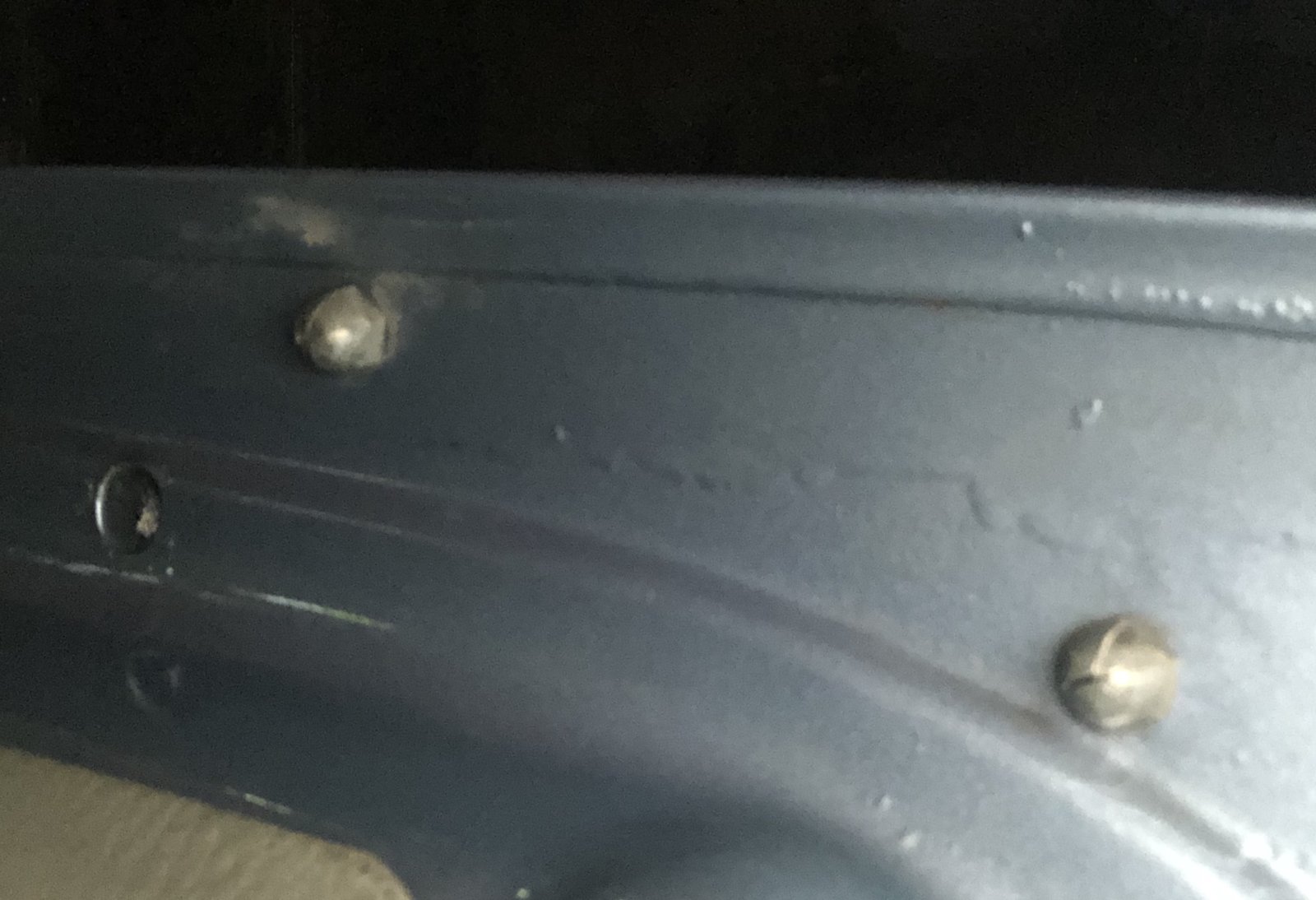

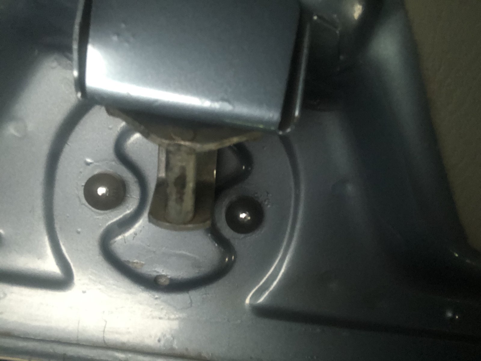

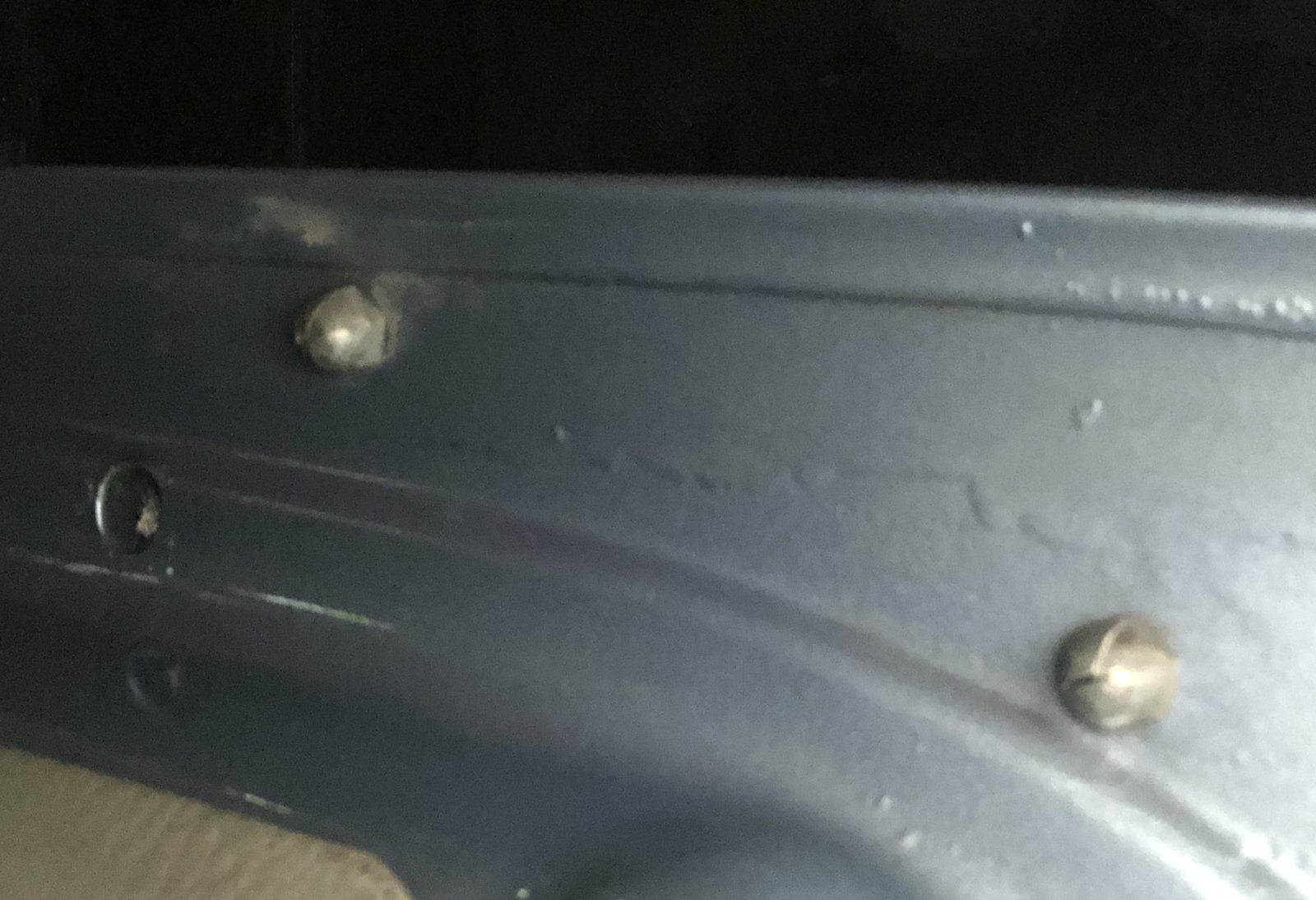

-Does anyone have a suggestion for removing and installing 2800 CS emblems?
-My current emblem has hollow posts, and I‘m not sure the best way to loosen them up from the inside - pic below.

Current emblem posts:

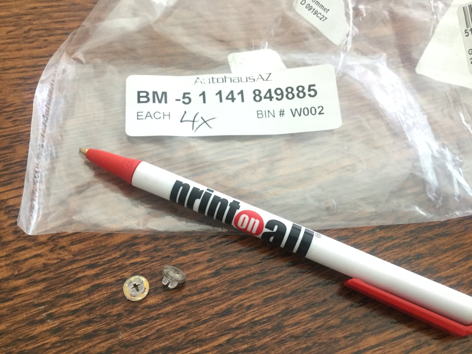

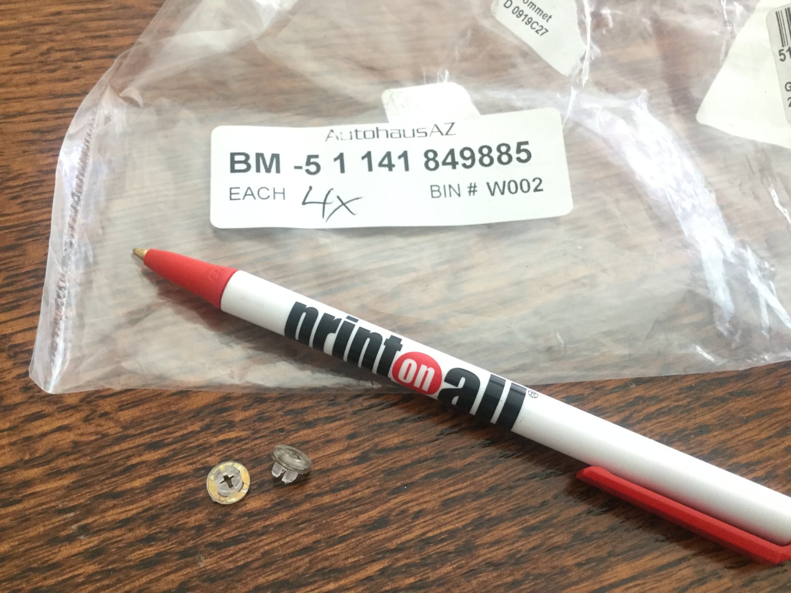

Those hollow posts look peened to keep the trunk badge tight. I'd use a fine nail set to tap it out or drill the ends very carefully.
New badge should have longer posts. Can use speed clips, hard rubber grommets or small acorn nuts.

Thanks Scott. Looks like Chris will be sending the fastener/sleeve info.

Thanks Andrew. Will try to tap them out with a fine nail first.
You’re right, the new badge has longer posts. Great info - much appreciated!
