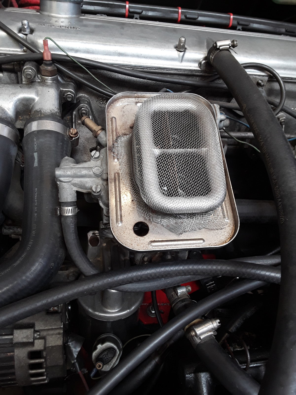

your air cleaner will sit closer to firewall
Huh. I never realized it was because of my 38/38's and I put them on! The latch closest to the firewall is difficult to use because of the clearance. As far as the carbs go, they work fine but I think my stock 2.8L can't take advantage of them. They seem to just make more noise but the car doesn't go any faster. Jets maybe. :(

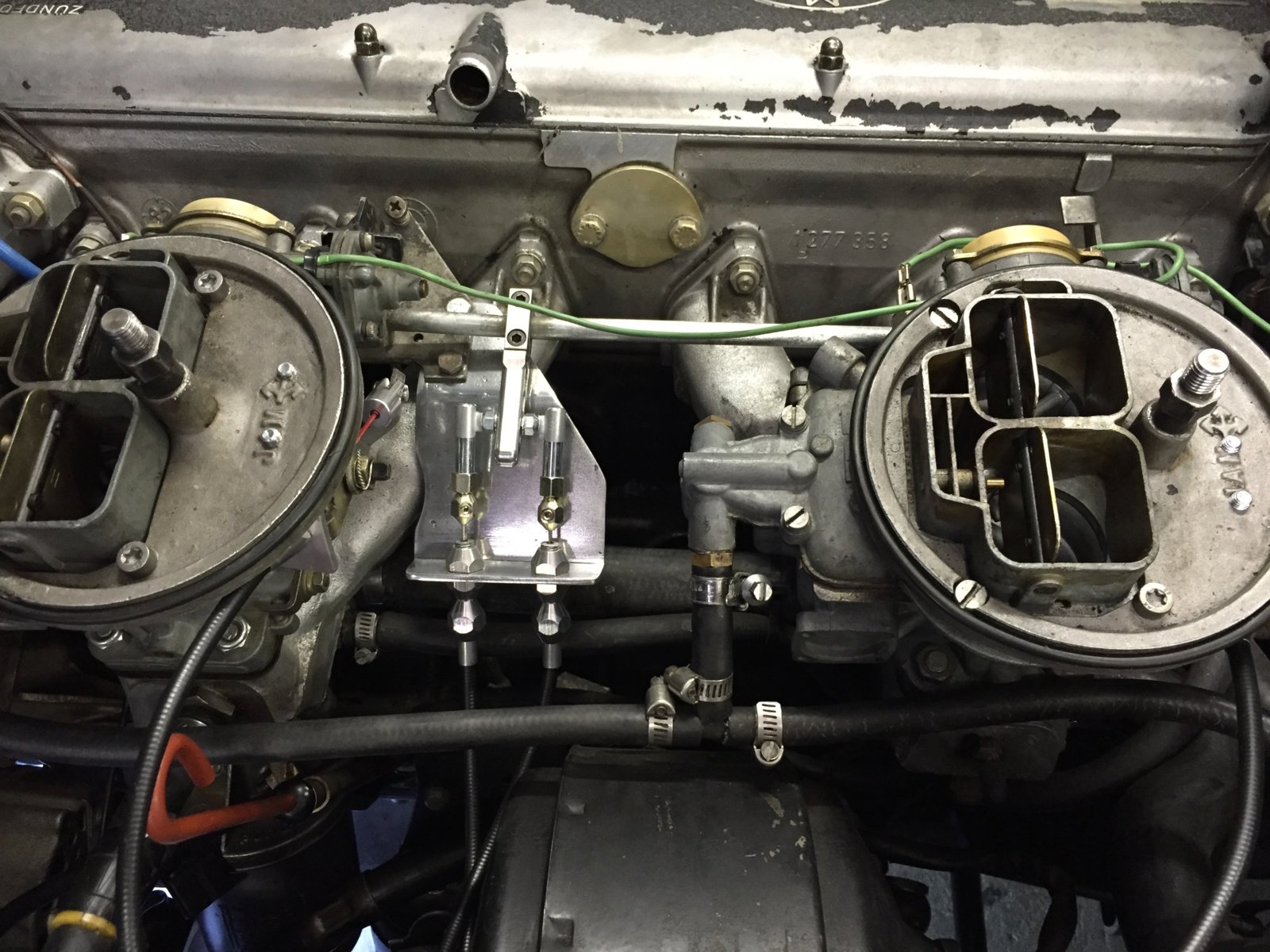

What's that second set of cables going to the carbs? I'd guess they were manual chokes, but see the electrical choke actuators on the far sides (in the photo) of your 38/38's.
There are only two cables one to each carb from the linkage.
Well, it's your car and I guess you would know. But in the photo below, I'm seeing four, black-sheathed cables: Two come up from below and connect to the accelerator linkage. And then two more seem to come in horizontally, one to each carb, have a red inner cable and connect to an aluminum ferule. I'd guess that this second pair is for the choke, but your 38/38's seem to have electric chokes.
img_1940-jpg.63714
In this pic it may be easier to see the route of the cable.
