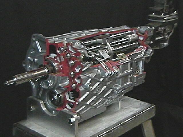

Despite all of the above cautions, the noise you hear is probably related to the bearings on the input shaft
(e.g. 23121204580) and/or the layshaft. Both bearings are available. For someone who has worked on Getrag 4-speeds, this is highly doable. "Specialists" routinely rebuild the ZF 6-speeds and Getrag differentials found in some Corvettes http://www.rsgear.com/products/transmissions/race-performance/c5.aspx , but finding one to work on your transmission may be difficult and not inexpensive. Nevertheless, this does not guarantee against finding other internal parts that deserve replacement. Mechanics who intend to remain in business would have difficulty replacing just mainshaft bearings, knowing that the synchros are very worn (but functioning), due to the likelihood of future repairs.
You might be able to nurse the transmission by switching to a heavy gear lube. This may quiet things down, but result in greater shifting effort and less effective and possibly even advanced synchronizer wear. Worn parts usually do not repair themselves. When a bearing cage disintegrates, or you loose a bearing, hopefully the mechanical debris will fall to the bottom of the case or stick to the magnetic fill plug without kissing the gears. For all of the potential aggravation and cost, you might want to carefully consider the 5-speed conversion.
