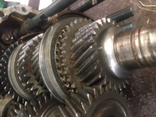

Got the transmission apart and yes the 3rd gear syncro is shot. Further there is severe corrosion on the gears which not sure if this can be salvaged? Any opinions?

Can't really tell from the picture Is the gear pitted at all ? Looks like the damage has gotten into the gear face of the bevelled area If that is the case,.it is toast
Unless you can find a gear shop that can do something like a spray metal that would be ale to be hardened to withstand normal use Better check the slider hub and the dog teeth as well Are any other gears like that one?

If that baby is not salvagable, I would try Al Taylor (Bavman) for a replacement.

I want to think that surface corrosion MIGHT just grind itself into the trans lube with time, meaning you'd need to change the trans lube a couple time. But how far the grind will go, and what will be left, can't be determined from the picture.
When I acquired and installed a used 265, it howled a bit at first. I was advised to just drive it; the noise went away after a little while - maybe some weeks, we don't go far here.
If your opinion is such that a trans R&R is not a significant effort because you have the time and tools, then it may come to pass that you've little to lose by driving it, perhaps while keeping an ear out for another 265. I have a friend with one, but we're in Hawaii and there would be shipping to address. Trans R&R gets easier with practice, but be safe under there, okay?
At any rate, you're in for a synchro ring replacement, and parts that may be difficult to source may determine your path forward.
