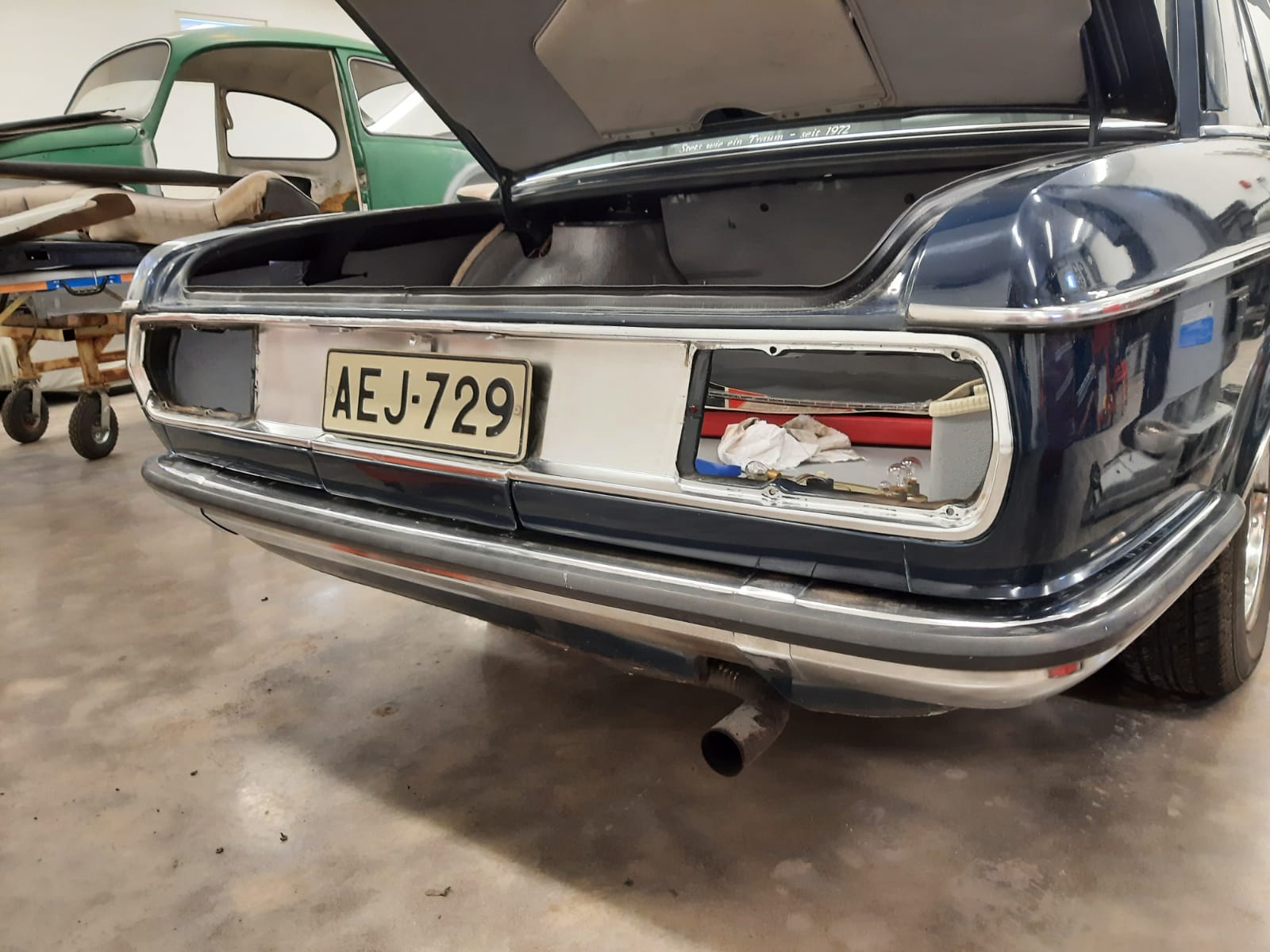

Today we removed the rear lights because they had the light output of a weak candle at best, unfortunately the gaskets were horrible and now looking for new ones, does anyone know if they're available anywhere? I couldn't find any at the usual places but I'll try the dealer tomorrow.
Part #'s should be 63211353739 and 63211353740.
The reflectors were shot, so they're getting the polished aluminium tape treatment, and a high output set of bulbs from @Mo Brighta

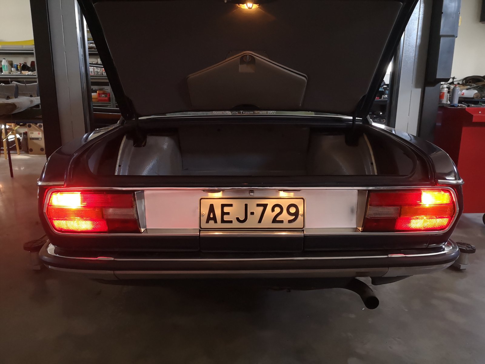

Today we got the rear lights finished with the aluminium tape mod on the reflectors and a good cleaning of the lenses. Also been tidying up other stuff on the rear end, and also cleaned the inside of the four Hellas in the front - turned out like new, they were a little bit foggy before. All the grilles got a good cleaning as well.
It wasn't easy to see if the rear lights + brake lights were turned on in regular daylight before, they were so dim.
Now they're working as they're supposed to - what a difference! Can't wait for the high output bulbs to make this even better :cool:
