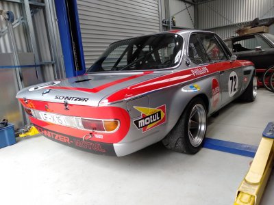

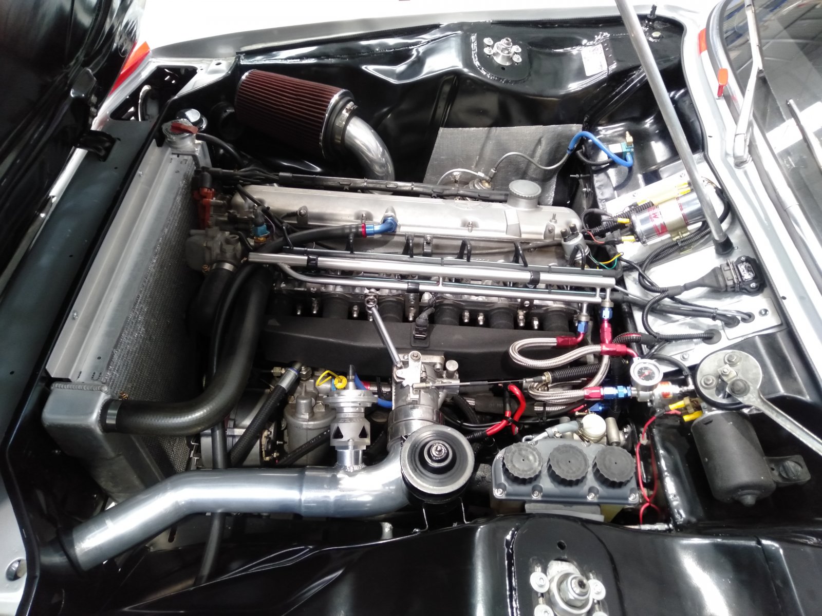

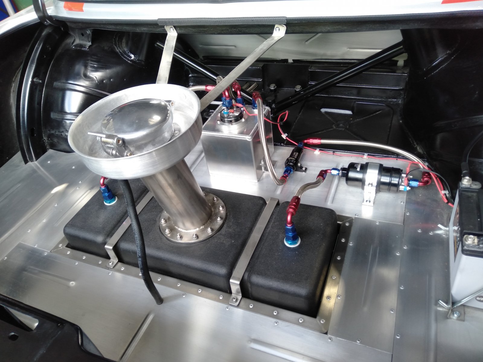

Just finished (if you ever can) a period type club racer. Its been a lot of fun putting it together, and I will debut next week at the Skope Classic meeting here "Down Under" in Christchurch New Zealand. IMG20230112144240.jpg

What engine/ running gear have you got on her ?

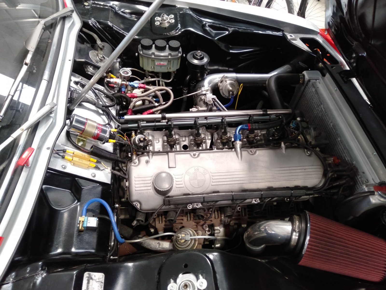

Period type AP closed calipers all round, coil overs front and rear, spherical bearings etc.
M106 tickled up a bit producing 420hp on the deck. I have plans to build an NA screamer on triple Webers at some stage, but the turbo unit will do the trick for the moment.
Body has been extensively lightened and stiffened, weighs in at exactly 1200kgs.
