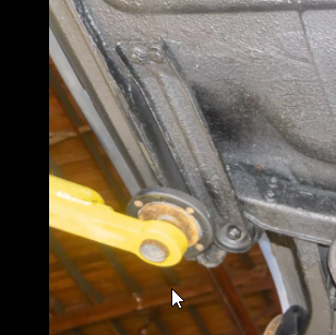

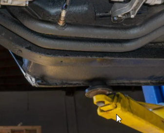

and typical example of bad lifting: this wasn't necessary! (the lower edge of the outer panel gets 'crimped' around the inner sill that sits just behind it; you can't undo that deformation easily):

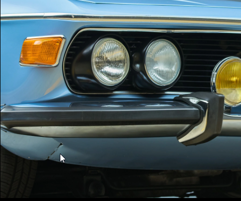

also done on the front:

It always amazes me that someone thinks they can lift a 3,000lb car by some 19 gauge sheet metal. I get nervous just lifting it by the 14 gauge frame rails. I'm making a cradle to help distribute the load and contain the outward forces.
