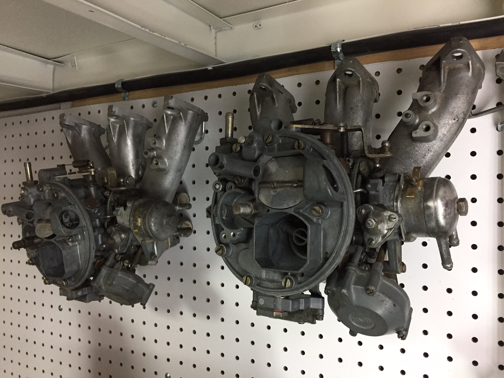

I started with the carb rebuilds and intake cleaning..just some light work to ease back into the game...If you look closely, you might be able to see a little grime on the intake manifolds and carb..
Nice...
There they are cleaned up and rebuilt...not for a show car, but still nice..
