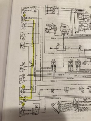

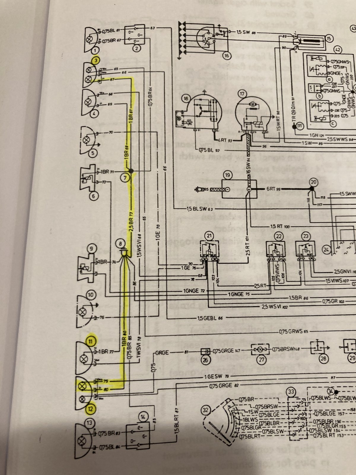

The biggest issue keeping me from driving the Bavaria is I have only one head light when the low beams are on; but all 4 turn on when I switch to high beams. I am attaching the wiring diagram with my simple understandings. Is this just a ground issue?
Right low beam not working. Left low beam works. All four light turn on when I switch to high beams.
Mind you, the person who last worked on the electrics for this car followed no rules and kinda butchered the wiring harnesses.

Your lo beam has two filaments, the low one can be burned out. You can swap left to right or buy a new one or test with a multimeter.

Ok. So I didn’t try swapping but did pause. Bought some new lights, which are not equals, and replaced the light with suspected burned out partial filament. New light has the same problem. High beams work. No low beam. Appreciate insights.
