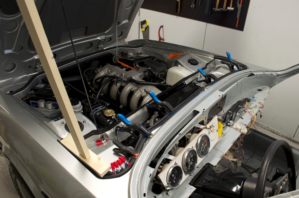

Fully agree with Alan. Not easy to obtain, and it is expensive, but I don't think I could get along without at least one can on the shelf. I used it on the seal Mark99 is referring to. Some along the straight rear section, then did the curved sections a few inches at a time, and used some clamps to hold it firmly. Waitehd about 24 hours between sections to let the previous Wurth rubber glue set up. Still perfect 3 years later.
