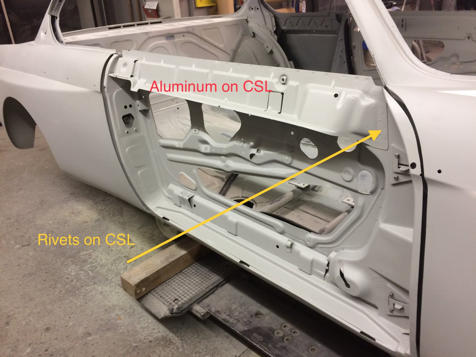

I believe that @Gransin reskinned his doors himself. Not sure if aluminum though.
Before you go through the effort, keep in mind that the door support and hinges are big contributors to the CS vs CSL door weight.

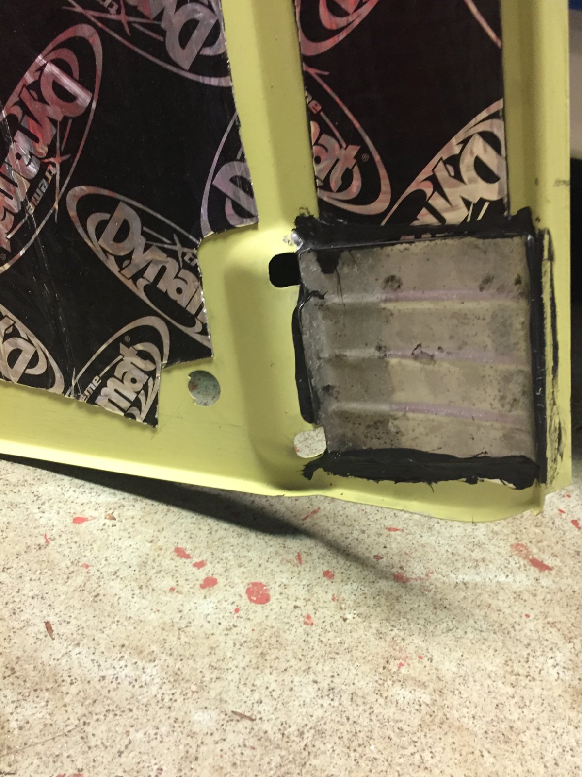

i did mine - but there is one extra bit you need to add to the door skin just over the handle , its bonded in to position .... also when i did mine not only did i paint the edges i used aircraft paint primer on the inner skin, and i used thick ptfe tape over the lip ( about 0.3mm) as a barrier to stop the galvanic corrosion...
and as my car was a UK CSL city pack it had sound insulation......if you wonder why i have done it
