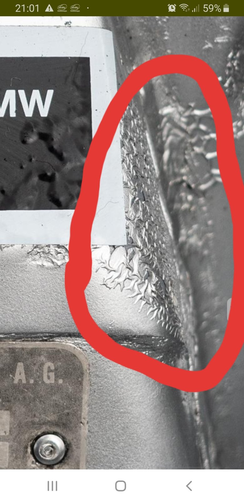

Is it me, or the paint seems a bit messy at places:
Nop, quite right. Especially here you can are that the paint reacts with another chemical that dissolves it.
It can be a non matching underlying layer (wrong base paint or fatty substances will do this), but it can also be a materials on top that dissolves it; A solvent, but also brake fluid will do this.
It is actually how it looks after you apply paint stripper.
For sure the paint with flake if you wipe it. It has no protective effect at all.
I for one would not want to buy such a car, without factoring in a bare metal respray; how can you trust that the rest will be still ok next year?

Good eye. It's also a little strange that they would apply a sticker over the top of this bad area and not notice or care.
