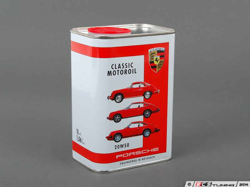

It is true that some oils marketed in Europe may exceed most US Manufacturer's lubrication recommendations, and, in some instances offer a wider range of multiviscosity oils but they do so at a significant price increase and may not offer any significant lubrication advantages for street operated M30 engines.
And, if all else fails and you are concerned about voiding your new car warranty . . .

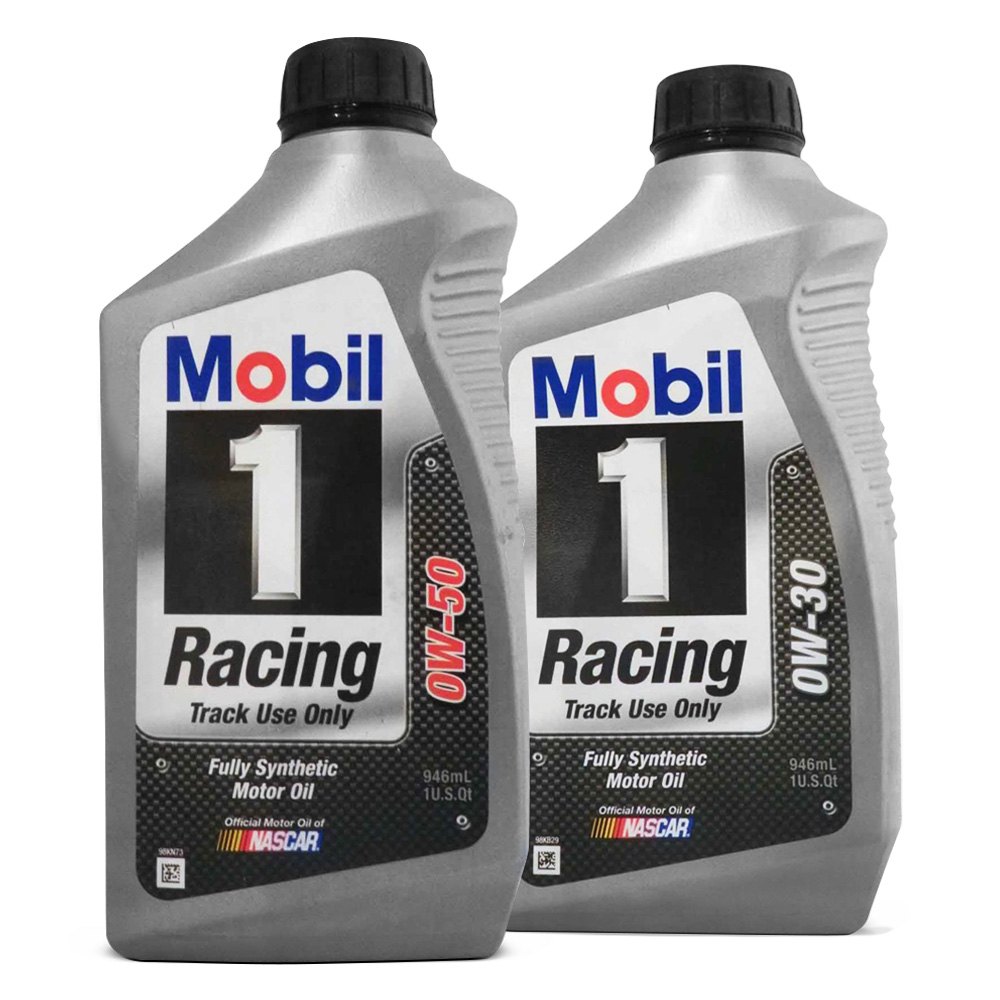

Scott, there are some old threads on the site that are worth reading. it has a lot to do with the internal engine components and the clearances that require certain viscosity oils. there is a reason that BMW suggested 20w 50 oil in our coupes ... and a reason that Porsche uses mobil 1 - 0w40 in their current engines ... no idea what BMW is currently using.
