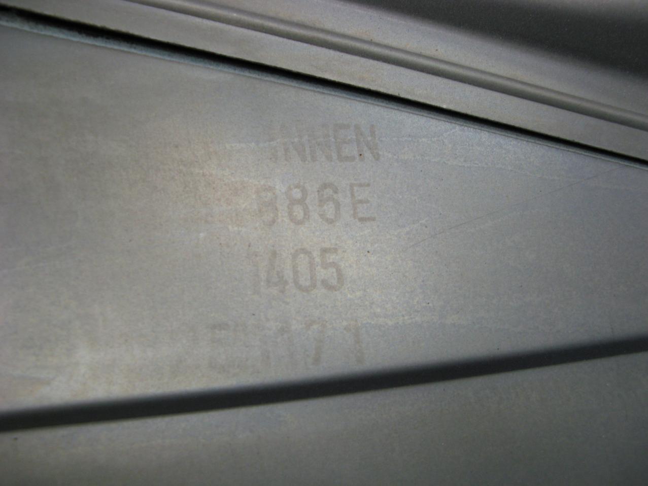

The shop that stripped my car used plastic media to remove the paint and used garnet only in areas where there was rust scale which were fortunately only a couple in the floors and one in the trunk.
This photo is one of my favorites so far. It is the underside of the hood and if you can make out the faint lettering, I surmise it is the information from the steel manufacturer that was applied before Karmann stamped the panel. I believe only plastic media would have removed the paint and left that behind.
As others have said, find a business that blasts cars for restoration. They might also do industrial blasting but they'll know the difference.
