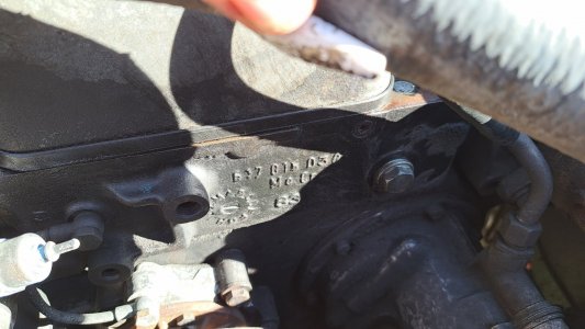

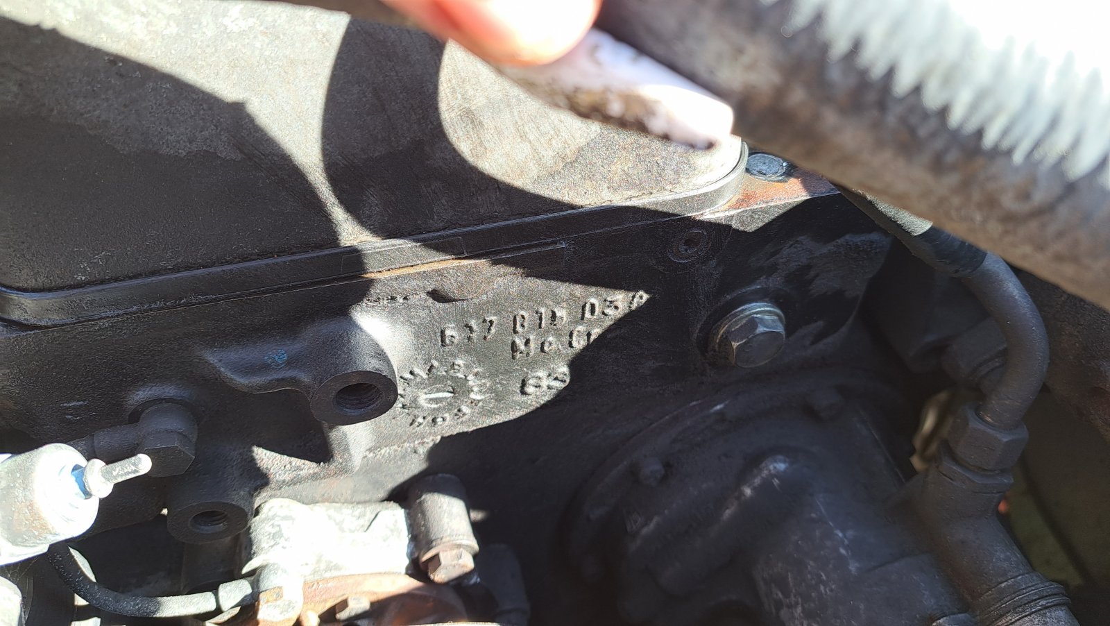

Specifically early 80's OM617(a) units. I'm starting at zero and learning what I can. There's an "A" at the end of this number. Does that mean it's an OM617a?
I think the “A” in OM617A refers to the turbo charged version of that engine.
No “A” is normally aspirated.
However, I’m not knowledgeable.

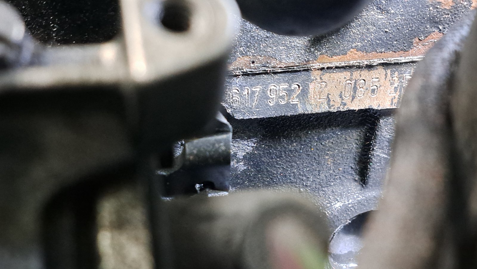

I found the number on the block. 617.952 so it's the typical turbo motor in the 80's 300D. That's a good thing since you can still find them in self-serve wrecking yards. The one around the corner from me has one and I need the upper and lower oil pans. Hopefully they're still there.

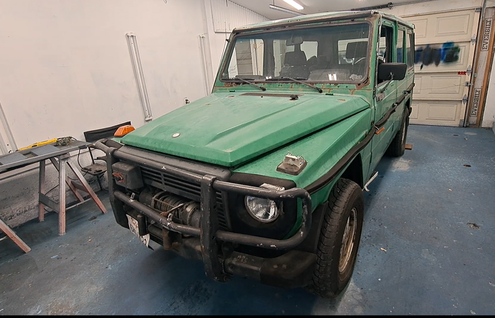

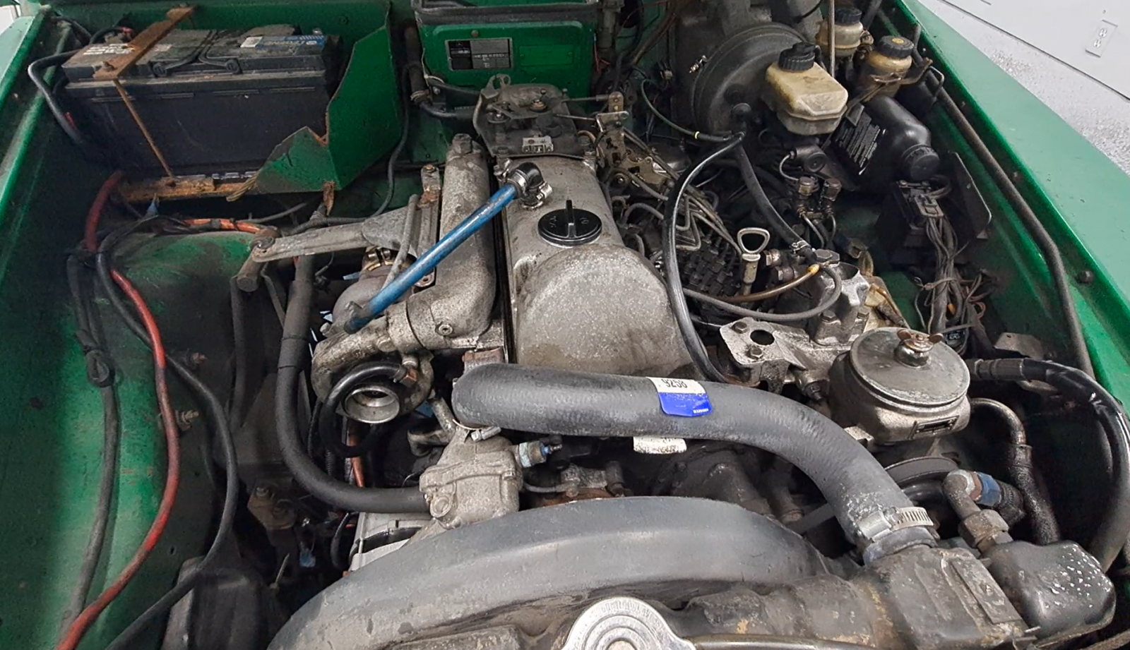

Well, I kinda did get a wagon. A G-wagon. 1979 300GD 4spd. It's actually a 280GE (gasoline) and someone swapped out the diesel at some point in it's past. Runs and drives better than expected but needs a TON of work both mechanically, electrically and mostly rust repair. Unfortunately I have several projects in front of it so it's getting parked for a while.
(images taken from a video)

Niice. If it starts, twist the oil cap on the valve cover and let it sit. If it rattles and you see lots of oil vapor blowing, then there is blowby.
Hopefully you don't see that. oversize pistons are unavailable. If you find them, please let me know. I have a clean, resleeved block that
got bored out just a skosh too big.
Fresh fuel lines including the "cigar", the 2 filters, and a tight, new primer pump are key to smooth running. Also, there's a filter
in the tank pickup that might be gunked with algae.
Besides the oil pans, the oil filter housing where it attaches to the block and the turbo return line where it attaches to the top pan are likely sources of leaking.
