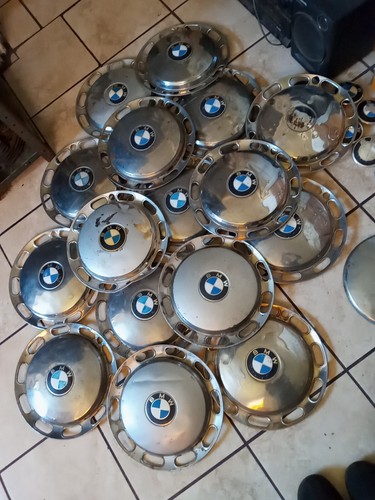

Are these desirable hubcaps for e3?
autokunst
3,499
2,505
Milwaukee, WI
Looks like what is on our 1968 1600. I am tempted, but what am I going to do with this many hubcaps. Anyone want to go in on it in my general area (SE Wisconsin, Chicago area, midwest)?
Dick Steinkamp
2,041
2,374
Bellingham, WA
Well, I think that TYPE is exactly the right thing for an E3...but then I'm prejudice. ;)
However, those in the eBay link appear to be for a 1600/2002 and at least the trim rings wouldn't fit an E3. I guess there is a chance the caps might fit since both an E3 and a 1600/2002 take a 10" cap. @Christoph would know for sure.

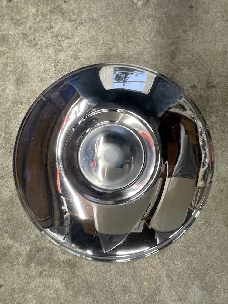

Hubcaps for E3 and some E9 models (e.g. 2.5CS) are two-part.
Center part (the cap) is stainless steel and the ring is made of thin, fragile aluminum (anodized or chromed).
There were at least two versions of rings used in E3/E9. One with flat surface (as on @Dick Steinkamp picture aboe) or pressed reinforcements (as so far on my avatar picture) but probably one official shape of the center cap. And they are for 14 inch wheels of course.
Both are delicate and frequently damaged due to lack of proper tool or improper use of the wheel nut level (with a hook riveted close to 90deg. bending).

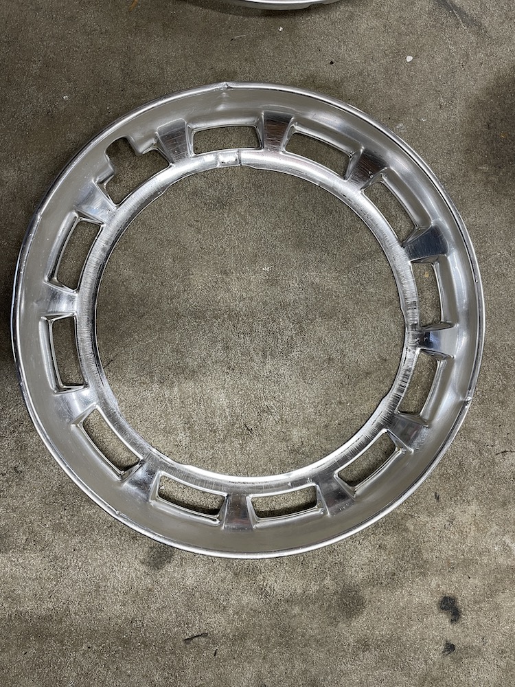

Here are the type of E3/2.5 CS trim rings that are on my car...

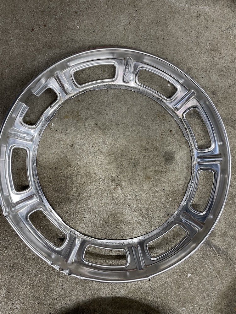

Here is the other style (like yours). I believe them to predate the above rings but I am not sure. In any case, both are super delicate. I'm surprised any survived. I have seen the results of one guy thinking the E3 caps and rings were one piece. He destroyed all four rings tring to remove them as one piece before he realized they were not. I'm sure others have done the same.

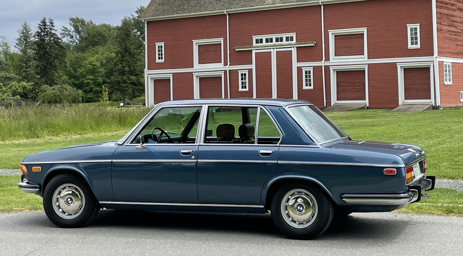

As to @Stevehose title question "Are these desirable hubcaps for an E3?"
I'd have to say no...at least not today in North America. BaT has listed 36 E3's. 6 have the caps and trim rings (about 15%). I would say the use of caps and rings on the total population of E3s in North America is even less than that. Probably mostly due to the fact that the stock steel wheels and caps/rings were thrown away in the 1980s when lots of OE and aftermarket alloy wheels became available to personalize/update cars.
