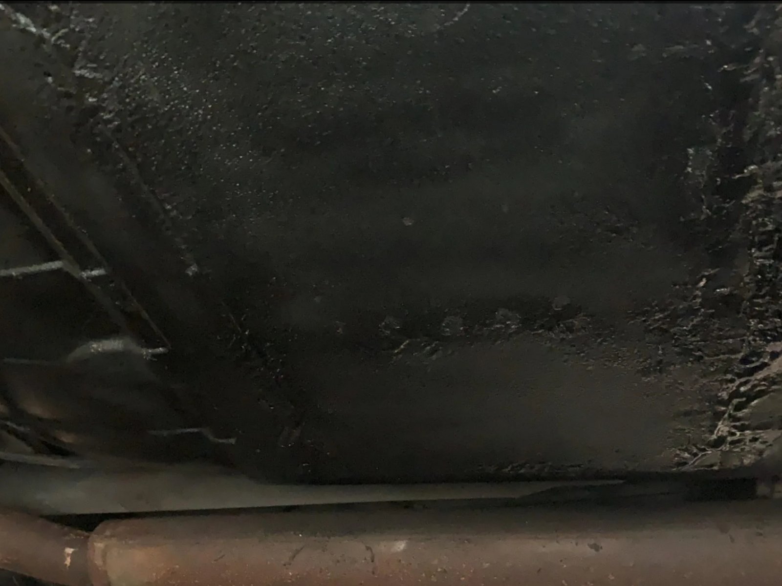

NMNA: We should find out what a nice US bumper automatic e9 brings at auction. The dash wood seems lighter than factory 74 cars. Pic #87 shows what looks like a patched floor.

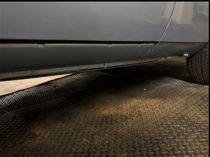

Clean sills!

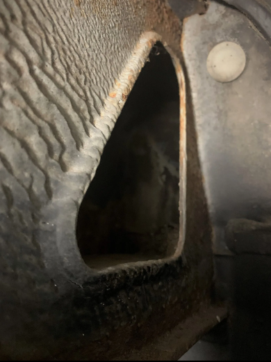

and the pandorra's box: (inner front fender rust trap): no bubbling that I can see. Ofcourse some rust will hide in the seams, but it looks to me very OK.

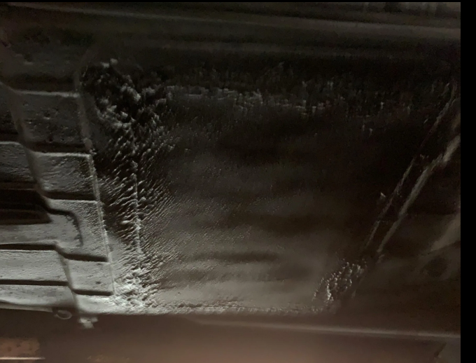

This is looking to me as a very decent car. A few bolt-on things are missing or incorrect, but the skeleton looks to be pretty OK. And as that is the most difficult to fix, I'd seriously consider (visit/PPI & check) this car if I was in the market.
As noted above; both rear footwells have been replaced with flat sheet metal, not the best of work but easily fixable for a purist, as it is independent from the fjord paint surface; blending this in won't be an issue:

Ya, those floors would bother me, so I would definitely replace those w/some Mike Pellys.
But the rest looks good. Budget another $5-7k for chrome bumper conversion, CN springs to lower that front, and another $5k for the floor work and hopefully no rocker work needed.
Then...another $6k-$8k for 5-speed conversion if one is so inclined.

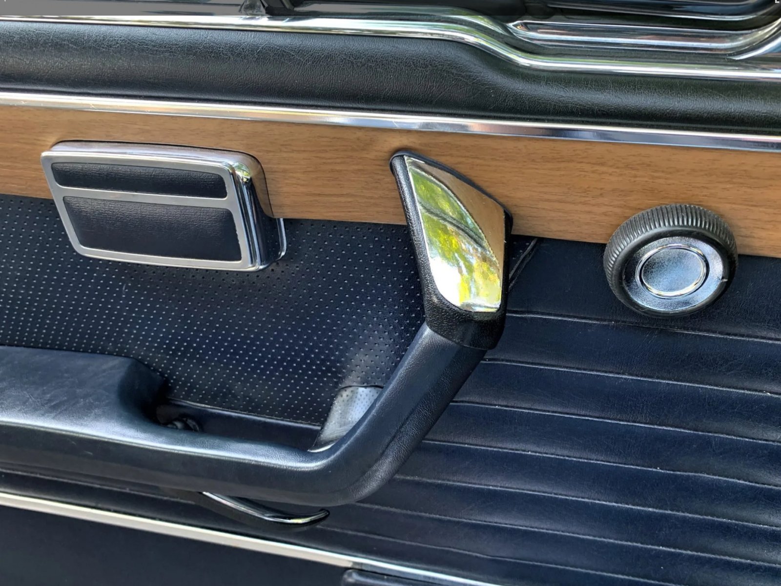

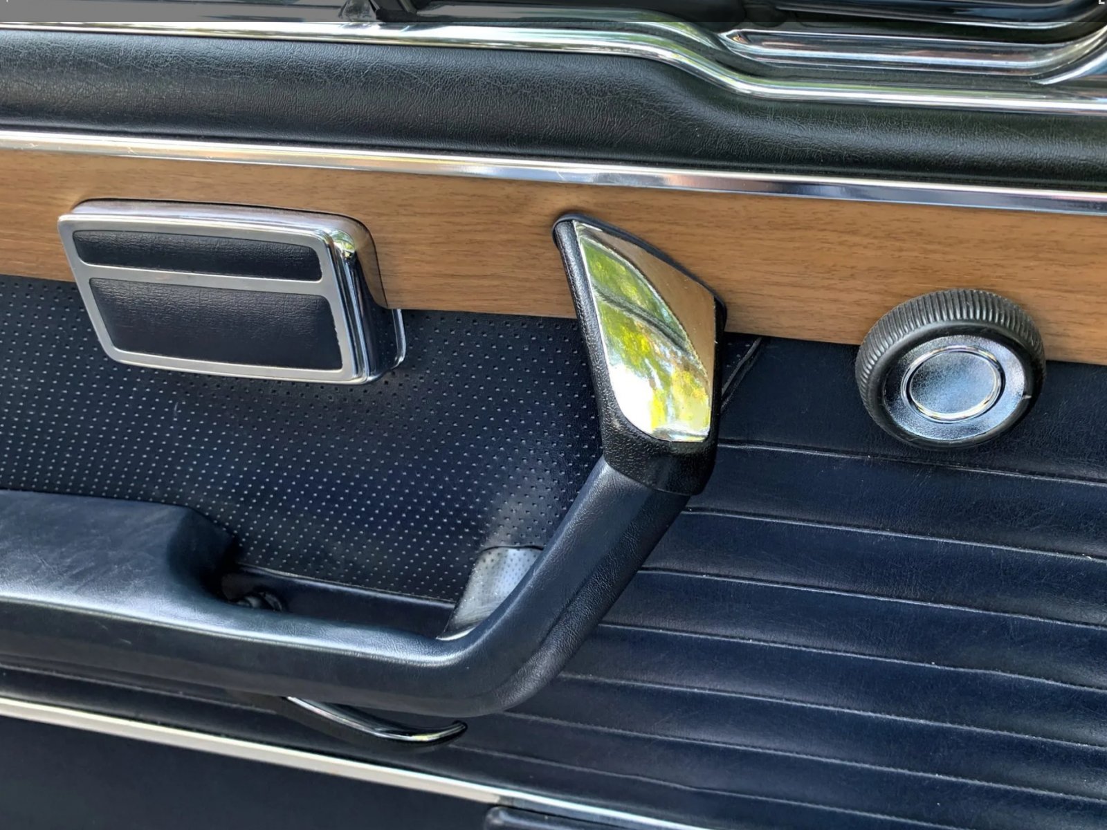

Nice result despite recalcitrant seller. I questioned the wood veneer but got no response.

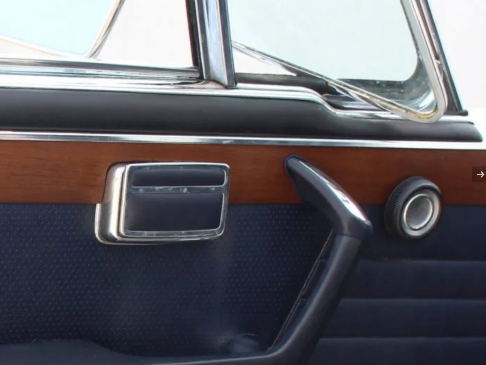

Whats wrong with this picture? (#48 in the listing)
compared to another unrestored 74 3.0csa:
"Lee" Press-On vinyl wood.
Bubbles up at the pressure points. Wood will need to be redone if you want actual wood veneer.
