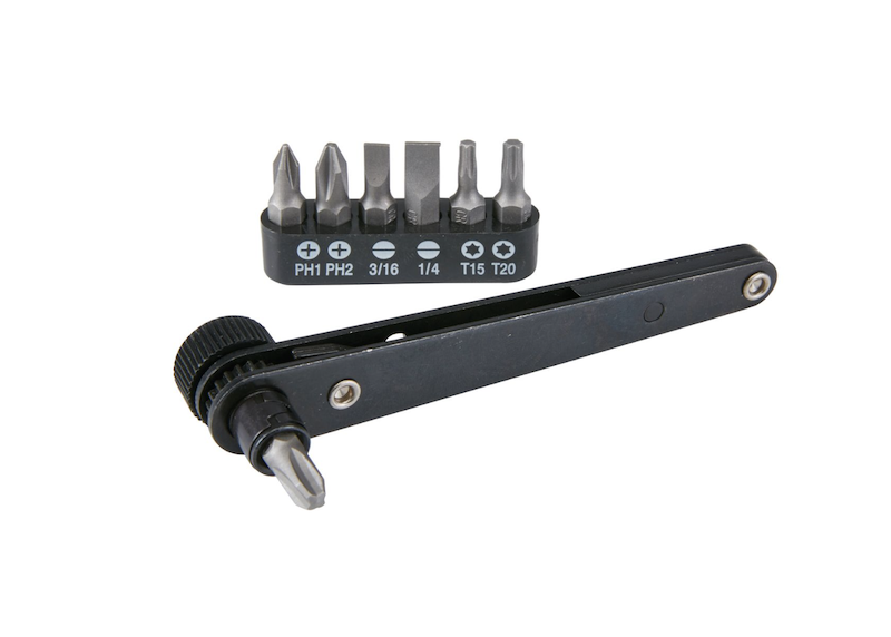

I did mine with the windshield out, but I don't think that is necessary. You'll need one of these...
