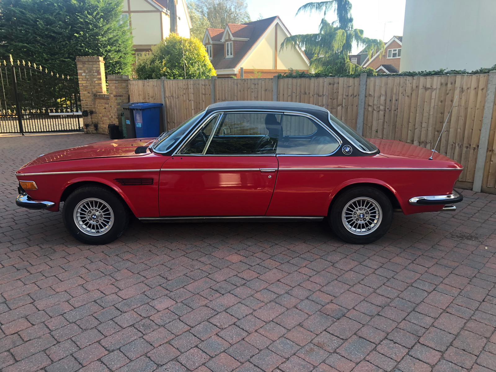

Not uncommon for UK cars to have the vinyl roof.
For cars with a relatively short run, the variations, original & after, can be overwhelming. I’m still recovering from trying to decide what oil to buy. Now ragtops are a thing?
