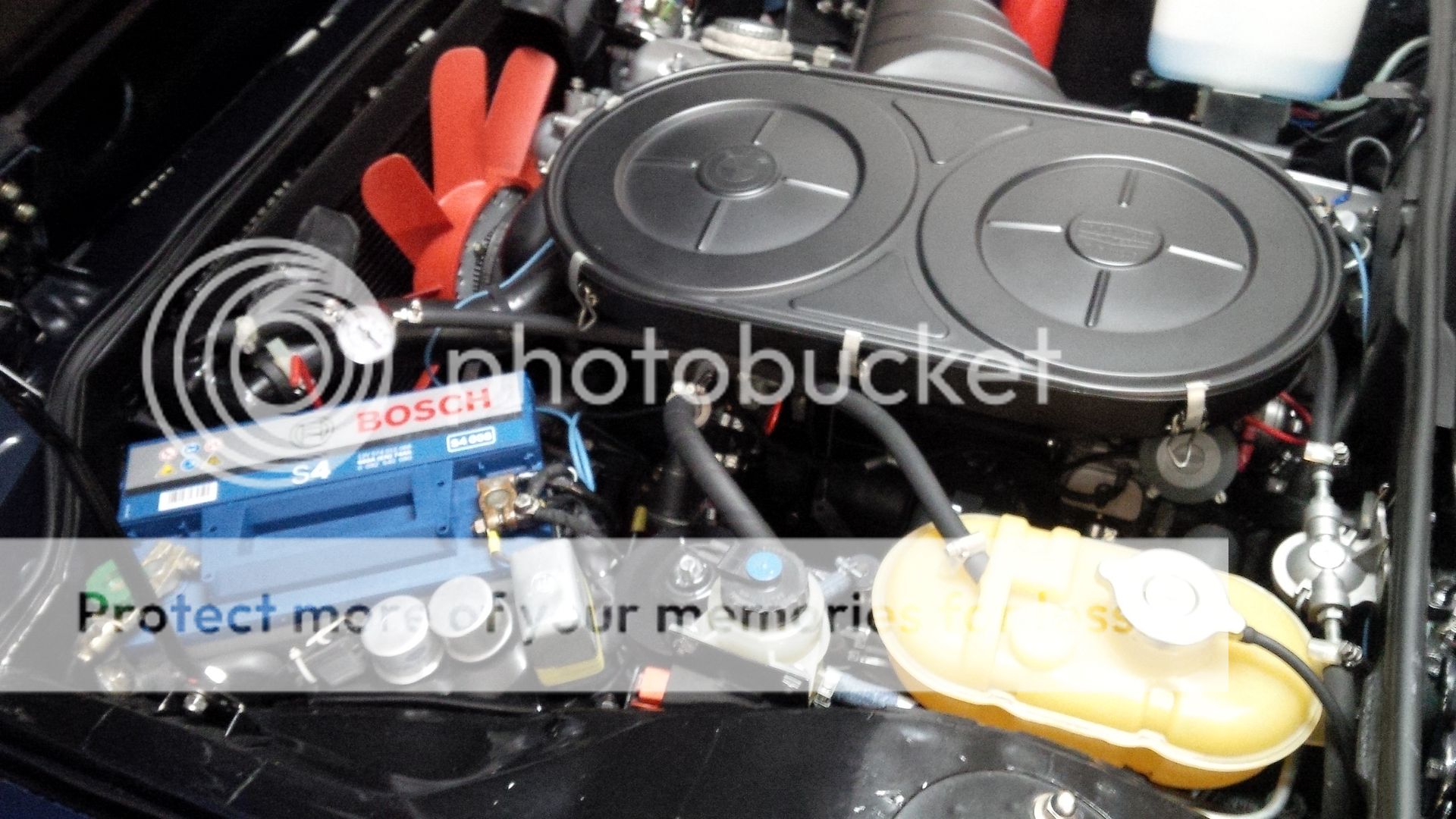

wait, wait, wait !
you remember well scott but there is a trick
i do have a S4, the most powerful possible, but it does not fit in the stock tray, to do so you must cut the plastic toe on one of the short sides
let me explain, the battery has a toe that extends the size of the battery only in the lower part, that toe is not part of the battery it is an external thing, so you can cut it
be advised and happy drving

Is the toe originally for the metal piece that clamped over the toe? The metal piece had a metal threaded rod. Or something like that. It has been a long time since I had an original battery hold down in my car.

That is a good looking battery...duly noted

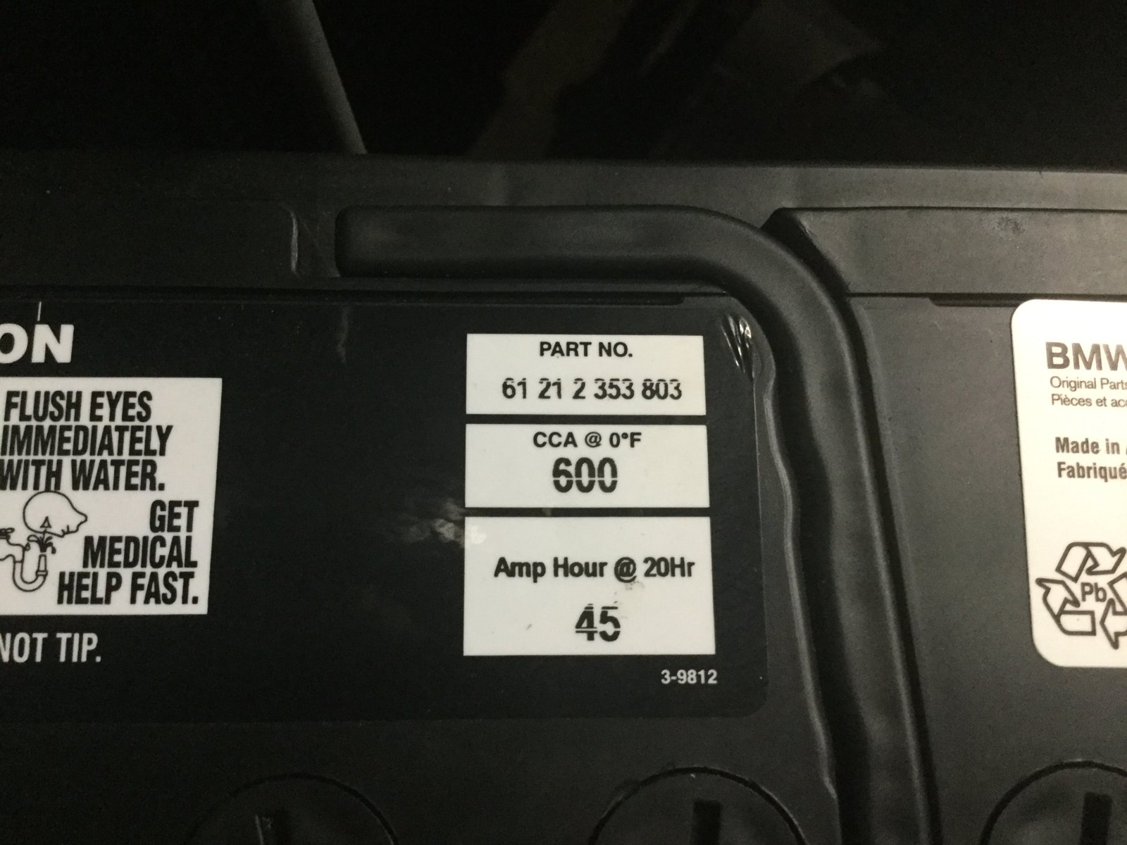

Chris- what about the 804?
From your post-
For those who want a BMW battery for appearance I found one at the dealer that fits perfectly. Part number 61-21-2-353-804, list $208, for some reason it isn't showing up in RealOEM though. Black top, white sides, 61 Ah, these are no longer made by Exide which were all white.
I know, you don't have to spend that much money, you can find an Interstate for less but it just looks right. Here it is sitting in the 2800 which uses the same battery.
