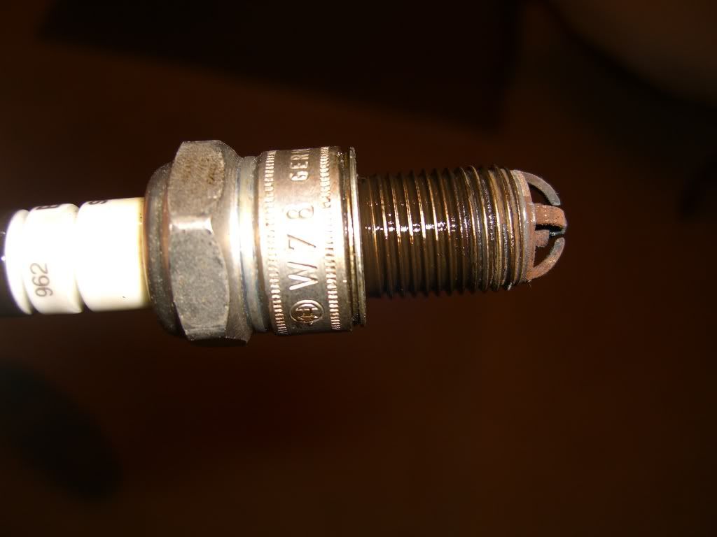

Here are the ones out of mine - they are about 8 yrs old - done about 5k miles. Last time it ran though it was a start stop job to move it. I have cleaned them once or twice in between.
Last time i removed them they were more white in colour.
They are Bosch W78 - what is that like for heat range etc?
