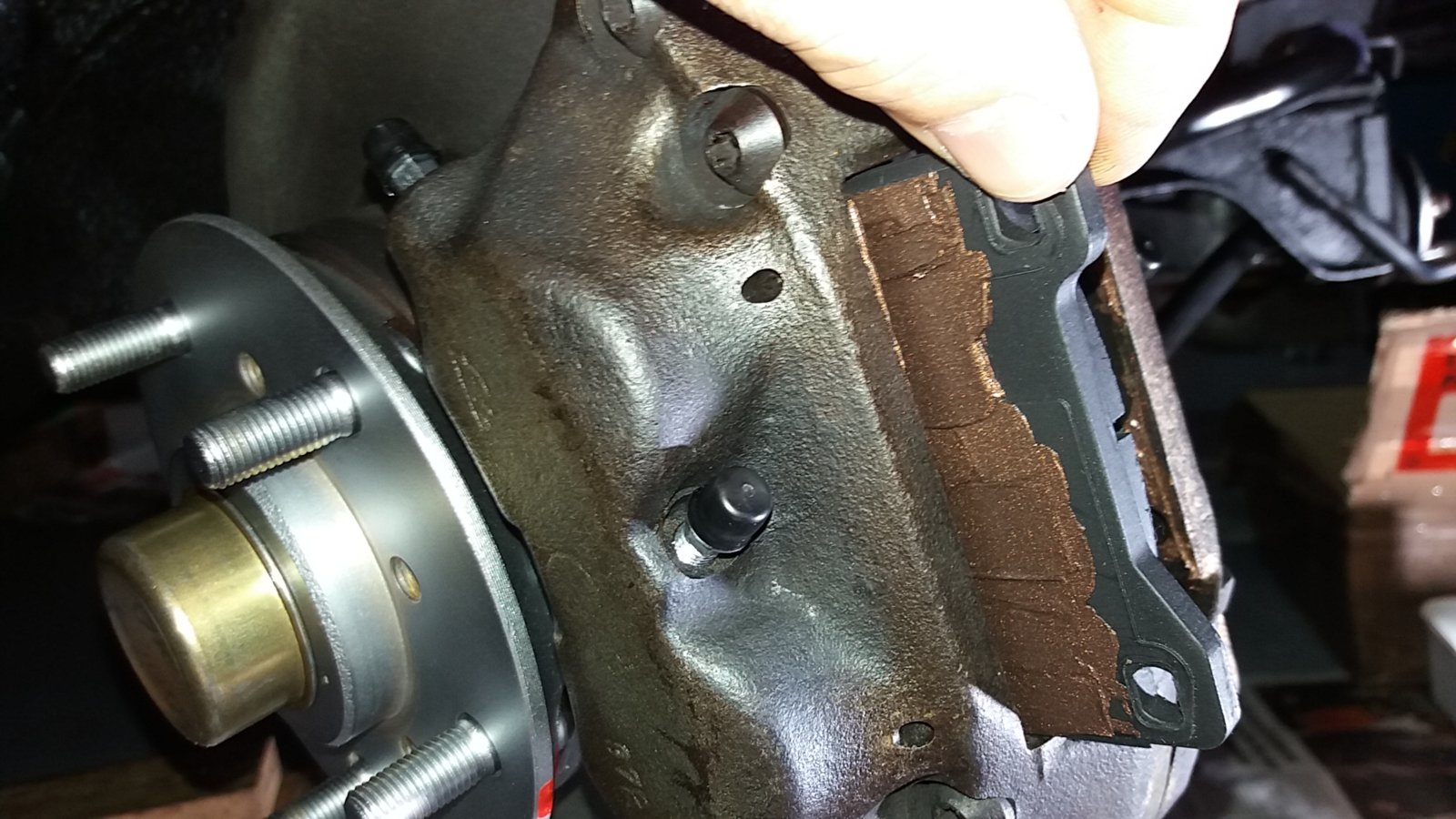

Where on the caliper or pin or pad do you apply your choice of brake lubricant? Where should there NOT be any lube or film? I have seen a build up of lubricant on the backside of pads, that turned hard and touched the exposed piston rubber parts. Looks like this would hasten their demise. Mike

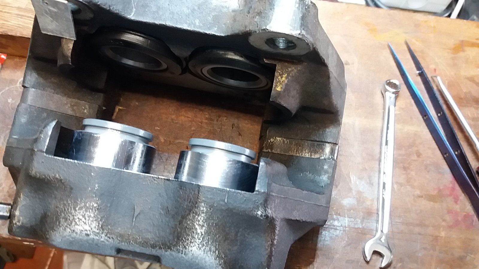

During a caliper rebuild I put smidgen (technical term) on the piston itself, and some under the rubber seal/around the edge of the piston.

bremzylinderpaste for pistons,

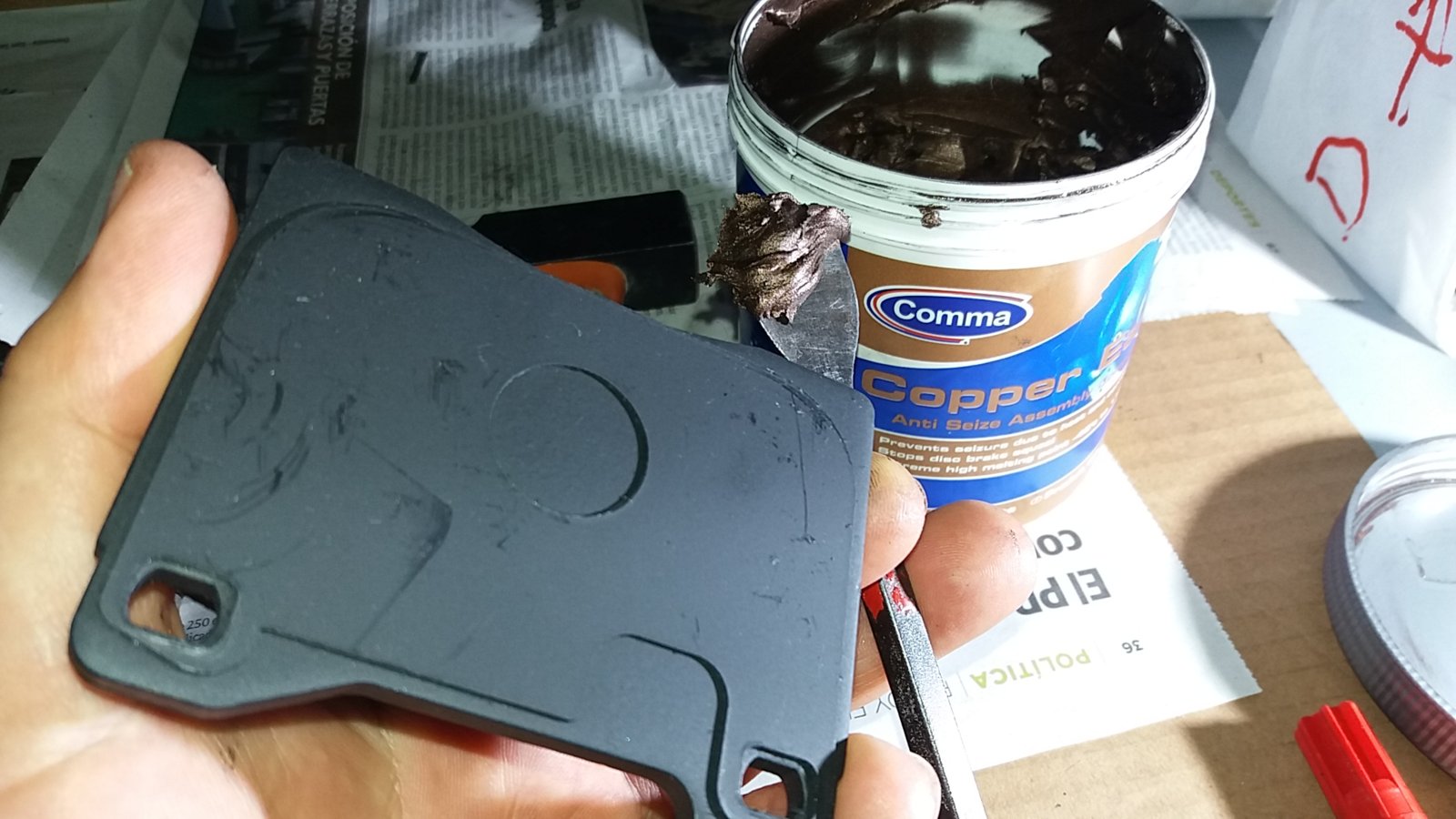

Think about this, where does the pad slide? Not only do I use hi temp copper paste on the pad backside, I also put a little on each edge of the pad as well as on the metal hold down clip ( the anti rattle clip that holds tension on the pads ) these are all places that the pad slides against. Just a little, don't get any on the pad surface. Rarely run into brake pad squeal ( this is after replacing probably over a thousand brake pads in my time ) Is this what you were asking about, not how to use lube when putting calipers together ( that is a different answer ) The copper paste does not harm the piston boots
That is helpful Rick. Yes, I was wondering about the edges too. I took my pads out yesterday and found the lube on the backside had turned to a hard paste. So I looked at when I did these last and it was 2008! Time flies ;)
