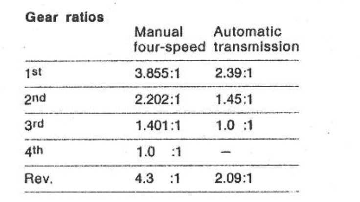

Lurching means the engine is turning over, not the clutch slipping , IMHO
Reverse is better than first:
