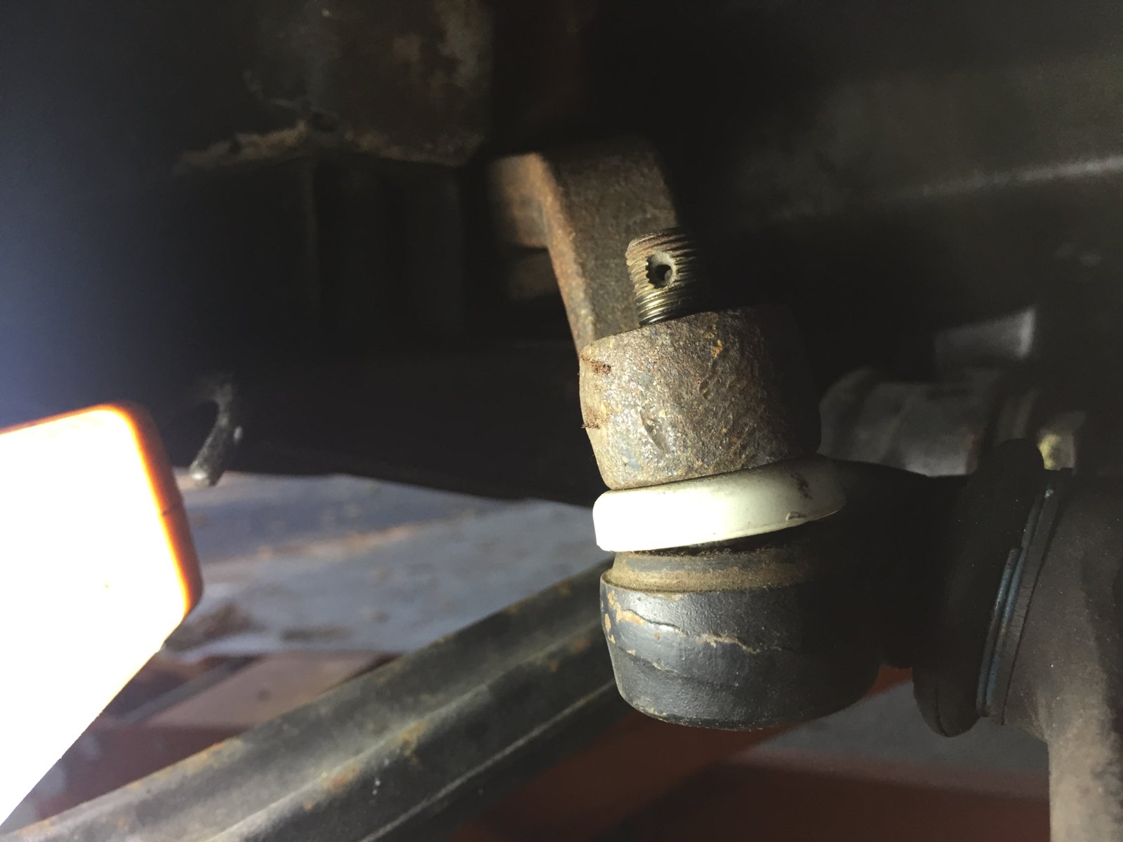

I noticed my steering was sloppy.
Upon Investigation found that the center tie rod had play at both ends where they go up into the steering arms.
Looks like the previous owner replaced a lot of the bushings but may have not been able to tie rod up into the arm far enough.
Does not look to have any missing parts per RealOEM. Also, the area where there is slop is in the tie rod itself. I was unsure even if there was a way to press them further in it would be better. As you can see here I removed the crown nut. The cotter pin was in place.
I tried to tighten the nut further in hopes to get it on further. Is there a tool for this that will allow me to ensure the tie rod is pressed in all the way. Looked for a video on via the all knowing you tube. Did not see one showing a tool for this. Just removal tool and then using the nut to press it back on.
Attempting to make sure I am heading in the correct direction. Or should the center tie rod be replaced?
This is likely not an easy part to get.
Does it look like it is not pressed all the way on?

Amazing what can be found if you just keep looking!
Picture of this part from W+N. Looking like I am missing a protective washer. That is why I thought it was somehow loose. Regardless it is worn out and needs replacement.
I just am not looking forward to the installation. I can use a tool to pot them out.
When installing the new one I just hope it goes in smoothly using the crown nut to get them back in place. Will put some anti seize on them before inst
