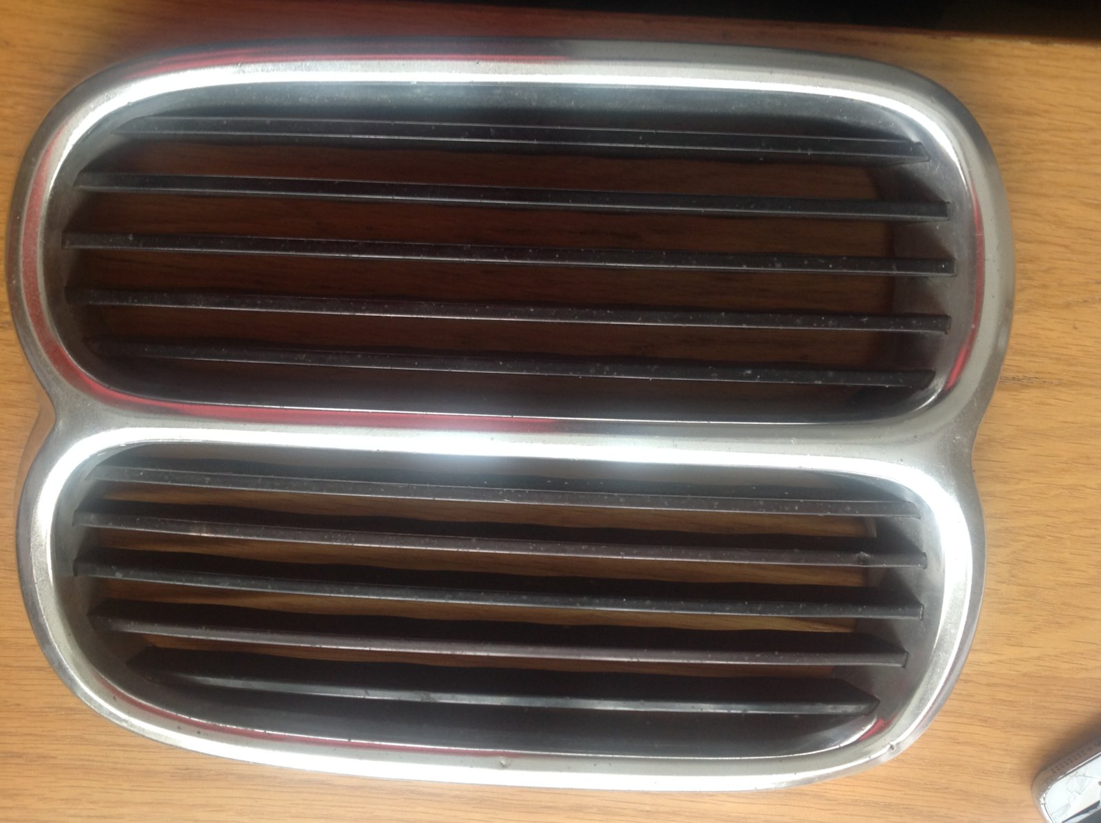

Cheers Keshav, I've attached some photos to show the general pitting on the silver and black areas, and a couple of dings I'd like to improve on. Obviously they're never going to be concours, but any tips to improve the blingyness is appreciated. They don't look to have been previously polished/ clear coated. I would estimate the finish is original

Drew, I think the only way to improve that grille is to remove the anodizing by sanding or chemically.
Then sand out the smaller pits and try to repair the small dings. Then polish and wax/ceramic coating/chroming.
The slats are removable, which makes it easier to work on the surrounding grill. But by the time you're finished with the grill, you'll want to refinish the slats as well (black anodized) :D

Cheers Gransin, I'll look into this next week, hopefully I can find a local anodiser shop who camps take this on

I am nearly finished de-anodizing and polishing my windshield trim. It looked terrible, now it is nearly as shiny as the chrome rain gutter beside it, and the front quarter window trim. IF interested, I'll forward you a write-up on what I did, along with pictures of the process. Send me your direct email via a 'Conversation' please and I'll respond within a few days when I have the write-up finished. Progressively, I used oven cleaner, 600, 800, 1500, 2000 grit wet sandpaper then Killer Chrome Polish.
