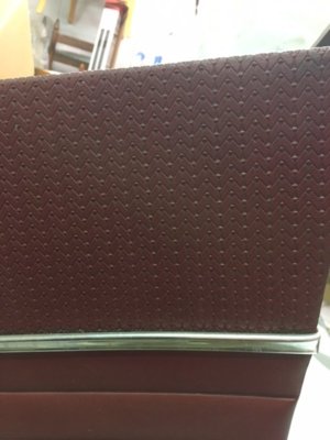

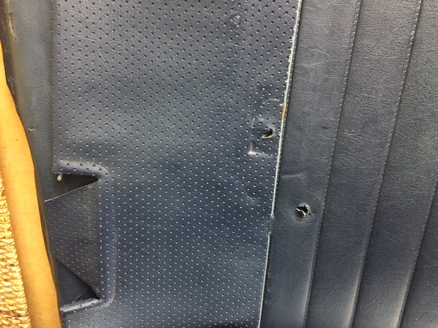

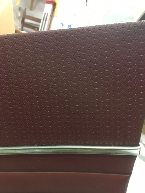

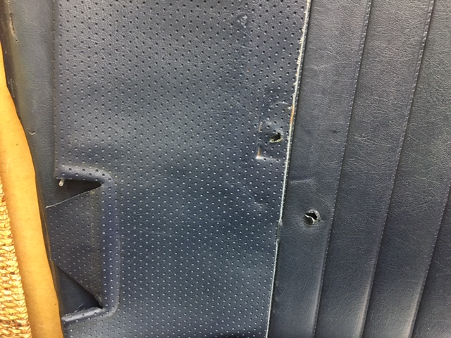

If it matters, and you want "year correct" texture, the earlier cars had what I'd call a herringbone pattern, the later cars had what I'd call a "perf" (perforations) pattern. Others can chime in on what the year change is; I can't remember...up to 72 for one, 73-75 for the other? What year is your car, Dana?
I do remember a wonderfully serious member here (cant remember his name) who made a metal embossing plate to make his own herringbone; it was beautiful. Best/easiest bet is to buy "door" skins, front and back and repro panels, but I appreciate your ambition....Dick is right that World has repro panels...Below are the two we had available in the early/late...

What interior bits are we talking about? The non perforated part in Dave's second photo can be bought at World, the perforated part in the second photo can be bought at SMS (headliner stuff). The SMS stuff has slightly smaller perforations and is slightly thicker than OEM which makes the headliner replacement a bit more challenging.

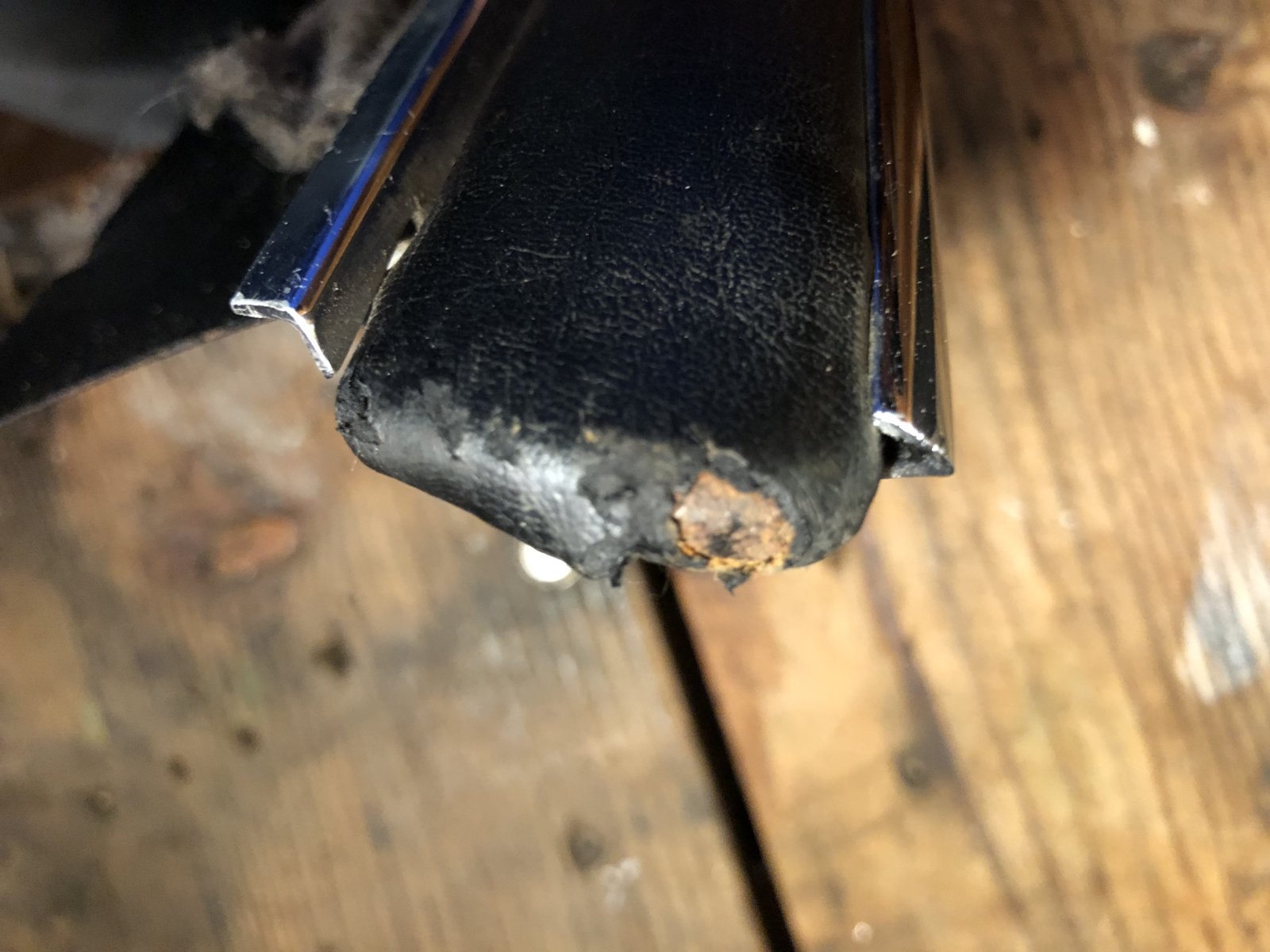

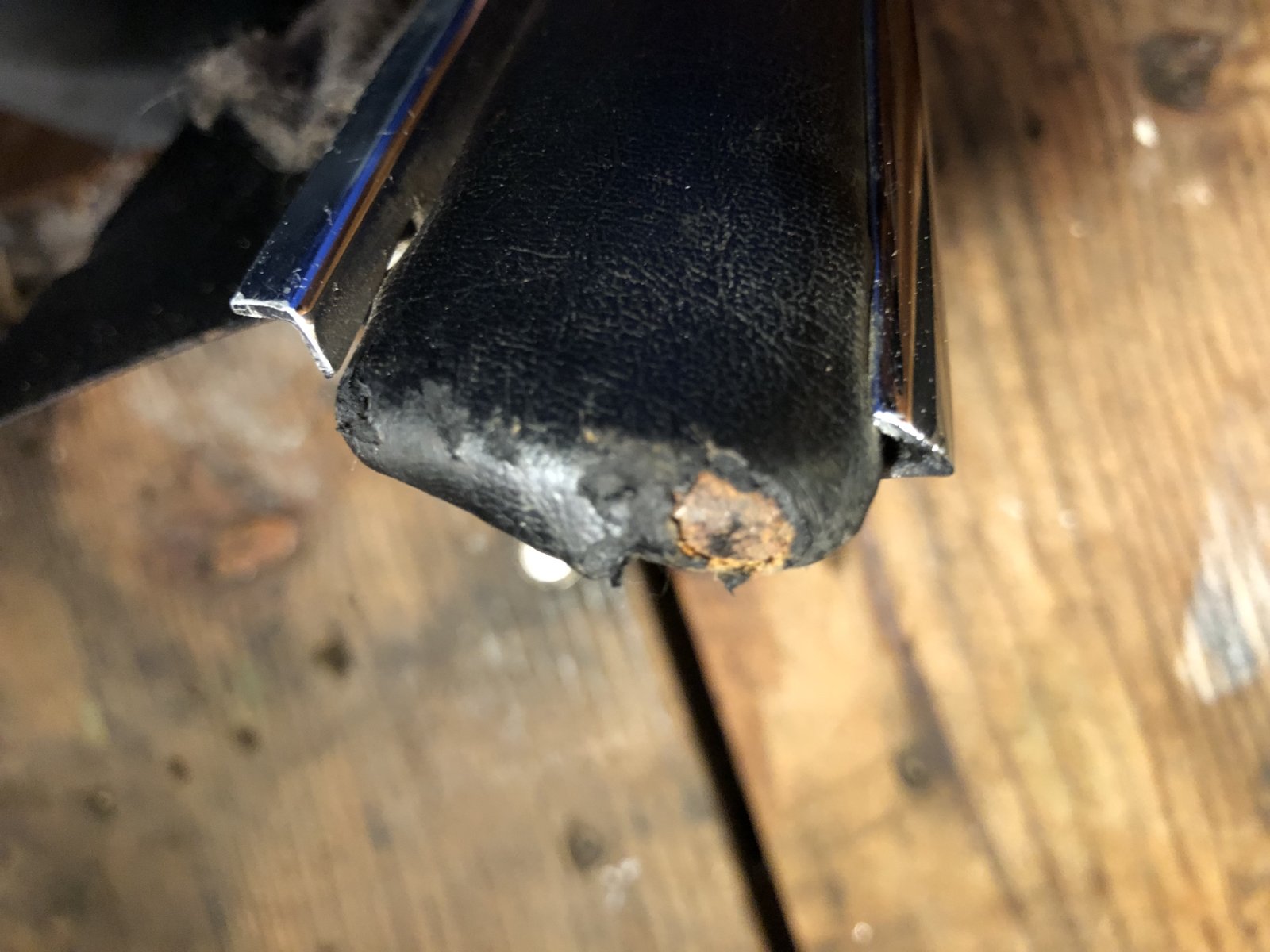

E9 board, here is the piece I am trying to repair. Completely re upholstering is not an option ( too many rivets to remove etc). There is a piece of the vinyl missing and I may try to glue (Contact Cement) on a pice of the vinyl that I have to this spot. The rest is abraded vinyl with the sub textured layer painted with a magic marker
