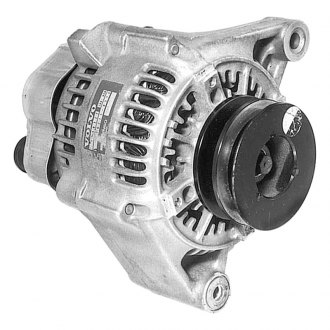

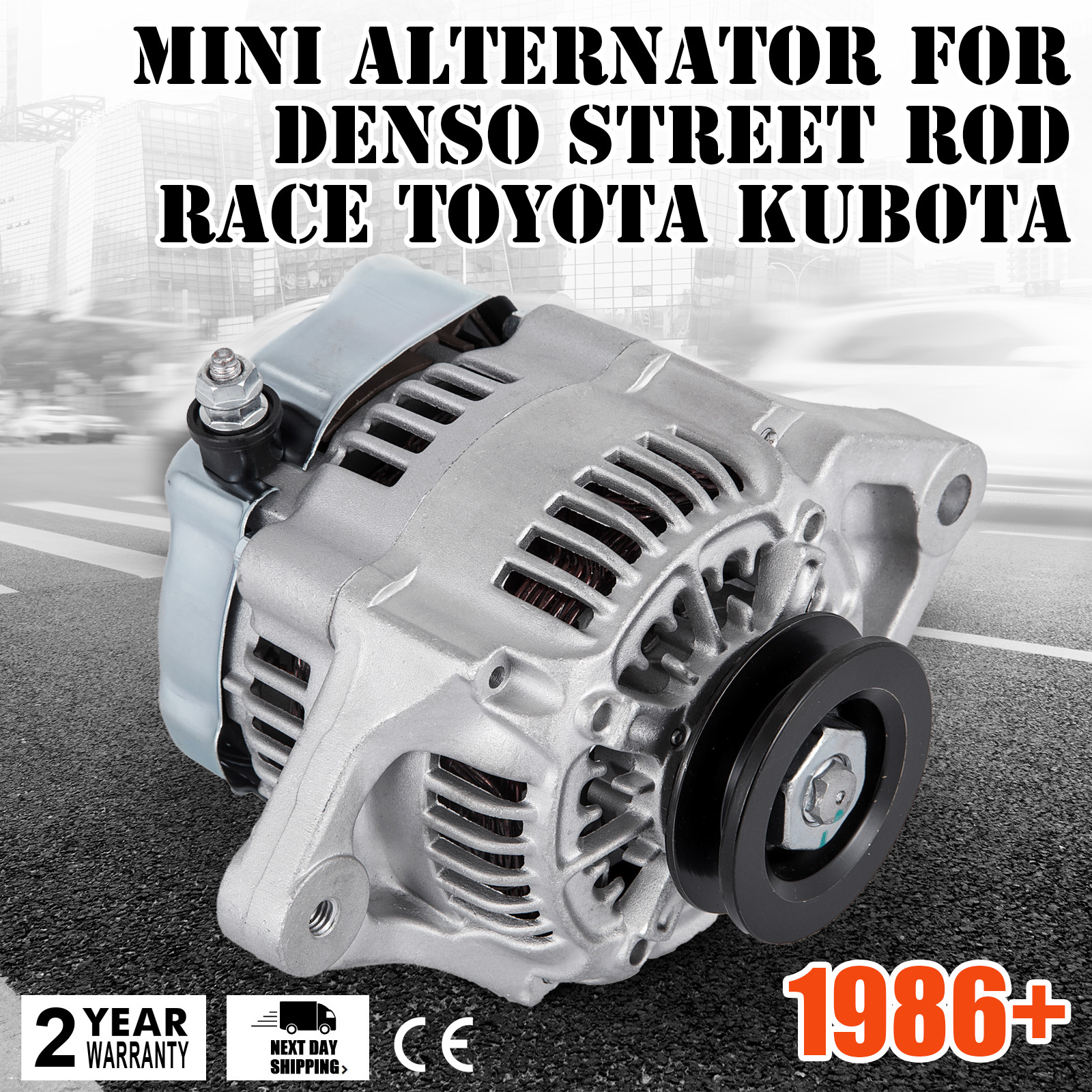

Throwing a curve ball, have you explored the availability of any bolt in Denso alternators? I recall seeing one or two examples used with M10/M30 engines in the distant past, but can't recall the specifics as to what model vehicle they were originally fitted to and/or whether some fabrication was involved. The primary advantage over your suggestion is less weight and size. Hot rodders have been using them for similar reasons. Disadvantages: reduced amperage, possible need to fabricate brackets, finding appropriate drive belt. Originality, well not so much.
My recollections are not as sharp as they may have once been. I suspect that the smaller substitute alternator may look something like the below images. These pictured do not seem to be the elegant drop in alternative as you have found with the Autolite, but maybe there is one out there that is not a pipe dream.;)
Just examples, not endorsements.> https://www.ebay.com/itm/NEW-ALTERNATOR-FITS-VOLVO-PENTA-4-3-5-0-5-7-INBOARD-STERNDRIVE-2000-2007-3862612/163276639642?_trkparms=aid=444000&algo=SOI.DEFAULT&ao=1&asc=20170221122447&meid=fff9d200a58a431c82081bab2716df08&pid=100752&rk=4&rkt=6&sd=163192875717&itm=163276639642&_trksid=p2047675.c100752.m1982

I was merely pondering the subject and not offering any specifics other than what is in the ads themselves. Transplants have obviously been performed to a variety of recipient power plants. I have no information about success or any required efforts.
I have seen 1 wire and 3 wires. "Advertised" amperage outputs vary from 35A to 90A, and even higher. Whether this is suitable for a street vehicle that deals with traffic and air conditioning, unknown. Some of the Denso housings look like they "might" fit the typical M30 brackets, which is why I posted numerous examples. Still, it is hard to determine the fit from pictures alone. Some of the advertised units are for industrial or marine applications, but that would not necessarily mean they should be eliminated from possible consideration. (Some E3s and E9s look like they are no strangers to harsh conditions.) Blogs may cover this topic in general, but a cursory search did not reveal any specifics regarding a retrofit to an early '70s M30 engine. The transplant has likely been performed on other European vehicles produced in the late '70s early '80s, but again, I have no specific information, hence my post. (I have not experienced any out-of-the ordinary problems with the Bosch alternators, and have no specific need for an alternative, but was thinking "outside of the box".)

I went with the CS-130 for a few reasons. They're 105 amps, $25 at the local boneyard and it's easy to find a car with a fairly new one. The 120° spread of the mounting points is very similar to the Bosch and you can use the stock adjusting bar. If it quits on me on the road I can readily find another one. They bolt right in with no modifications. The Denso alternators you picture have 180° mounting points and would require a bit of engineering to make them work.
