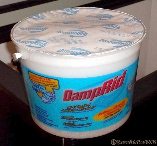

I keep a dehumidifier in my car. It costs $10 and uses nuclear fusion or some other type of independent power source.

Cat litter (silica sand) is cheap and works well inside the car. Put it in a bowl or sock.
